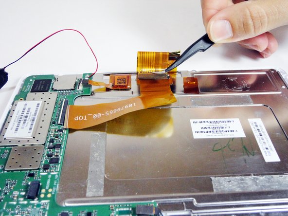

  8. HP 7 1800 Front Facing Camera Replacement, Remove the ribbon cable attached to the metal plate: crwdns2935265:08crwdnd2935265:01crwdnd2935265:02crwdne2935265:0 HP 7 1800 Front Facing Camera Replacement, Remove the ribbon cable attached to the metal plate: crwdns2935265:08crwdnd2935265:02crwdnd2935265:02crwdne2935265:0
    • On the metal plate inside of the device, there is a ribbon cable in a loop. Flip the white tab and pull the cable out.
