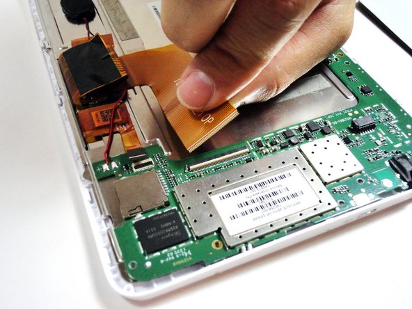

    1. HP 7 1800 Display Replacement, Remove the large ribbon cable: crwdns2935265:03crwdnd2935265:01crwdnd2935265:02crwdne2935265:0 HP 7 1800 Display Replacement, Remove the large ribbon cable: crwdns2935265:03crwdnd2935265:02crwdnd2935265:02crwdne2935265:0
      • Remove the larger ribbon cable by gently flipping the beige latch and pulling it out with tweezers.
    2. HP 7 1800 Display Replacement, Remove the smaller ribbon cable: crwdns2935265:04crwdnd2935265:01crwdnd2935265:02crwdne2935265:0 HP 7 1800 Display Replacement, Remove the smaller ribbon cable: crwdns2935265:04crwdnd2935265:02crwdnd2935265:02crwdne2935265:0
      • Remove the smaller ribbon cable by gently flipping the black latch and pulling it out with tweezers.

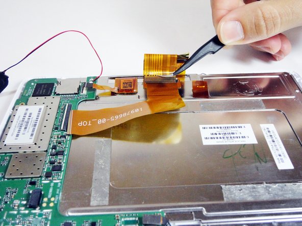

    1. HP 7 1800 Display Replacement, Remove the ribbon cable attached to the metal plate: crwdns2935265:08crwdnd2935265:01crwdnd2935265:02crwdne2935265:0 HP 7 1800 Display Replacement, Remove the ribbon cable attached to the metal plate: crwdns2935265:08crwdnd2935265:02crwdnd2935265:02crwdne2935265:0
      • On the metal plate inside of the device, there is a ribbon cable in a loop. Flip the white tab and pull the cable out.
