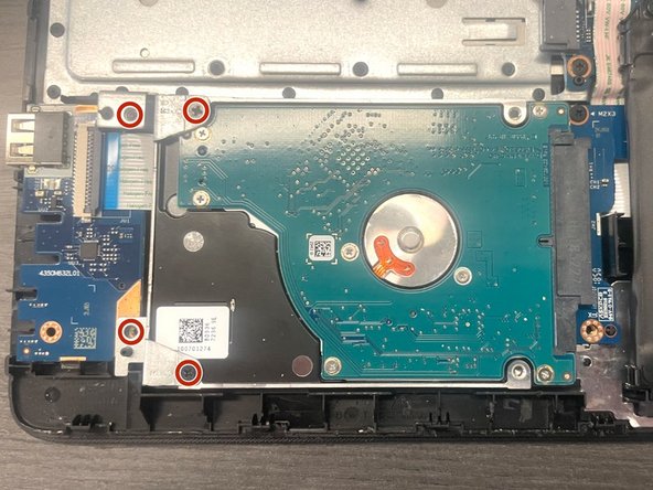

  4. HP 255 G8 Hard Drive Replacement: crwdns2935265:04crwdnd2935265:01crwdnd2935265:02crwdne2935265:0 HP 255 G8 Hard Drive Replacement: crwdns2935265:04crwdnd2935265:02crwdnd2935265:02crwdne2935265:0
    • Carefully lift the back panel off of the laptop.
    • Use a Phillips #00 screwdriver to remove four screws securing the hard drive.

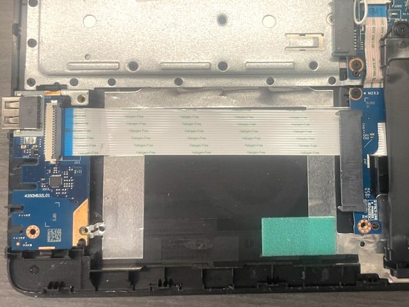

  5. HP 255 G8 Hard Drive Replacement: crwdns2935265:05crwdnd2935265:01crwdnd2935265:01crwdne2935265:0
    • Carefully lift and remove the hard drive bracket.

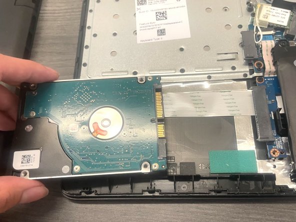

  6. HP 255 G8 Hard Drive Replacement: crwdns2935265:06crwdnd2935265:01crwdnd2935265:03crwdne2935265:0 HP 255 G8 Hard Drive Replacement: crwdns2935265:06crwdnd2935265:02crwdnd2935265:03crwdne2935265:0 HP 255 G8 Hard Drive Replacement: crwdns2935265:06crwdnd2935265:03crwdnd2935265:03crwdne2935265:0
    • Lift the hard drive and hold it at a 30-degree angle.
    • Detach the hard drive from the connector by sliding the hard drive to the left.
