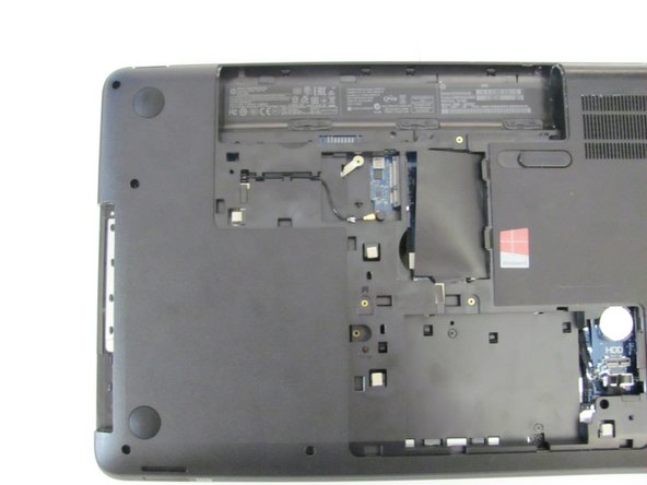

    • Flip the device over and locate the battery compartment.
    • Slide the battery release latch to the left until the battery is detached from its slot.
    • A distinguishable pop will be heard when the battery is fully released.
  2. HP 2000 - 2D22DX Optical Drive Replacement: crwdns2935265:02crwdnd2935265:01crwdnd2935265:02crwdne2935265:0 HP 2000 - 2D22DX Optical Drive Replacement: crwdns2935265:02crwdnd2935265:02crwdnd2935265:02crwdne2935265:0
    • Slowly pull the battery out of its slot, being careful not to damage any of the connectors in the process.

  4. HP 2000 - 2D22DX Optical Drive Replacement: crwdns2935265:04crwdnd2935265:01crwdnd2935265:02crwdne2935265:0 HP 2000 - 2D22DX Optical Drive Replacement: crwdns2935265:04crwdnd2935265:02crwdnd2935265:02crwdne2935265:0
    • Once the screw is sufficiently loosened, slowly unclip the RAM compartment cover from its slots in the plastic chassis.
    • When unclipped completely, pull the compartment door out and away from the chassis.
  5. HP 2000 - 2D22DX Optical Drive Replacement: crwdns2935265:05crwdnd2935265:01crwdnd2935265:03crwdne2935265:0 HP 2000 - 2D22DX Optical Drive Replacement: crwdns2935265:05crwdnd2935265:02crwdnd2935265:03crwdne2935265:0 HP 2000 - 2D22DX Optical Drive Replacement: crwdns2935265:05crwdnd2935265:03crwdnd2935265:03crwdne2935265:0

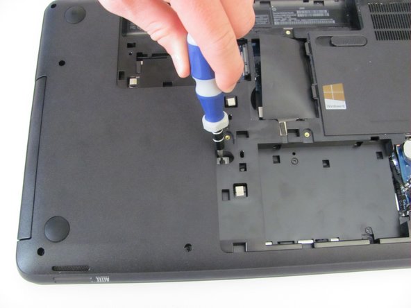

  8. HP 2000 - 2D22DX Optical Drive Replacement, Optical Drive: crwdns2935265:08crwdnd2935265:01crwdnd2935265:02crwdne2935265:0 HP 2000 - 2D22DX Optical Drive Replacement, Optical Drive: crwdns2935265:08crwdnd2935265:02crwdnd2935265:02crwdne2935265:0
    • Locate the Phillips-head screw on the left side of the hard drive recess, indicated by a red circle.
    • Use a #00 Phillips head screwdriver to remove the small screw. Consider using a magnetized screwdriver.

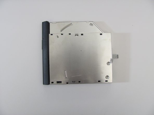

  9. HP 2000 - 2D22DX Optical Drive Replacement: crwdns2935265:09crwdnd2935265:01crwdnd2935265:03crwdne2935265:0 HP 2000 - 2D22DX Optical Drive Replacement: crwdns2935265:09crwdnd2935265:02crwdnd2935265:03crwdne2935265:0 HP 2000 - 2D22DX Optical Drive Replacement: crwdns2935265:09crwdnd2935265:03crwdnd2935265:03crwdne2935265:0
    • Once the securing screw is removed, the optical drive can be pulled from its slot easily.
    • Use your fingers to pull the optical drive away slowly from its position in the plastic chassis.
    • The optical drive should slide out very easily. If you fell resistance, do not pull too hard. Something may be caught, and you might damage the optical drive's connections.
