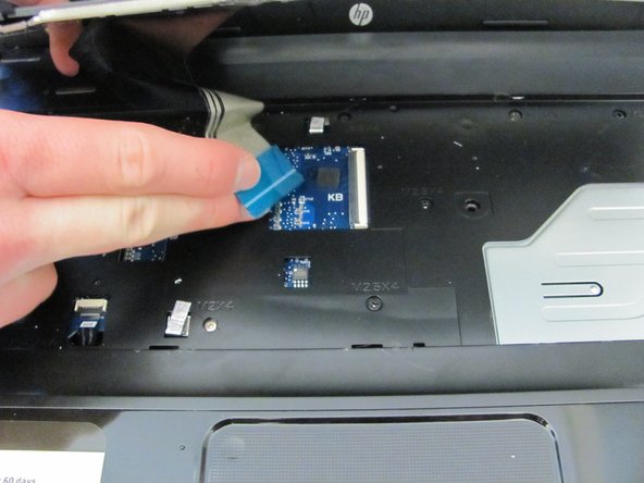

    3. HP 2000 - 2D22DX Keyboard Assembly Replacement: crwdns2935265:010crwdnd2935265:01crwdnd2935265:03crwdne2935265:0 HP 2000 - 2D22DX Keyboard Assembly Replacement: crwdns2935265:010crwdnd2935265:02crwdnd2935265:03crwdne2935265:0 HP 2000 - 2D22DX Keyboard Assembly Replacement: crwdns2935265:010crwdnd2935265:03crwdnd2935265:03crwdne2935265:0
      • Do not try to remove the keyboard immediately. It is still connected to the motherboard by a ribbon cable that can be easily damaged.
      • Once the keyboard is unscrewed, the ribbon cable below will also need to be disconnected.
      • Lift up the "flap" securing the ribbon cable to their slot on logic board and slowly pull the cables away from their connections.
      • Lift the keyboard assembly up and away from the plastic chassis.

Step 5, 6, and 7 are completely unnecessary. You do not need to remove all those screws to replace the keyboard. You only need to remove the Hard Drive panel bolt in step 3, and the bolt in step 8 that has a keyboard logo next to it. You can confirm that this is the only bolt necessary to remove by viewing the underneath of the keyboard in step 10.
Keil Miller - crwdns2934203:0crwdne2934203:0 crwdns2950251:0crwdne2950251:0
Agree with Keil, steps 5-7 are unnecessary, but an interesting experience. 63-year old grandma successfully replaced the keyboard so granddaughter can have a computer. Thanks for the great instructions!
