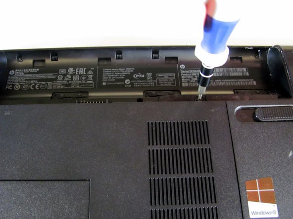

    1. HP 2000 - 2D22DX Hard Drive Replacement, Hard Drive: crwdns2935265:03crwdnd2935265:01crwdnd2935265:02crwdne2935265:0 HP 2000 - 2D22DX Hard Drive Replacement, Hard Drive: crwdns2935265:03crwdnd2935265:02crwdnd2935265:02crwdne2935265:0
      • Loosen the Phillips #00 screw securing the RAM compartment cover.
      • The screw is permanently attached to the RAM compartment cover. Do not try to remove it completely.
