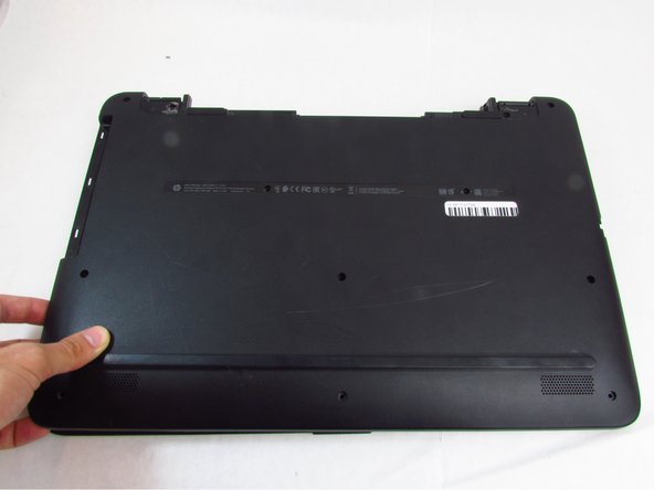

    • Using the Phillips #0 screwdriver, remove fourteen 7 mm screws on the back of the device (two will be underneath where the battery was).
  5. HP 17-x173dx RAM Replacement: crwdns2935265:05crwdnd2935265:01crwdnd2935265:03crwdne2935265:0 HP 17-x173dx RAM Replacement: crwdns2935265:05crwdnd2935265:02crwdnd2935265:03crwdne2935265:0 HP 17-x173dx RAM Replacement: crwdns2935265:05crwdnd2935265:03crwdnd2935265:03crwdne2935265:0
    • Remove the Optical Disk Drive.

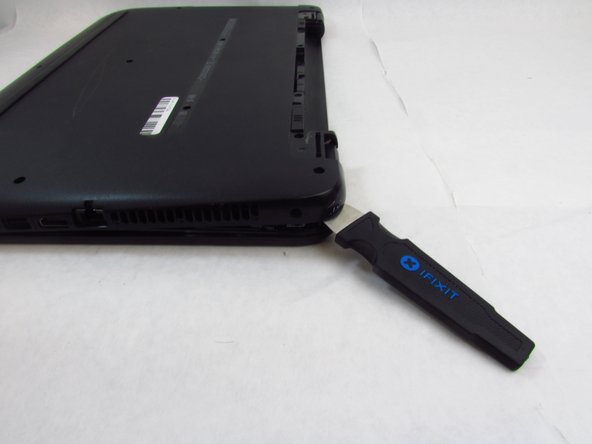

    • Use the spudger to lift the plastic backing, starting from the back right side, near the vent.
    • Remove the back of the device by continuing to lift the plastic around the entire perimeter of the device.

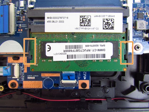

    • Use a pair of tweezers or your fingernails to carefully pry the two metal retention clips out and away from the ram casing.
    • Then gently bend the plastic retainers away to free the ram stick.

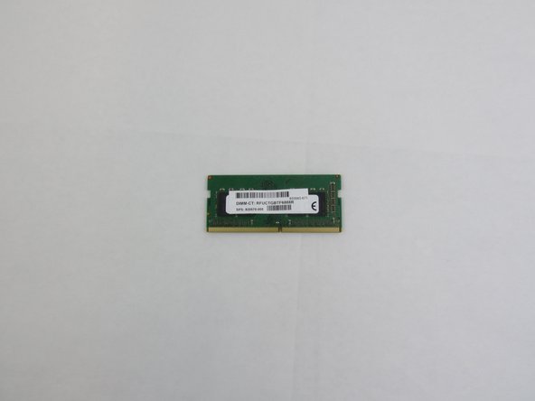

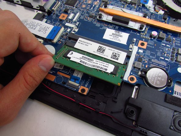

  7. HP 17-x173dx RAM Replacement: crwdns2935265:07crwdnd2935265:01crwdnd2935265:02crwdne2935265:0 HP 17-x173dx RAM Replacement: crwdns2935265:07crwdnd2935265:02crwdnd2935265:02crwdne2935265:0
    • Lift the RAM stick away from the motherboard and remove it from the device.
    • Repeat this step for any extra sticks of RAM.
