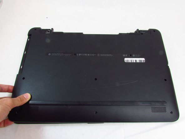

    • Using the Phillips #0 screwdriver, remove fourteen 7 mm screws on the back of the device (two will be underneath where the battery was).
  5. HP 17-x173dx Motherboard Replacement: crwdns2935265:05crwdnd2935265:01crwdnd2935265:03crwdne2935265:0 HP 17-x173dx Motherboard Replacement: crwdns2935265:05crwdnd2935265:02crwdnd2935265:03crwdne2935265:0 HP 17-x173dx Motherboard Replacement: crwdns2935265:05crwdnd2935265:03crwdnd2935265:03crwdne2935265:0
    • Remove the optical disk drive.

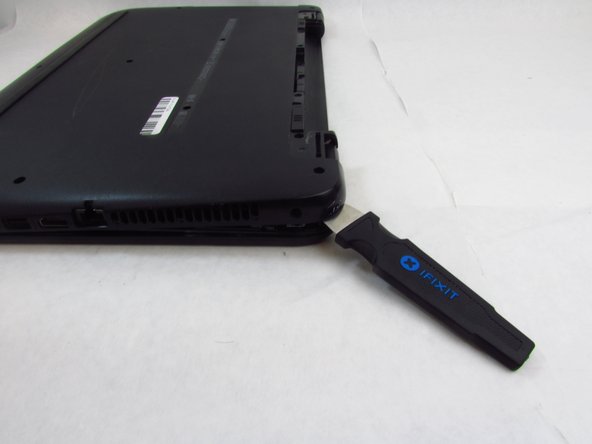

    • Use the spudger to lift the plastic backing, starting from the back right side, near the vents.
    • Remove the back of the device by continuing to lift the plastic around the entire perimeter of the device.

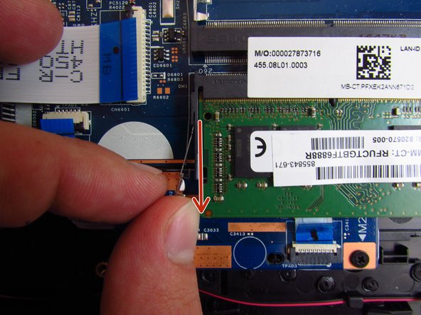

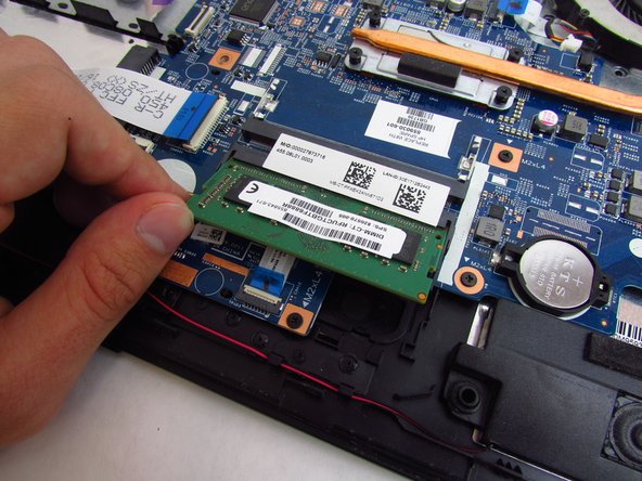

    • Use a pair of tweezers or your nails to carefully pry the metal retention clips out and away from the RAM casing.
    • Gently bend the plastic retainers away to free the RAM stick and remove it from the device.

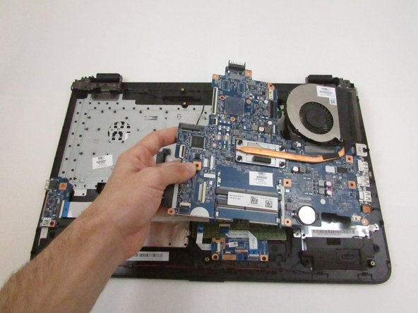

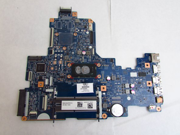

    • Remove nine 4 mm motherboard screws using the Phillips #0 screwdriver.
    • Lift the motherboard and heatsink with fan out of the laptop case.
  10. HP 17-x173dx Motherboard Replacement: crwdns2935265:011crwdnd2935265:01crwdnd2935265:03crwdne2935265:0 HP 17-x173dx Motherboard Replacement: crwdns2935265:011crwdnd2935265:02crwdnd2935265:03crwdne2935265:0 HP 17-x173dx Motherboard Replacement: crwdns2935265:011crwdnd2935265:03crwdnd2935265:03crwdne2935265:0

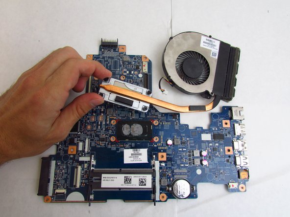

    • Unscrew four heat sink screws using the Phillips #0 screwdriver.
    • These will unscrew, but will stay attached to the heat-sink.
    • Remove the cooling fan and heat sink from the motherboard.
    • After removing the cooling fan and heat sink, you will be left with the motherboard.
