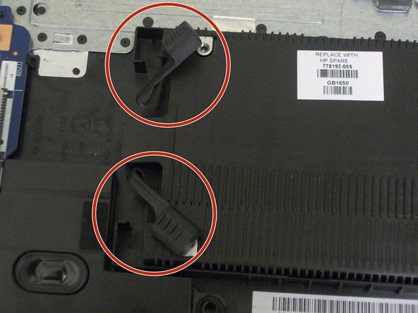

  5. HP 17-x061nr Hard Drive Replacement, Hard Drive: crwdns2935265:05crwdnd2935265:01crwdnd2935265:01crwdne2935265:0
    • Locate the hard drive.
    • Using the purple hard plastic tab gently pull the cable tape tab out of the input, located on the left-hand side.
  6. HP 17-x061nr Hard Drive Replacement: crwdns2935265:06crwdnd2935265:01crwdnd2935265:02crwdne2935265:0 HP 17-x061nr Hard Drive Replacement: crwdns2935265:06crwdnd2935265:02crwdnd2935265:02crwdne2935265:0
    • Carefully peel back the cable tape from the hard drive itself.
    • Pull the shock absorbers from the back of the hard drive casing.
  7. HP 17-x061nr Hard Drive Replacement: crwdns2935265:07crwdnd2935265:01crwdnd2935265:01crwdne2935265:0
    • Lift up the back of the hard drive module and gently pull it away from the connection point.
    • Be sure to keep the replacement within the package until you are ready to place it.
