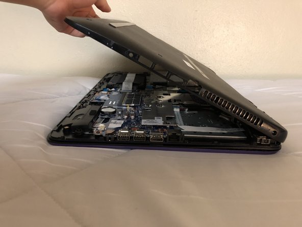

  3. HP 17-x027ds Wifi Card Replacement: crwdns2935265:03crwdnd2935265:01crwdnd2935265:02crwdne2935265:0 HP 17-x027ds Wifi Card Replacement: crwdns2935265:03crwdnd2935265:02crwdnd2935265:02crwdne2935265:0
    • Lift the bottom cover of the laptop with a metal spudger by wedging the sides first and going all around.
    • The cover is difficult to lift, so use extreme force.

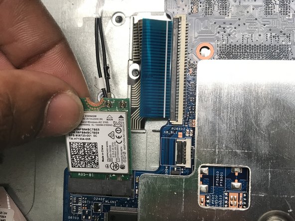

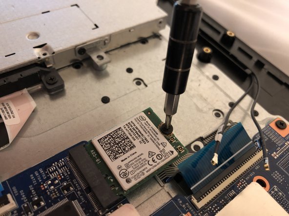

  4. HP 17-x027ds Wifi Card Replacement: crwdns2935265:04crwdnd2935265:01crwdnd2935265:03crwdne2935265:0 HP 17-x027ds Wifi Card Replacement: crwdns2935265:04crwdnd2935265:02crwdnd2935265:03crwdne2935265:0 HP 17-x027ds Wifi Card Replacement: crwdns2935265:04crwdnd2935265:03crwdnd2935265:03crwdne2935265:0
    • Carefully pull the two cables attached to the CPU.
    • They are labeled 1 and 2. When putting the cables back, make sure to put them in the correct section.
    • Remove the screw holding down the CPU with the same screwdriver tip as before.
    • Gently pull on the CPU to remove it.
