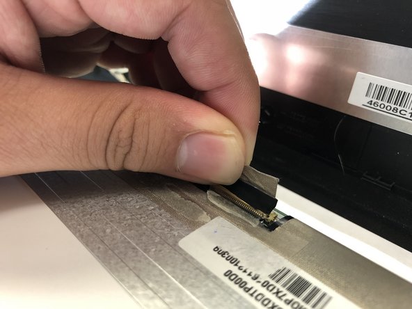

      • Open the laptop so you can see the screen.
      • Remove the bezel with firm, constant pressure to create a slight gap between the bezel and screen (plastic outlining of screen) with a plastic opening tool.
      • Remove the bezel by starting on the sides of the screen and lastly removing the top outlining.
      • When removing the bezel, be cautious not to use too much force or else you will damage the screen. Apply just enough pressure to create a gap between the bezel and screen.
    2. HP 17-x027ds LCD Screen Replacement: crwdns2935265:02crwdnd2935265:01crwdnd2935265:03crwdne2935265:0 HP 17-x027ds LCD Screen Replacement: crwdns2935265:02crwdnd2935265:02crwdnd2935265:03crwdne2935265:0 HP 17-x027ds LCD Screen Replacement: crwdns2935265:02crwdnd2935265:03crwdnd2935265:03crwdne2935265:0
      • Lift the bezel off the screen to see the outlines of the LCD screen.
      • Remove the four black 3mm screws in each corner of the screen with a JIS #1 screwdriver.
      • Remove the two silver 4mm screws located at the top of the screen with a JIS #1 screwdriver.
    3. HP 17-x027ds LCD Screen Replacement: crwdns2935265:03crwdnd2935265:01crwdnd2935265:02crwdne2935265:0 HP 17-x027ds LCD Screen Replacement: crwdns2935265:03crwdnd2935265:02crwdnd2935265:02crwdne2935265:0
      • Remove the LCD screen and place it on the keyboard.
      • Disconnect the video cable to completely detach the LCD screen.
