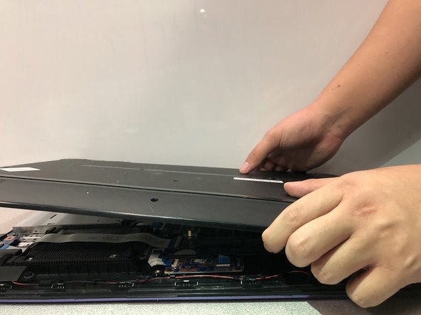

  3. HP 17-x027ds Hard Drive Replacement: crwdns2935265:03crwdnd2935265:01crwdnd2935265:02crwdne2935265:0 HP 17-x027ds Hard Drive Replacement: crwdns2935265:03crwdnd2935265:02crwdnd2935265:02crwdne2935265:0
    • Lift the bottom cover of the laptop with a metal spudger by wedging the sides first and going all around.
    • The cover is difficult to lift, so use extreme force.

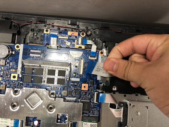

  4. HP 17-x027ds Hard Drive Replacement: crwdns2935265:04crwdnd2935265:01crwdnd2935265:03crwdne2935265:0 HP 17-x027ds Hard Drive Replacement: crwdns2935265:04crwdnd2935265:02crwdnd2935265:03crwdne2935265:0 HP 17-x027ds Hard Drive Replacement: crwdns2935265:04crwdnd2935265:03crwdnd2935265:03crwdne2935265:0
    • Disconnect the blue ends of the white ribbon cable by pulling the blue ends out of the connector.
    • The ribbon cable will still be connected to the rubber and just the ends will be disconnected.

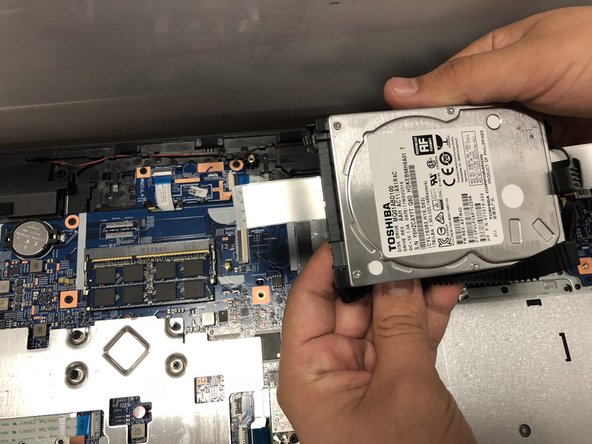

  5. HP 17-x027ds Hard Drive Replacement: crwdns2935265:05crwdnd2935265:01crwdnd2935265:02crwdne2935265:0 HP 17-x027ds Hard Drive Replacement: crwdns2935265:05crwdnd2935265:02crwdnd2935265:02crwdne2935265:0
    • Lift the black rubber cover containing the hard drive by lifting the right side of the rubber cover.
    • The white ribbon cable will still be connected to the rubber cover, so remove the hard drive out from under.
