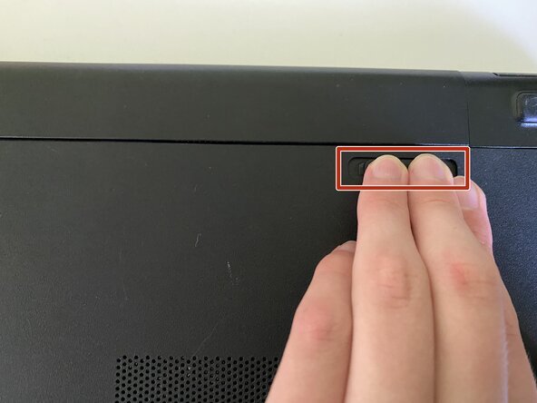

    • Put the laptop upside down and remove the battery by pulling the right latch outward.
    • Raise the battery upwards.

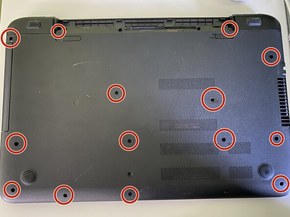

  2. HP 17-p051no Basic Disassembly, Remove screws from the base: crwdns2935265:02crwdnd2935265:01crwdnd2935265:01crwdne2935265:0
    • Remove the screws that are shown in the picture with a Phillips #0 screwdriver.
