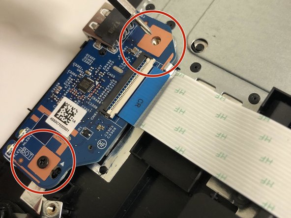

  6. HP 17-bs049dx USB Port Replacement, USB Port: crwdns2935265:06crwdnd2935265:01crwdnd2935265:02crwdne2935265:0 HP 17-bs049dx USB Port Replacement, USB Port: crwdns2935265:06crwdnd2935265:02crwdnd2935265:02crwdne2935265:0
    • Remove the two screws using a Phillips #0 screwdriver.

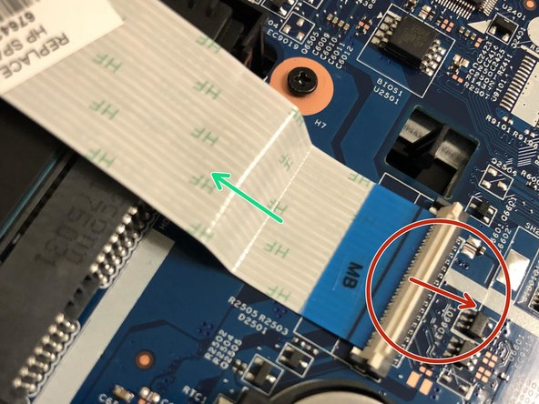

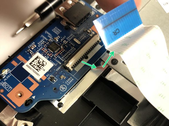

  7. HP 17-bs049dx USB Port Replacement: crwdns2935265:07crwdnd2935265:01crwdnd2935265:03crwdne2935265:0 HP 17-bs049dx USB Port Replacement: crwdns2935265:07crwdnd2935265:02crwdnd2935265:03crwdne2935265:0 HP 17-bs049dx USB Port Replacement: crwdns2935265:07crwdnd2935265:03crwdnd2935265:03crwdne2935265:0
    • At both ends of the connector ribbon, unclip both connectors.
    • Gently remove the ribbon from the unlatched area.
