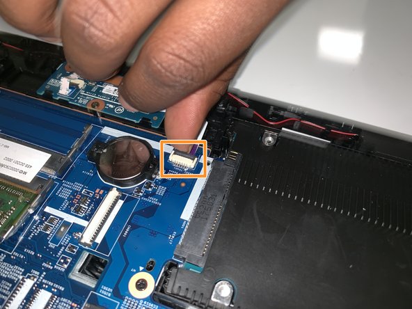

  5. HP 17-bs049dx Motherboard Replacement, Hard Drive: crwdns2935265:05crwdnd2935265:01crwdnd2935265:01crwdne2935265:0
    • Remove screw (7.51mm) on USB port with "Phillips 0 Screwdriver".
    • Lift the USB port over and away from hard drive.
  6. HP 17-bs049dx Motherboard Replacement: crwdns2935265:06crwdnd2935265:01crwdnd2935265:02crwdne2935265:0 HP 17-bs049dx Motherboard Replacement: crwdns2935265:06crwdnd2935265:02crwdnd2935265:02crwdne2935265:0
    • Lift rubber black tabs located on the hard drive upwards.
    • Disconnect hard drive from motherboard by pulling towards you.

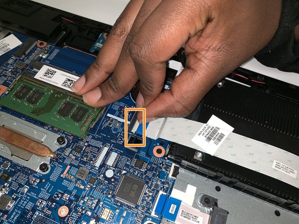

  7. HP 17-bs049dx Motherboard Replacement, Motherboard: crwdns2935265:07crwdnd2935265:01crwdnd2935265:03crwdne2935265:0 HP 17-bs049dx Motherboard Replacement, Motherboard: crwdns2935265:07crwdnd2935265:02crwdnd2935265:03crwdne2935265:0 HP 17-bs049dx Motherboard Replacement, Motherboard: crwdns2935265:07crwdnd2935265:03crwdnd2935265:03crwdne2935265:0
    • Make sure to unplug everything connected to the motherboard.
    • Be gentle with this step.
  8. HP 17-bs049dx Motherboard Replacement: crwdns2935265:08crwdnd2935265:01crwdnd2935265:01crwdne2935265:0
    • Remove the screws (7.51mm) with a Phillips #0 screwdriver.
    • Once all of the screws are removed, remove the motherboard from the device.
