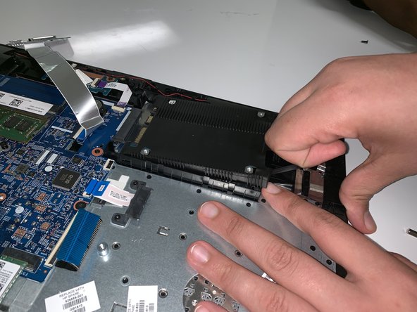

    1. HP 17-bs049dx Hard Drive  Replacement, Hard Drive: crwdns2935265:06crwdnd2935265:01crwdnd2935265:01crwdne2935265:0
      • Remove screw (7.51mm) on USB port with "Phillips 0 Screwdriver".
      • Lift the USB port over and away from hard drive.
    2. HP 17-bs049dx Hard Drive  Replacement: crwdns2935265:07crwdnd2935265:01crwdnd2935265:02crwdne2935265:0 HP 17-bs049dx Hard Drive  Replacement: crwdns2935265:07crwdnd2935265:02crwdnd2935265:02crwdne2935265:0
      • Lift rubber black tabs located on the hard drive upwards.
      • Disconnect hard drive from motherboard by pulling towards you.
