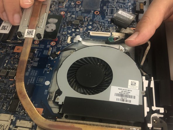

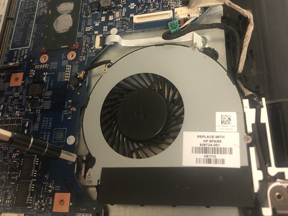

  6. HP 17-bs049dx Fan Replacement, Fan: crwdns2935265:06crwdnd2935265:01crwdnd2935265:03crwdne2935265:0 HP 17-bs049dx Fan Replacement, Fan: crwdns2935265:06crwdnd2935265:02crwdnd2935265:03crwdne2935265:0 HP 17-bs049dx Fan Replacement, Fan: crwdns2935265:06crwdnd2935265:03crwdnd2935265:03crwdne2935265:0
    • Unscrew all four screws connecting the heatsink to the motherboard.
    • The screws holding the heat sink will not detach from the heat sink.
    • All four screws must be loosened before removing the heat sink.
    • After loosening all screws remove the heat sink and store it in a safe place.
  7. HP 17-bs049dx Fan Replacement: crwdns2935265:07crwdnd2935265:01crwdnd2935265:01crwdne2935265:0
    • After removing the heat sink, disconnect the cable connecting the fan to the motherboard.
  8. HP 17-bs049dx Fan Replacement: crwdns2935265:08crwdnd2935265:01crwdnd2935265:01crwdne2935265:0
    • Remove the old fan from the device.
