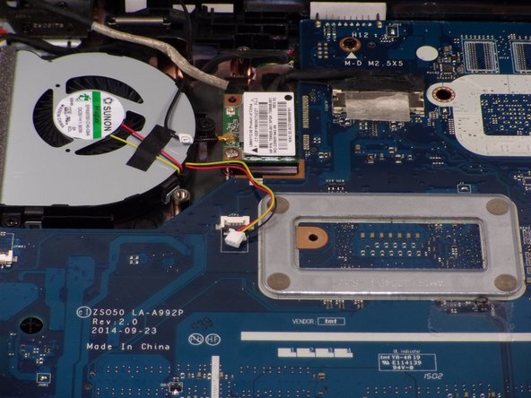

  7. HP 15-r137wm TouchSmart Cooling Fan Replacement, Cooling Fan: crwdns2935265:07crwdnd2935265:01crwdnd2935265:02crwdne2935265:0 HP 15-r137wm TouchSmart Cooling Fan Replacement, Cooling Fan: crwdns2935265:07crwdnd2935265:02crwdnd2935265:02crwdne2935265:0
    • Locate the small connection on the motherboard and disconnect it by slowly pulling it away from the motherboard.
    • Slowly disconnect the cable as the wires are very small and fragile

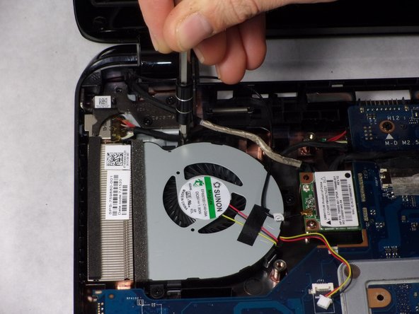

  8. HP 15-r137wm TouchSmart Cooling Fan Replacement: crwdns2935265:08crwdnd2935265:01crwdnd2935265:02crwdne2935265:0 HP 15-r137wm TouchSmart Cooling Fan Replacement: crwdns2935265:08crwdnd2935265:02crwdnd2935265:02crwdne2935265:0
    • Remove the three (3) 2.5mm by 3.5mm Phillips #0 screws from the fan.
  9. HP 15-r137wm TouchSmart Cooling Fan Replacement: crwdns2935265:09crwdnd2935265:01crwdnd2935265:01crwdne2935265:0
    • Remove the cooling fan from the housing carefully.
    • The fan may be connected to the small foam screen. Pull gently to release it.
