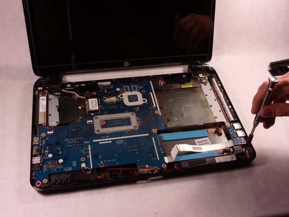

    • Make sure that the device is powered off and unplugged before removing components.
    • Remove all ten (10) 5.5 mm Phillips #0 screws.
    • Remove the two (2) plastic tabs located at the rear of the panel. Locate the two (2) 7.5mm Phillips #0 screws underneath the pads and remove.

    • Remove the four (4) 2.5mm by 3.5mm Phillips #0 screws from the metal retaining plate.
    • Lift the metal retaining plate off and away from the device.
  7. HP 15-r137wm TouchSmart Audio Speakers Replacement, Audio Speakers: crwdns2935265:07crwdnd2935265:01crwdnd2935265:02crwdne2935265:0 HP 15-r137wm TouchSmart Audio Speakers Replacement, Audio Speakers: crwdns2935265:07crwdnd2935265:02crwdnd2935265:02crwdne2935265:0
    • Remove the four (4) 2.5 mm Phillips #0 screws.
  8. HP 15-r137wm TouchSmart Audio Speakers Replacement: crwdns2935265:08crwdnd2935265:01crwdnd2935265:02crwdne2935265:0 HP 15-r137wm TouchSmart Audio Speakers Replacement: crwdns2935265:08crwdnd2935265:02crwdnd2935265:02crwdne2935265:0

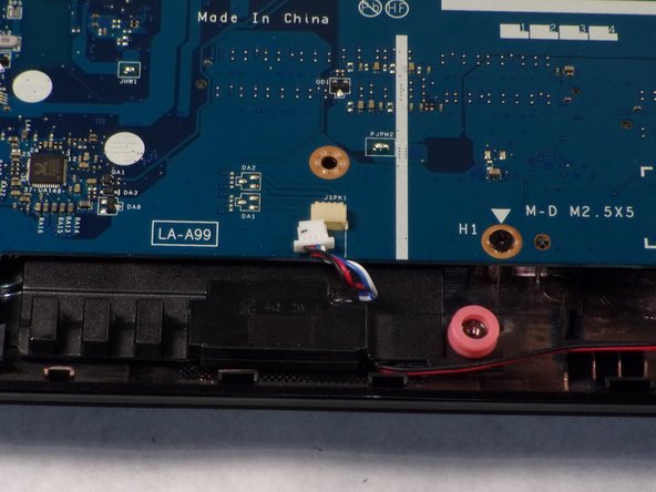

    • Disconnect the power source from the motherboard.
    • The wires are very small and thin, so be careful when removing.
    • Lift the speakers away from the housing by sliding them out from under the motherboard.
