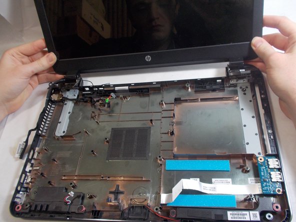

  13. HP 15-g071nr Screen Replacement: crwdns2935265:013crwdnd2935265:01crwdnd2935265:02crwdne2935265:0 HP 15-g071nr Screen Replacement: crwdns2935265:013crwdnd2935265:02crwdnd2935265:02crwdne2935265:0
    • Slowly lift the motherboard by pinching on the middle of its right side.
    • Wiggle the motherboard side to side to remove.
    • The ports must be aligned with each contact point of the plastic frame when reinstalling to line up each screw hole.

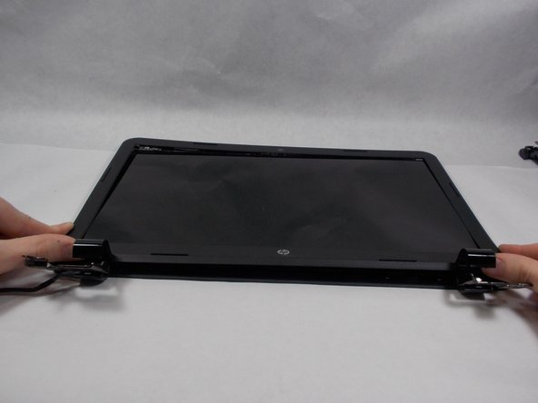

  14. HP 15-g071nr Screen Replacement, Screen: crwdns2935265:014crwdnd2935265:01crwdnd2935265:03crwdne2935265:0 HP 15-g071nr Screen Replacement, Screen: crwdns2935265:014crwdnd2935265:02crwdnd2935265:03crwdne2935265:0 HP 15-g071nr Screen Replacement, Screen: crwdns2935265:014crwdnd2935265:03crwdnd2935265:03crwdne2935265:0
    • Remove three screws at the base of each hinge with the Phillips #0.
    • Bend the screen back as if you were opening it. The goal is to over-extend the hinges.
    • The hinges will bend with some difficulty so it is best to bend them while they are still attached to the laptop.

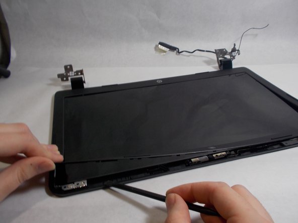

  15. HP 15-g071nr Screen Replacement: crwdns2935265:015crwdnd2935265:01crwdnd2935265:03crwdne2935265:0 HP 15-g071nr Screen Replacement: crwdns2935265:015crwdnd2935265:02crwdnd2935265:03crwdne2935265:0 HP 15-g071nr Screen Replacement: crwdns2935265:015crwdnd2935265:03crwdnd2935265:03crwdne2935265:0
    • Find the seam that separates the black plastic covering the outside of the screen.
    • Using a plastic opening tool, spread the cover apart until you reach where you started.

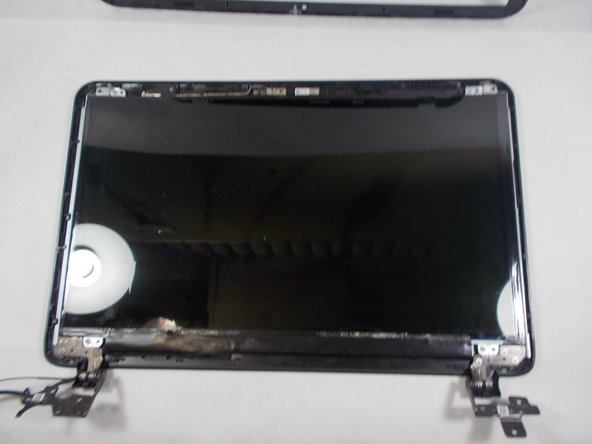

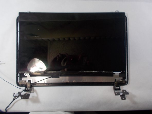

  16. HP 15-g071nr Screen Replacement: crwdns2935265:016crwdnd2935265:01crwdnd2935265:02crwdne2935265:0 HP 15-g071nr Screen Replacement: crwdns2935265:016crwdnd2935265:02crwdnd2935265:02crwdne2935265:0
    • Remove four screws— one at each corner of the screen.
    • Place the screen face down on the nearest surface to the laptop.
    • A ribbon cable is plugged into the center of the screen that must be removed.
