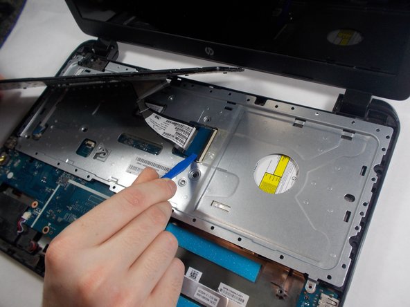

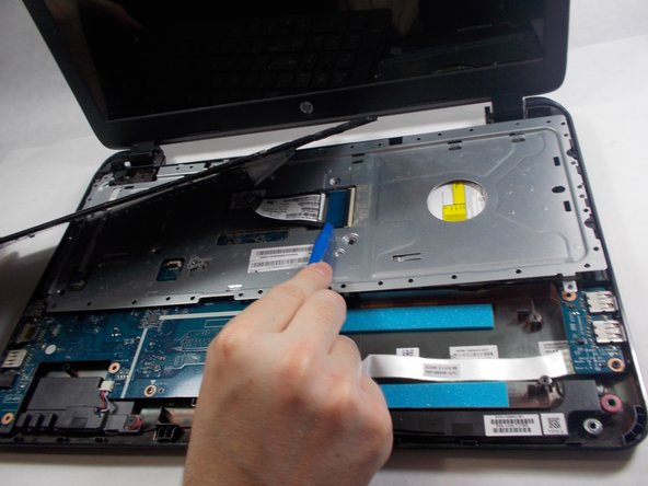

  7. HP 15-g071nr Motherboard Replacement, Motherboard: crwdns2935265:07crwdnd2935265:01crwdnd2935265:03crwdne2935265:0 HP 15-g071nr Motherboard Replacement, Motherboard: crwdns2935265:07crwdnd2935265:02crwdnd2935265:03crwdne2935265:0 HP 15-g071nr Motherboard Replacement, Motherboard: crwdns2935265:07crwdnd2935265:03crwdnd2935265:03crwdne2935265:0

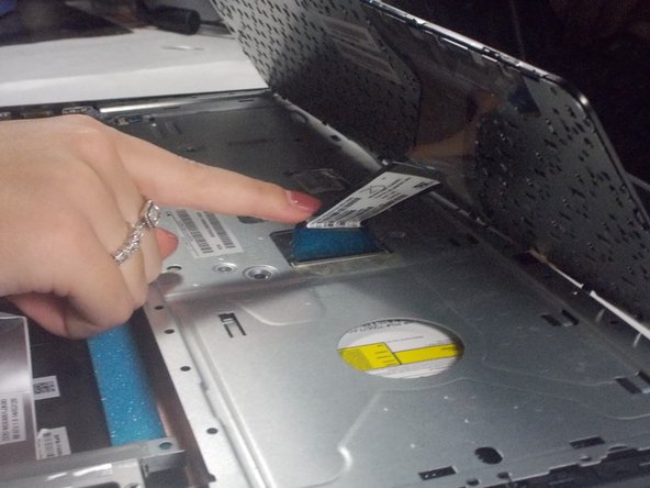

    • Use one of the plastic opening tools or spudger to lift the keyboard from its housing.
    • Slowly lift the keyboard at angle toward the left.
    • Just above the blue plastic connection to the motherboard is a clamp . Use your finger to lift this bar and release the cable.
  8. HP 15-g071nr Motherboard Replacement: crwdns2935265:08crwdnd2935265:01crwdnd2935265:03crwdne2935265:0 HP 15-g071nr Motherboard Replacement: crwdns2935265:08crwdnd2935265:02crwdnd2935265:03crwdne2935265:0 HP 15-g071nr Motherboard Replacement: crwdns2935265:08crwdnd2935265:03crwdnd2935265:03crwdne2935265:0
    • Lift the keyboard with your hand being careful to unseat the ribbon cable with the blue tab.
    • Use the Phillips #0 to remove the five highlighted screws.
    • Lift the plate off of the back of the motherboard.

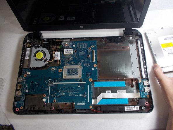

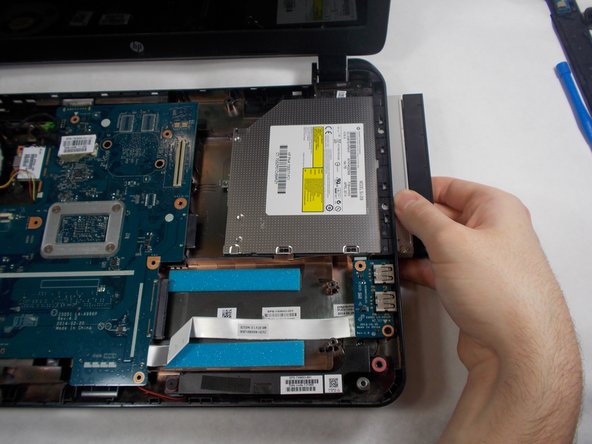

  9. HP 15-g071nr Motherboard Replacement: crwdns2935265:09crwdnd2935265:01crwdnd2935265:03crwdne2935265:0 HP 15-g071nr Motherboard Replacement: crwdns2935265:09crwdnd2935265:02crwdnd2935265:03crwdne2935265:0 HP 15-g071nr Motherboard Replacement: crwdns2935265:09crwdnd2935265:03crwdnd2935265:03crwdne2935265:0
    • The screw holding in the CD drive has already been removed.
    • Slide the CD drive out.

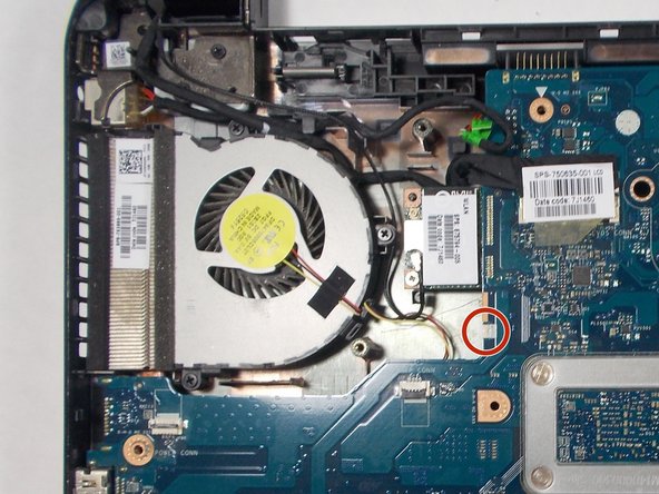

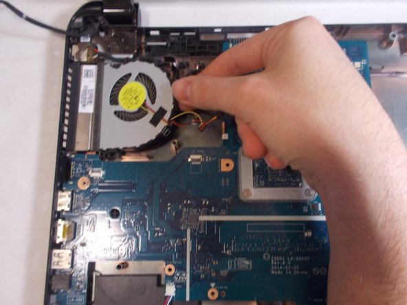

    • Remove the three screws connecting the fan to the motherboard with the Phillips #0.
    • Remove the fans connection to the motherboard.
    • The three pin fan connector will be difficult to remove. It is important to not pull it out by the wires. Instead the small tabs on either side should be used in order to not damage the connector.

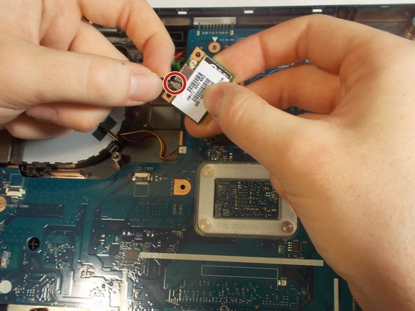

  11. HP 15-g071nr Motherboard Replacement: crwdns2935265:011crwdnd2935265:01crwdnd2935265:02crwdne2935265:0 HP 15-g071nr Motherboard Replacement: crwdns2935265:011crwdnd2935265:02crwdnd2935265:02crwdne2935265:0
    • The screw for the wireless card has already been removed.
    • Carefully pull the wireless card from its interface with the motherboard.
    • The marked connector is the antenna's connection. Use two fingers to wiggle the connector loose from its fitting.
    • The connector will come of at a 90 degree angle once it is removed.
  12. HP 15-g071nr Motherboard Replacement: crwdns2935265:012crwdnd2935265:01crwdnd2935265:02crwdne2935265:0 HP 15-g071nr Motherboard Replacement: crwdns2935265:012crwdnd2935265:02crwdnd2935265:02crwdne2935265:0

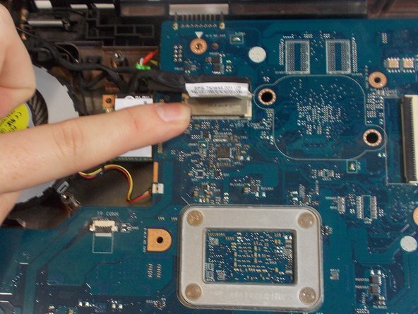

    • Remove the screen connector by pulling on the plastic tab.
    • Gently wiggle the connector side to side while pulling toward the battery.
  13. HP 15-g071nr Motherboard Replacement: crwdns2935265:013crwdnd2935265:01crwdnd2935265:02crwdne2935265:0 HP 15-g071nr Motherboard Replacement: crwdns2935265:013crwdnd2935265:02crwdnd2935265:02crwdne2935265:0
    • Slowly lift the motherboard by pinching on the middle of its right side.
    • Wiggle the motherboard side to side to remove.
    • The ports must be aligned with each contact point of the plastic frame when reinstalling to line up each screw hole.
