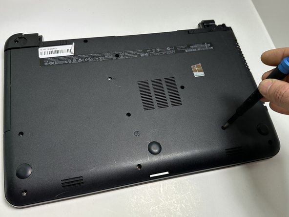

  5. HP 15-g029wm Motherboard Replacement, Upper Case: crwdns2935265:05crwdnd2935265:01crwdnd2935265:02crwdne2935265:0 HP 15-g029wm Motherboard Replacement, Upper Case: crwdns2935265:05crwdnd2935265:02crwdnd2935265:02crwdne2935265:0
    • Remove the following Phillips screws on the lower case:
    • Nine 5 mm
    • One 6 mm
    • This will allow the optical drive to separate from the chassis.

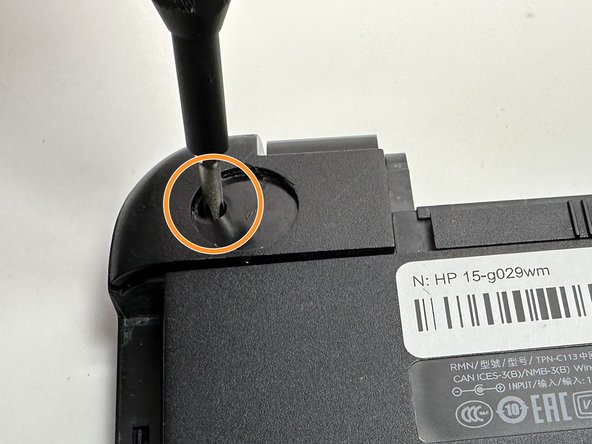

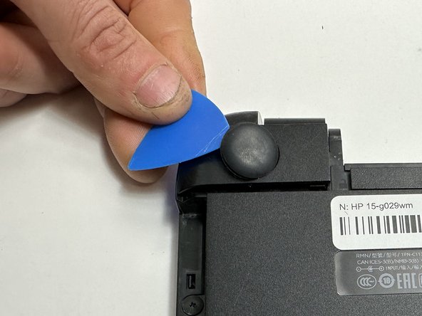

    • Use an opening pick to remove the two circular rubber feet near the laptop hinges.
    • Remove both of the 8 mm Phillips screws.
    • The screws were hidden by the rubber feet.

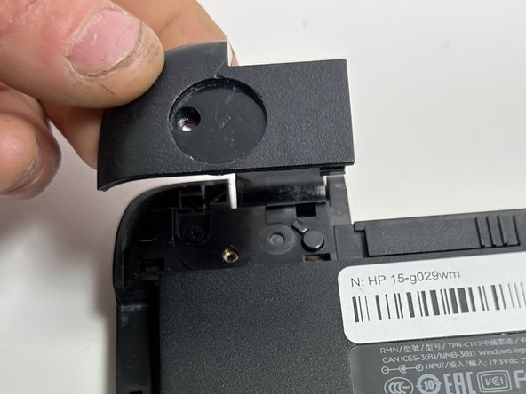

  9. HP 15-g029wm Motherboard Replacement: crwdns2935265:09crwdnd2935265:01crwdnd2935265:02crwdne2935265:0 HP 15-g029wm Motherboard Replacement: crwdns2935265:09crwdnd2935265:02crwdnd2935265:02crwdne2935265:0
    • Use an opening pick to pry up and remove the left hinge cover.
    • Use an opening pick to pry up and remove the right hinge cover.

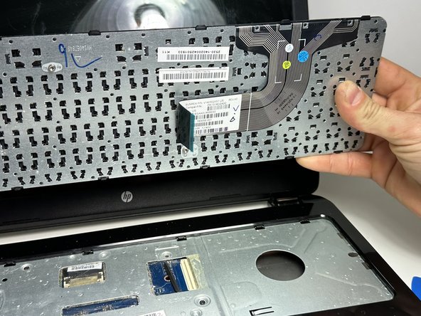

  10. HP 15-g029wm Motherboard Replacement: crwdns2935265:010crwdnd2935265:01crwdnd2935265:03crwdne2935265:0 HP 15-g029wm Motherboard Replacement: crwdns2935265:010crwdnd2935265:02crwdnd2935265:03crwdne2935265:0 HP 15-g029wm Motherboard Replacement: crwdns2935265:010crwdnd2935265:03crwdnd2935265:03crwdne2935265:0

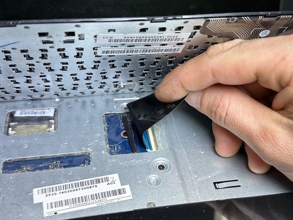

    • Flip the device face up and open the lid.
    • Insert an opening pick under the keyboard and pry around the perimeter of the keyboard until it fully releases.
    • Lift the keyboard slightly.
    • There is a ribbon cable connecting the keyboard to the device on the underside. Do NOT pull it away or you risk ripping the ribbon cable and causing damage.
    • Use your fingers or an opening pick to unlock the ZIF locking flap that secures the keyboard ribbon cable.
    • Disconnect the keyboard ribbon cable.
    • Lift the keyboard off.

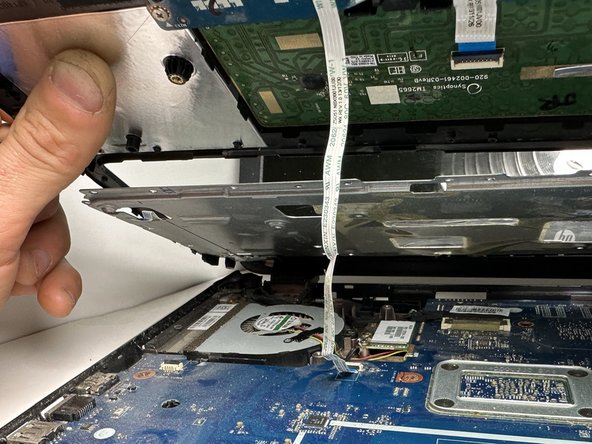

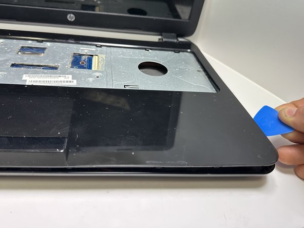

  11. HP 15-g029wm Motherboard Replacement: crwdns2935265:011crwdnd2935265:01crwdnd2935265:03crwdne2935265:0 HP 15-g029wm Motherboard Replacement: crwdns2935265:011crwdnd2935265:02crwdnd2935265:03crwdne2935265:0 HP 15-g029wm Motherboard Replacement: crwdns2935265:011crwdnd2935265:03crwdnd2935265:03crwdne2935265:0
    • Remove two 5 mm screws using a Phillips screwdriver.
    • Insert an opening pick in the seam between the top case and chassis.
    • Slide the opening pick around the edge of the device to separate the top case from the chassis.
    • Slightly lift the top case up and away from the chassis.

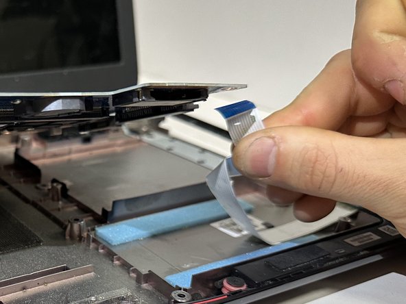

    • There is a ribbon cable connecting the top plate to the device. Handle with care, and do NOT yank on the ribbon cable to prevent damage.

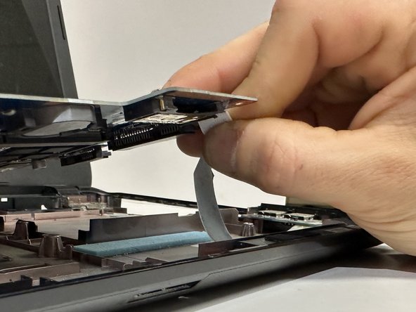

  12. HP 15-g029wm Motherboard Replacement: crwdns2935265:012crwdnd2935265:01crwdnd2935265:03crwdne2935265:0 HP 15-g029wm Motherboard Replacement: crwdns2935265:012crwdnd2935265:02crwdnd2935265:03crwdne2935265:0 HP 15-g029wm Motherboard Replacement: crwdns2935265:012crwdnd2935265:03crwdnd2935265:03crwdne2935265:0
    • Use your fingers or an opening pick to flip up the black ZIF locking flap.
    • Disconnect the ribbon cable.
    • Lift off the top case.

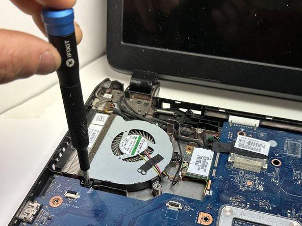

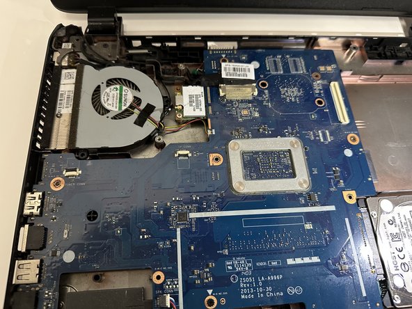

  13. HP 15-g029wm Motherboard Replacement, Fan: crwdns2935265:013crwdnd2935265:01crwdnd2935265:02crwdne2935265:0 HP 15-g029wm Motherboard Replacement, Fan: crwdns2935265:013crwdnd2935265:02crwdnd2935265:02crwdne2935265:0
    • Use a Phillips screwdriver to remove the three 5 mm screws that secure the fan.
  14. HP 15-g029wm Motherboard Replacement: crwdns2935265:014crwdnd2935265:01crwdnd2935265:02crwdne2935265:0 HP 15-g029wm Motherboard Replacement: crwdns2935265:014crwdnd2935265:02crwdnd2935265:02crwdne2935265:0
    • Gently "walk" the fan connector directly out of its motherboard socket.
    • Do not pull on the wires.
  15. HP 15-g029wm Motherboard Replacement: crwdns2935265:015crwdnd2935265:01crwdnd2935265:01crwdne2935265:0
    • Lift the fan up and out of the chassis.

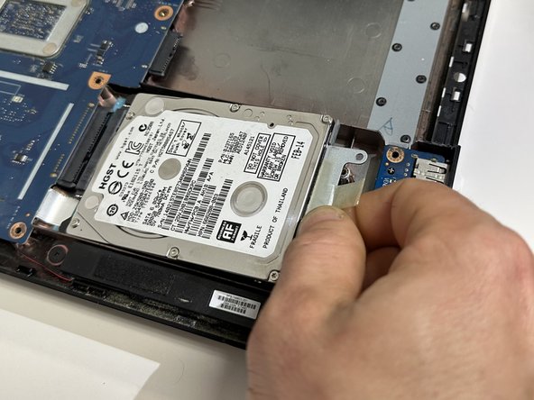

  16. HP 15-g029wm Motherboard Replacement, HDD: crwdns2935265:016crwdnd2935265:01crwdnd2935265:02crwdne2935265:0 HP 15-g029wm Motherboard Replacement, HDD: crwdns2935265:016crwdnd2935265:02crwdnd2935265:02crwdne2935265:0
    • Remove the two 5 mm Phillips screws that secure the HDD.
    • Pull the HDD slightly to the right to disconnect it, then lift it up and out of the chassis.

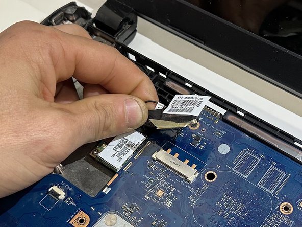

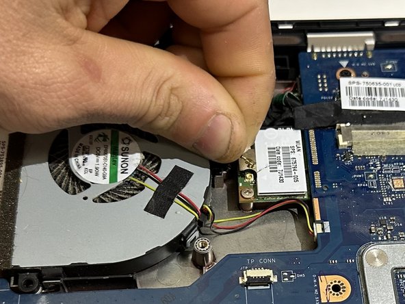

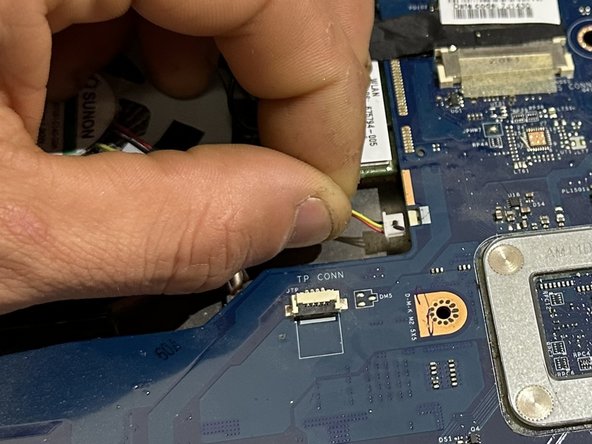

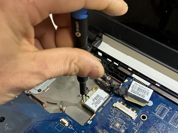

  17. HP 15-g029wm Motherboard Replacement, Wi-Fi Card: crwdns2935265:017crwdnd2935265:01crwdnd2935265:02crwdne2935265:0 HP 15-g029wm Motherboard Replacement, Wi-Fi Card: crwdns2935265:017crwdnd2935265:02crwdnd2935265:02crwdne2935265:0
    • Use the tip of a spudger to pry up and disconnect the two antenna cables attached to the wireless card.

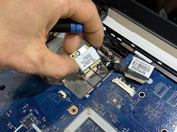

  18. HP 15-g029wm Motherboard Replacement: crwdns2935265:018crwdnd2935265:01crwdnd2935265:03crwdne2935265:0 HP 15-g029wm Motherboard Replacement: crwdns2935265:018crwdnd2935265:02crwdnd2935265:03crwdne2935265:0 HP 15-g029wm Motherboard Replacement: crwdns2935265:018crwdnd2935265:03crwdnd2935265:03crwdne2935265:0
    • Remove the single 3 mm Phillips screw that secures the wireless card.
    • Pull the wireless card out of its socket.
  19. HP 15-g029wm Motherboard Replacement, Motherboard: crwdns2935265:019crwdnd2935265:01crwdnd2935265:03crwdne2935265:0 HP 15-g029wm Motherboard Replacement, Motherboard: crwdns2935265:019crwdnd2935265:02crwdnd2935265:03crwdne2935265:0 HP 15-g029wm Motherboard Replacement, Motherboard: crwdns2935265:019crwdnd2935265:03crwdnd2935265:03crwdne2935265:0

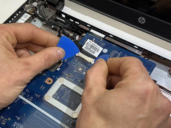

    • Use two opening picks to disconnect the display cable.

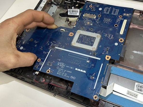

  21. HP 15-g029wm Motherboard Replacement: crwdns2935265:021crwdnd2935265:01crwdnd2935265:03crwdne2935265:0 HP 15-g029wm Motherboard Replacement: crwdns2935265:021crwdnd2935265:02crwdnd2935265:03crwdne2935265:0 HP 15-g029wm Motherboard Replacement: crwdns2935265:021crwdnd2935265:03crwdnd2935265:03crwdne2935265:0
    • Remove the four 3 mm screws that secure the motherboard.

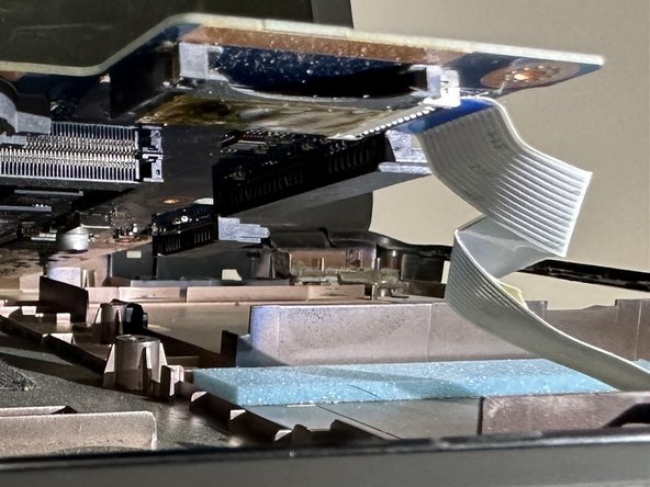

    • Lift the front edge of the motherboard slightly.
    • There is a ribbon cable connecting the motherboard to the device chassis. Do not yank it away.

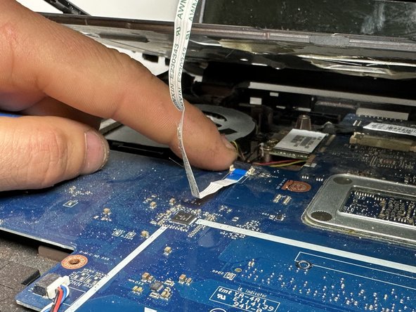

  22. HP 15-g029wm Motherboard Replacement: crwdns2935265:022crwdnd2935265:01crwdnd2935265:03crwdne2935265:0 HP 15-g029wm Motherboard Replacement: crwdns2935265:022crwdnd2935265:02crwdnd2935265:03crwdne2935265:0 HP 15-g029wm Motherboard Replacement: crwdns2935265:022crwdnd2935265:03crwdnd2935265:03crwdne2935265:0
    • Use an opening pick or your fingers to release the ZIF locking flap.
    • Pull the ribbon cable out of its port.
  23. HP 15-g029wm Motherboard Replacement: crwdns2935265:023crwdnd2935265:01crwdnd2935265:01crwdne2935265:0
    • The motherboard is now fully disconnected and able to be removed from the chassis by lifting it out with your hands.
    • Remove the following components for your new motherboard: Heatsink, RAM, CMOS battery.
