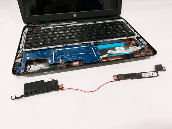

  7. HP 15-g020dx Speaker Replacement, Speaker: crwdns2935265:07crwdnd2935265:01crwdnd2935265:01crwdne2935265:0
    • Detach the clip on the speaker from the port on the motherboard.
  8. HP 15-g020dx Speaker Replacement: crwdns2935265:08crwdnd2935265:01crwdnd2935265:01crwdne2935265:0
    • Pull out the wire connecting the two speakers under the motherboard.
  9. HP 15-g020dx Speaker Replacement: crwdns2935265:09crwdnd2935265:01crwdnd2935265:01crwdne2935265:0
    • Pull the left speaker out and hold the rubber ring.
  10. HP 15-g020dx Speaker Replacement: crwdns2935265:010crwdnd2935265:01crwdnd2935265:02crwdne2935265:0 HP 15-g020dx Speaker Replacement: crwdns2935265:010crwdnd2935265:02crwdnd2935265:02crwdne2935265:0
    • Pull the right speaker out and hold the rubber ring.
