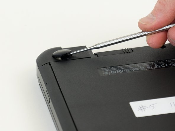

  10. HP 15-g010dx Speakers Replacement: crwdns2935265:010crwdnd2935265:01crwdnd2935265:02crwdne2935265:0 HP 15-g010dx Speakers Replacement: crwdns2935265:010crwdnd2935265:02crwdnd2935265:02crwdne2935265:0
    • Using the spudger, remove the two rubber feet that are located near the battery.

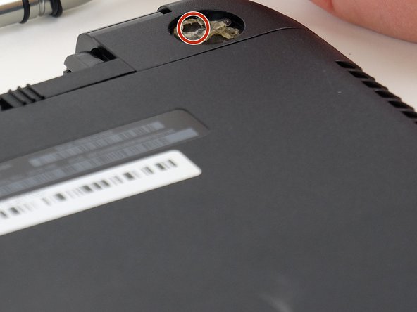

  11. HP 15-g010dx Speakers Replacement: crwdns2935265:011crwdnd2935265:01crwdnd2935265:02crwdne2935265:0 HP 15-g010dx Speakers Replacement: crwdns2935265:011crwdnd2935265:02crwdnd2935265:02crwdne2935265:0
    • Now remove the two Phillips screws that are located below the rubber feet.

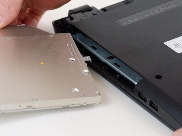

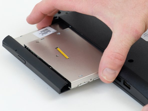

  12. HP 15-g010dx Speakers Replacement: crwdns2935265:012crwdnd2935265:01crwdnd2935265:03crwdne2935265:0 HP 15-g010dx Speakers Replacement: crwdns2935265:012crwdnd2935265:02crwdnd2935265:03crwdne2935265:0 HP 15-g010dx Speakers Replacement: crwdns2935265:012crwdnd2935265:03crwdnd2935265:03crwdne2935265:0
    • Remove the optical drive by pulling it out by hand.
  13. HP 15-g010dx Speakers Replacement: crwdns2935265:013crwdnd2935265:01crwdnd2935265:01crwdne2935265:0
    • Remove the two Phillips screws inside the optical drive housing.

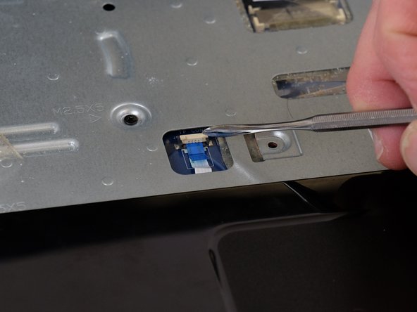

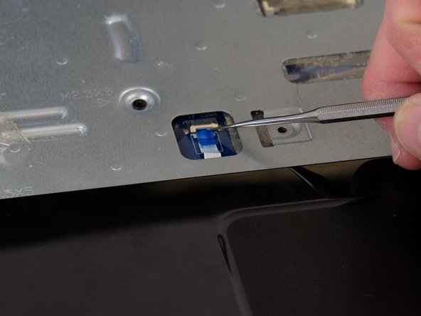

  14. HP 15-g010dx Speakers Replacement: crwdns2935265:014crwdnd2935265:01crwdnd2935265:01crwdne2935265:0
    • Disconnect the power button ribbon cable by lifting the connector.
  15. HP 15-g010dx Speakers Replacement: crwdns2935265:015crwdnd2935265:01crwdnd2935265:03crwdne2935265:0 HP 15-g010dx Speakers Replacement: crwdns2935265:015crwdnd2935265:02crwdnd2935265:03crwdne2935265:0 HP 15-g010dx Speakers Replacement: crwdns2935265:015crwdnd2935265:03crwdnd2935265:03crwdne2935265:0
    • Disconnect the touch pad ribbon cable by lifting up on the connector.

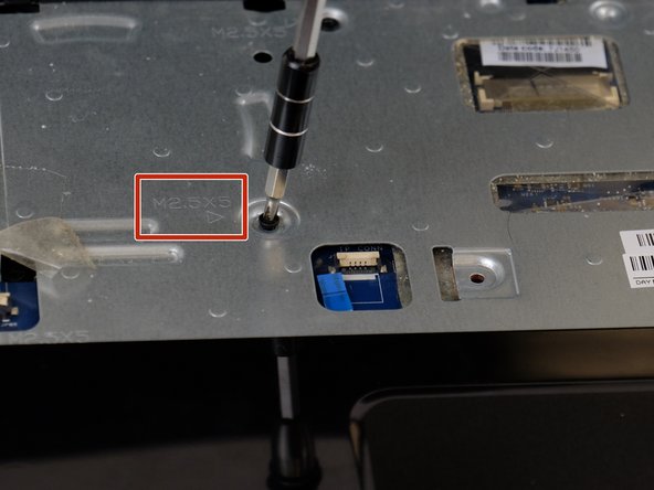

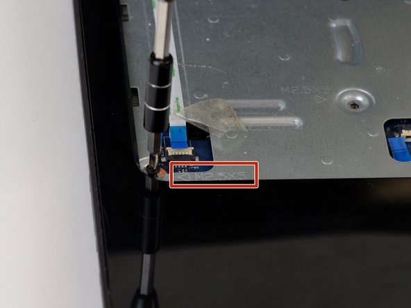

  16. HP 15-g010dx Speakers Replacement: crwdns2935265:016crwdnd2935265:01crwdnd2935265:03crwdne2935265:0 HP 15-g010dx Speakers Replacement: crwdns2935265:016crwdnd2935265:02crwdnd2935265:03crwdne2935265:0 HP 15-g010dx Speakers Replacement: crwdns2935265:016crwdnd2935265:03crwdnd2935265:03crwdne2935265:0
    • Now remove the screws indicated by an arrow stamped into the metal, located where the keyboard was.

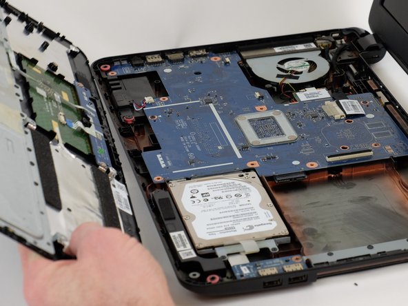

  19. HP 15-g010dx Speakers Replacement: crwdns2935265:019crwdnd2935265:01crwdnd2935265:03crwdne2935265:0 HP 15-g010dx Speakers Replacement: crwdns2935265:019crwdnd2935265:02crwdnd2935265:03crwdne2935265:0 HP 15-g010dx Speakers Replacement: crwdns2935265:019crwdnd2935265:03crwdnd2935265:03crwdne2935265:0
    • Carefully remove the palm rest and flip it over.

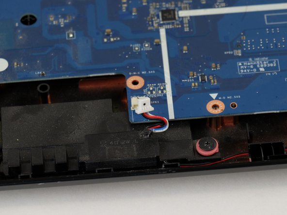

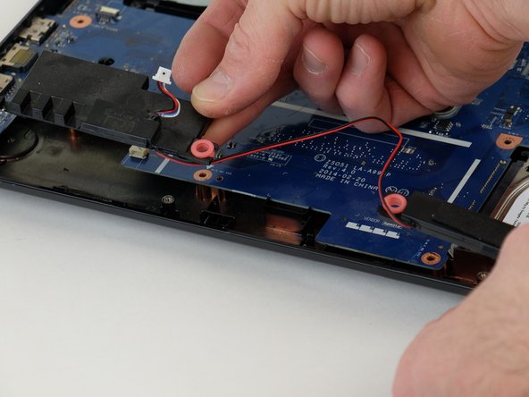

  20. HP 15-g010dx Speakers Replacement: crwdns2935265:020crwdnd2935265:01crwdnd2935265:02crwdne2935265:0 HP 15-g010dx Speakers Replacement: crwdns2935265:020crwdnd2935265:02crwdnd2935265:02crwdne2935265:0
    • Lift up on the speaker connectors to unplug the speaker cables.
  21. HP 15-g010dx Speakers Replacement: crwdns2935265:021crwdnd2935265:01crwdnd2935265:02crwdne2935265:0 HP 15-g010dx Speakers Replacement: crwdns2935265:021crwdnd2935265:02crwdnd2935265:02crwdne2935265:0
    • Remove the screws that are securing the speakers.
  22. HP 15-g010dx Speakers Replacement: crwdns2935265:022crwdnd2935265:01crwdnd2935265:02crwdne2935265:0 HP 15-g010dx Speakers Replacement: crwdns2935265:022crwdnd2935265:02crwdnd2935265:02crwdne2935265:0
    • Remove the speakers.
