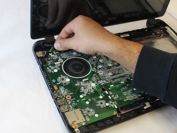

  5. HP 15-f162dx Motherboard Replacement: crwdns2935265:06crwdnd2935265:01crwdnd2935265:01crwdne2935265:0
    • Use Phillips JIS J00 screwdriver to undo the screws that attach the motherboard to the back cover.
    • Again, make sure to apply only a gentle pressure when undoing the screws.
    • Be very careful: If the metal head of the screwdriver slips during the process, it can damage the motherboard. While not relevant in case of removing a broken motherboard, it is crucial while putting in a new one.

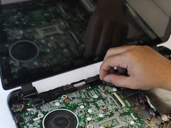

  6. HP 15-f162dx Motherboard Replacement: crwdns2935265:07crwdnd2935265:01crwdnd2935265:03crwdne2935265:0 HP 15-f162dx Motherboard Replacement: crwdns2935265:07crwdnd2935265:02crwdnd2935265:03crwdne2935265:0 HP 15-f162dx Motherboard Replacement: crwdns2935265:07crwdnd2935265:03crwdnd2935265:03crwdne2935265:0
    • Locate and disconnect the wires that are connected to the motherboard.
    • Do not use any kind of metal instrument to assist you in this process since it can damage the contacts of the wires.
    • Instead, you can use a credit card or a plastic spudger included in the Essential Electronics Toolkit.
    • After the wires have been disconnected, gently lift the motherboard out of the laptop.
