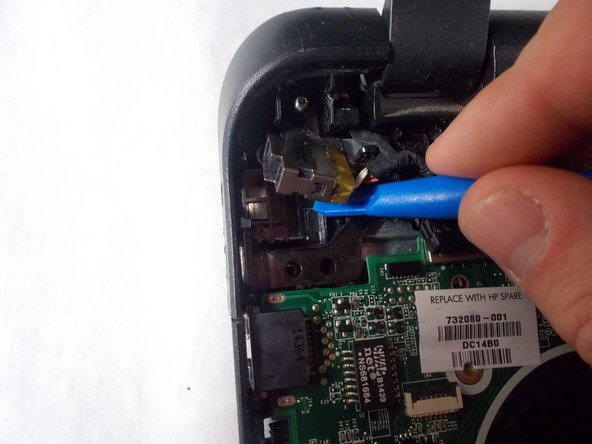

  12. HP 15-f033wm Power Jack Replacement, Power Jack: crwdns2935265:012crwdnd2935265:01crwdnd2935265:01crwdne2935265:0
    • After removing the battery and the palm rest, remove the two 7 mm PH1 Phillips head screws holding in the small metal power jack holder.
  13. HP 15-f033wm Power Jack Replacement: crwdns2935265:013crwdnd2935265:01crwdnd2935265:02crwdne2935265:0 HP 15-f033wm Power Jack Replacement: crwdns2935265:013crwdnd2935265:02crwdnd2935265:02crwdne2935265:0
    • Unplug the wired connection from the laptop to the power jack.
    • Detach broken power jack using blue spudger.
