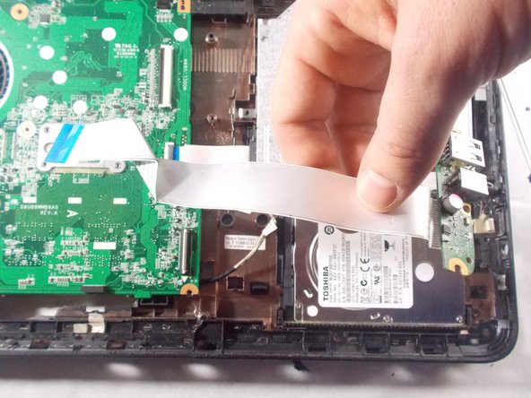

  12. HP 15-f033wm Hard Drive Replacement, Hard Drive: crwdns2935265:012crwdnd2935265:01crwdnd2935265:01crwdne2935265:0
    • After removing the battery and palm rest, unscrew the two 3 mm PH1 Phillips head screws that hold the small tab that secures the connection of the USB port and headphone jack.
  13. HP 15-f033wm Hard Drive Replacement: crwdns2935265:013crwdnd2935265:01crwdnd2935265:02crwdne2935265:0 HP 15-f033wm Hard Drive Replacement: crwdns2935265:013crwdnd2935265:02crwdnd2935265:02crwdne2935265:0
    • Pull the connected cord out of the previously lifted tab and remove from laptop.

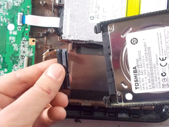

  14. HP 15-f033wm Hard Drive Replacement: crwdns2935265:014crwdnd2935265:01crwdnd2935265:01crwdne2935265:0
    • Lift up hard drive.
  15. HP 15-f033wm Hard Drive Replacement: crwdns2935265:015crwdnd2935265:01crwdnd2935265:02crwdne2935265:0 HP 15-f033wm Hard Drive Replacement: crwdns2935265:015crwdnd2935265:02crwdnd2935265:02crwdne2935265:0
    • Remove the connection from the left of the hard drive connecting it to the rest of the laptop and remove the hard drive from the laptop.
