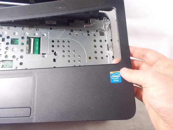

  9. HP 15-f033wm CD Reader Replacement: crwdns2935265:09crwdnd2935265:01crwdnd2935265:02crwdne2935265:0 HP 15-f033wm CD Reader Replacement: crwdns2935265:09crwdnd2935265:02crwdnd2935265:02crwdne2935265:0
    • Remove the palm rest using the blue spudger tool.

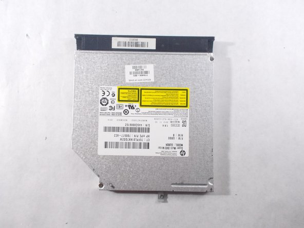

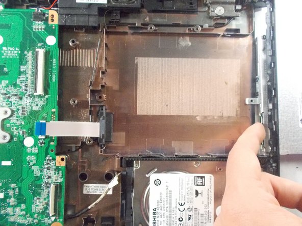

  12. HP 15-f033wm CD Reader Replacement, CD Reader: crwdns2935265:012crwdnd2935265:01crwdnd2935265:01crwdne2935265:0
    • Remove metal bar on top of the CD drive. Do this by removing 3 mm PH1 Phillips head screw that is just below the bottom right corner of CD drive.
  13. HP 15-f033wm CD Reader Replacement: crwdns2935265:013crwdnd2935265:01crwdnd2935265:01crwdne2935265:0
    • Remove the 3 mm PH1 Phillips head screw that is just to the left of the CD drive.
  14. HP 15-f033wm CD Reader Replacement: crwdns2935265:014crwdnd2935265:01crwdnd2935265:03crwdne2935265:0 HP 15-f033wm CD Reader Replacement: crwdns2935265:014crwdnd2935265:02crwdnd2935265:03crwdne2935265:0 HP 15-f033wm CD Reader Replacement: crwdns2935265:014crwdnd2935265:03crwdnd2935265:03crwdne2935265:0
    • Carefully push the CD drive from its left side out of the laptop.
