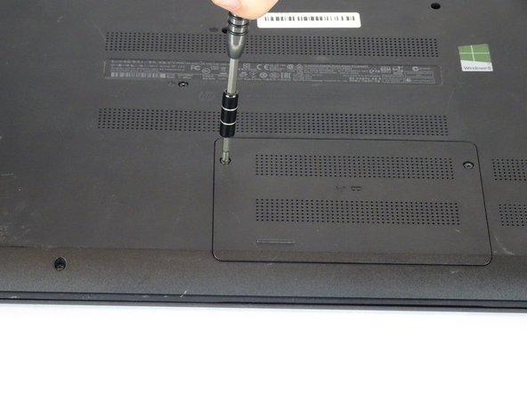

    • Turn laptop upside down.
    • Flip the lock switch to the unlocked setting.
  2. HP 15-f009wm RAM Replacement: crwdns2935265:02crwdnd2935265:01crwdnd2935265:03crwdne2935265:0 HP 15-f009wm RAM Replacement: crwdns2935265:02crwdnd2935265:02crwdnd2935265:03crwdne2935265:0 HP 15-f009wm RAM Replacement: crwdns2935265:02crwdnd2935265:03crwdnd2935265:03crwdne2935265:0
    • Flip the release switch.
    • Once the flip is switched, the battery should pop out.
  3. HP 15-f009wm RAM Replacement: crwdns2935265:03crwdnd2935265:01crwdnd2935265:02crwdne2935265:0 HP 15-f009wm RAM Replacement: crwdns2935265:03crwdnd2935265:02crwdnd2935265:02crwdne2935265:0
    • Slide the battery out.
  4. HP 15-f009wm RAM Replacement, RAM: crwdns2935265:04crwdnd2935265:01crwdnd2935265:03crwdne2935265:0 HP 15-f009wm RAM Replacement, RAM: crwdns2935265:04crwdnd2935265:02crwdnd2935265:03crwdne2935265:0 HP 15-f009wm RAM Replacement, RAM: crwdns2935265:04crwdnd2935265:03crwdnd2935265:03crwdne2935265:0
    • Remove the two Phillips #1 screws from the RAM panel.
  5. HP 15-f009wm RAM Replacement: crwdns2935265:05crwdnd2935265:01crwdnd2935265:03crwdne2935265:0 HP 15-f009wm RAM Replacement: crwdns2935265:05crwdnd2935265:02crwdnd2935265:03crwdne2935265:0 HP 15-f009wm RAM Replacement: crwdns2935265:05crwdnd2935265:03crwdnd2935265:03crwdne2935265:0
    • Use the plastic opening tool to pop the panel off.
  6. HP 15-f009wm RAM Replacement: crwdns2935265:06crwdnd2935265:01crwdnd2935265:03crwdne2935265:0 HP 15-f009wm RAM Replacement: crwdns2935265:06crwdnd2935265:02crwdnd2935265:03crwdne2935265:0 HP 15-f009wm RAM Replacement: crwdns2935265:06crwdnd2935265:03crwdnd2935265:03crwdne2935265:0
    • Release the tabs on each side of the chip by simultaneously pushing each tab away from the RAM.
    • These tabs lock the chip in place and releasing them will cause the chip to "pop" up.
  7. HP 15-f009wm RAM Replacement: crwdns2935265:07crwdnd2935265:01crwdnd2935265:01crwdne2935265:0
    • Remove the RAM chip from the laptop.
