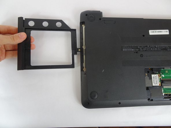

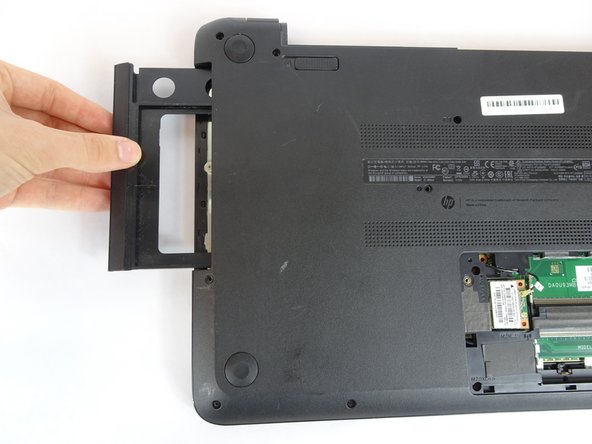

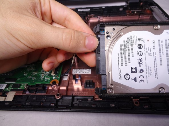

  8. HP 15-f009wm Cooling System Replacement, Hard Drive: crwdns2935265:08crwdnd2935265:01crwdnd2935265:01crwdne2935265:0
    • Remove the sixteen 7mm Phillips #1 screws from the bottom panel.
  9. HP 15-f009wm Cooling System Replacement: crwdns2935265:09crwdnd2935265:01crwdnd2935265:03crwdne2935265:0 HP 15-f009wm Cooling System Replacement: crwdns2935265:09crwdnd2935265:02crwdnd2935265:03crwdne2935265:0 HP 15-f009wm Cooling System Replacement: crwdns2935265:09crwdnd2935265:03crwdnd2935265:03crwdne2935265:0
    • Pull the disk drive out of the laptop.

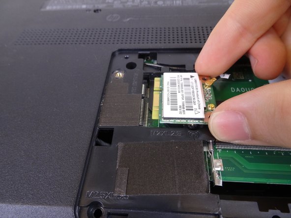

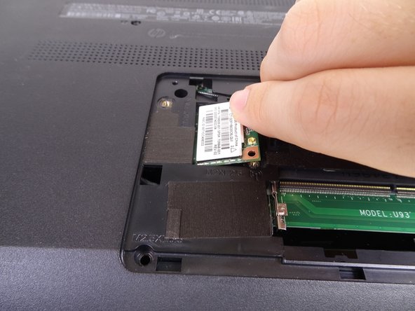

  11. HP 15-f009wm Cooling System Replacement: crwdns2935265:011crwdnd2935265:01crwdnd2935265:03crwdne2935265:0 HP 15-f009wm Cooling System Replacement: crwdns2935265:011crwdnd2935265:02crwdnd2935265:03crwdne2935265:0 HP 15-f009wm Cooling System Replacement: crwdns2935265:011crwdnd2935265:03crwdnd2935265:03crwdne2935265:0
    • Remove the single 4mm Phillips #1 screw from the Wi-Fi card.
    • Pull the Wi-Fi card out of the motherboard.

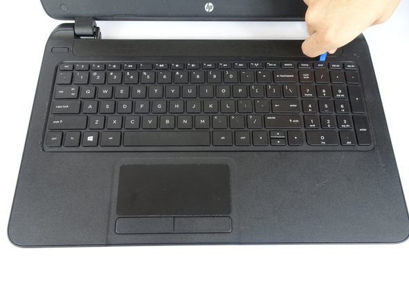

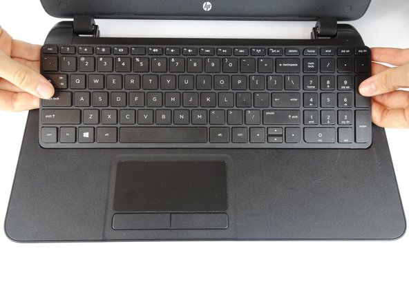

    • Open the laptop.
    • Use a plastic opening tool to pop out the keyboard by starting at the top and working your way around the perimeter.

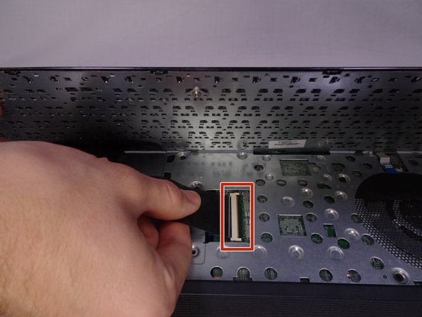

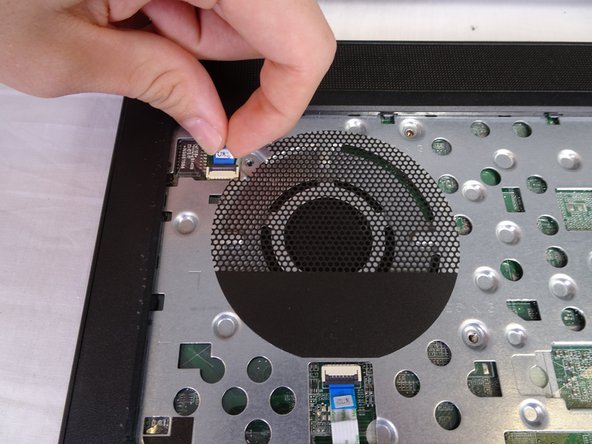

  13. HP 15-f009wm Cooling System Replacement: crwdns2935265:013crwdnd2935265:01crwdnd2935265:02crwdne2935265:0 HP 15-f009wm Cooling System Replacement: crwdns2935265:013crwdnd2935265:02crwdnd2935265:02crwdne2935265:0
    • Open the screen up until it lays flat and rotate the laptop until the screen is closest to you.
    • Lift the keyboard from the laptop.

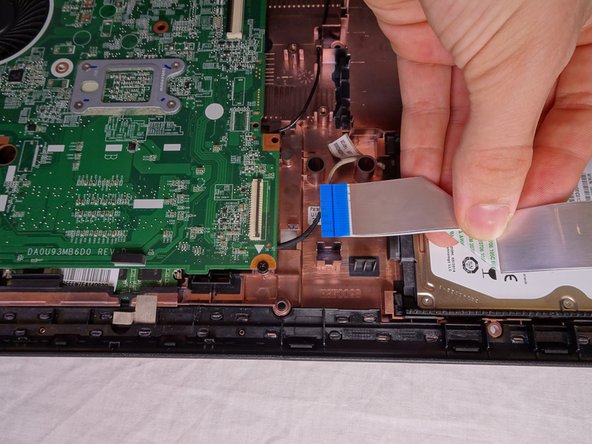

    • Use a spudger to lift up the black latch on the ZIF connector and remove the ribbon cable.
  14. HP 15-f009wm Cooling System Replacement: crwdns2935265:014crwdnd2935265:01crwdnd2935265:01crwdne2935265:0
    • Remove the five 7mm Phillips #1 screws found underneath the keyboard.

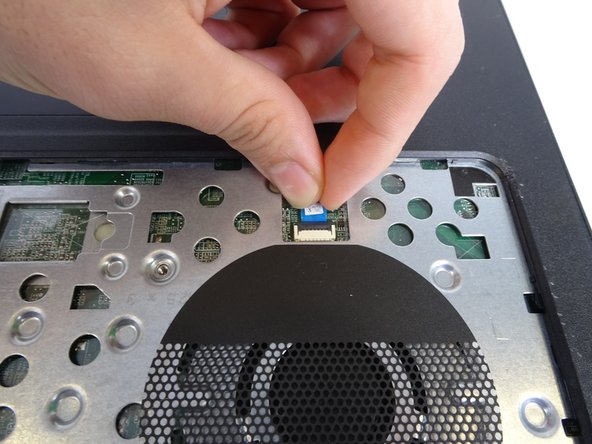

  15. HP 15-f009wm Cooling System Replacement: crwdns2935265:015crwdnd2935265:01crwdnd2935265:03crwdne2935265:0 HP 15-f009wm Cooling System Replacement: crwdns2935265:015crwdnd2935265:02crwdnd2935265:03crwdne2935265:0 HP 15-f009wm Cooling System Replacement: crwdns2935265:015crwdnd2935265:03crwdnd2935265:03crwdne2935265:0

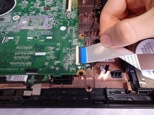

    • Use a spudger to lift the black tabs on the ZIF connectors.
    • Remove the ribbon cables from the ZIF connectors.

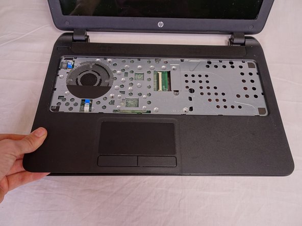

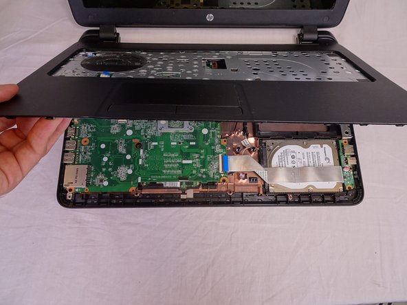

  16. HP 15-f009wm Cooling System Replacement: crwdns2935265:016crwdnd2935265:01crwdnd2935265:03crwdne2935265:0 HP 15-f009wm Cooling System Replacement: crwdns2935265:016crwdnd2935265:02crwdnd2935265:03crwdne2935265:0 HP 15-f009wm Cooling System Replacement: crwdns2935265:016crwdnd2935265:03crwdnd2935265:03crwdne2935265:0
    • Use a plastic opening tool to pop the palm rest off of the laptop.
    • Lift and remove the palm rest.

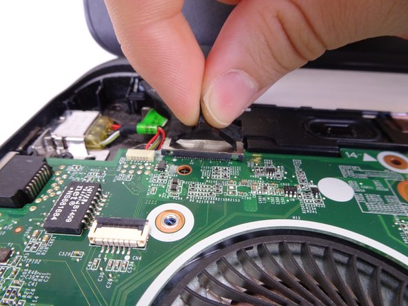

  17. HP 15-f009wm Cooling System Replacement: crwdns2935265:017crwdnd2935265:01crwdnd2935265:03crwdne2935265:0 HP 15-f009wm Cooling System Replacement: crwdns2935265:017crwdnd2935265:02crwdnd2935265:03crwdne2935265:0 HP 15-f009wm Cooling System Replacement: crwdns2935265:017crwdnd2935265:03crwdnd2935265:03crwdne2935265:0
    • Use a spudger to lift up the black latch on the ZIF connector.
    • Remove the USB/AUX port ribbon cable from the ZIF connector on the motherboard.

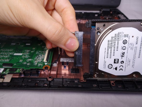

  19. HP 15-f009wm Cooling System Replacement: crwdns2935265:019crwdnd2935265:01crwdnd2935265:03crwdne2935265:0 HP 15-f009wm Cooling System Replacement: crwdns2935265:019crwdnd2935265:02crwdnd2935265:03crwdne2935265:0 HP 15-f009wm Cooling System Replacement: crwdns2935265:019crwdnd2935265:03crwdnd2935265:03crwdne2935265:0
    • Lift the Hard Drive from the laptop.
    • Disconnect the hard drive from the motherboard.

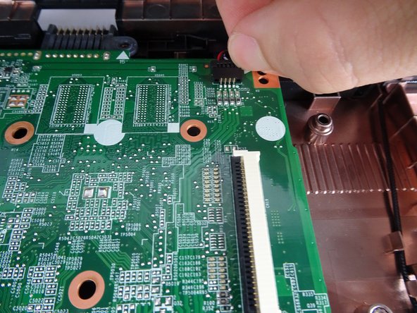

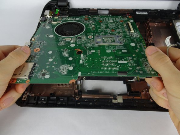

  20. HP 15-f009wm Cooling System Replacement, Motherboard: crwdns2935265:020crwdnd2935265:01crwdnd2935265:02crwdne2935265:0 HP 15-f009wm Cooling System Replacement, Motherboard: crwdns2935265:020crwdnd2935265:02crwdnd2935265:02crwdne2935265:0
    • Remove the four 4mm Phillips #1 screws from the motherboard.
    • Lift the motherboard up from the computer.
    • There will be three wires connected underneath.

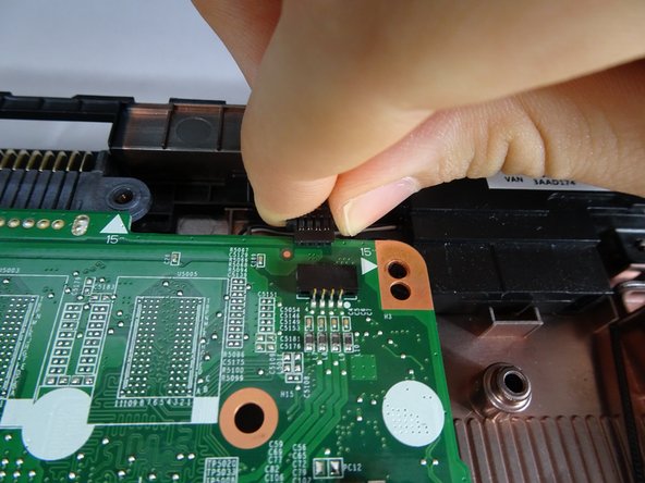

  21. HP 15-f009wm Cooling System Replacement: crwdns2935265:021crwdnd2935265:01crwdnd2935265:03crwdne2935265:0 HP 15-f009wm Cooling System Replacement: crwdns2935265:021crwdnd2935265:02crwdnd2935265:03crwdne2935265:0 HP 15-f009wm Cooling System Replacement: crwdns2935265:021crwdnd2935265:03crwdnd2935265:03crwdne2935265:0
    • Disconnect the speaker.

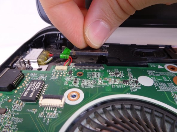

  22. HP 15-f009wm Cooling System Replacement: crwdns2935265:022crwdnd2935265:01crwdnd2935265:03crwdne2935265:0 HP 15-f009wm Cooling System Replacement: crwdns2935265:022crwdnd2935265:02crwdnd2935265:03crwdne2935265:0 HP 15-f009wm Cooling System Replacement: crwdns2935265:022crwdnd2935265:03crwdnd2935265:03crwdne2935265:0
    • Remove the display connection wire. Lift the connection straight up from the motherboard.

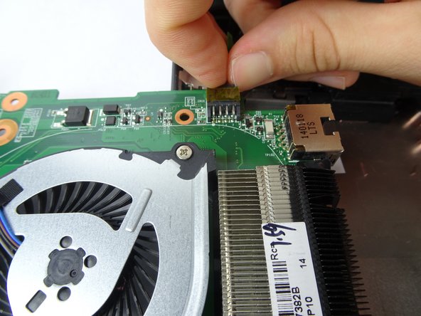

  23. HP 15-f009wm Cooling System Replacement: crwdns2935265:023crwdnd2935265:01crwdnd2935265:03crwdne2935265:0 HP 15-f009wm Cooling System Replacement: crwdns2935265:023crwdnd2935265:02crwdnd2935265:03crwdne2935265:0 HP 15-f009wm Cooling System Replacement: crwdns2935265:023crwdnd2935265:03crwdnd2935265:03crwdne2935265:0
    • Flip the motherboard over.
    • Disconnect the charging port wire from the motherboard.

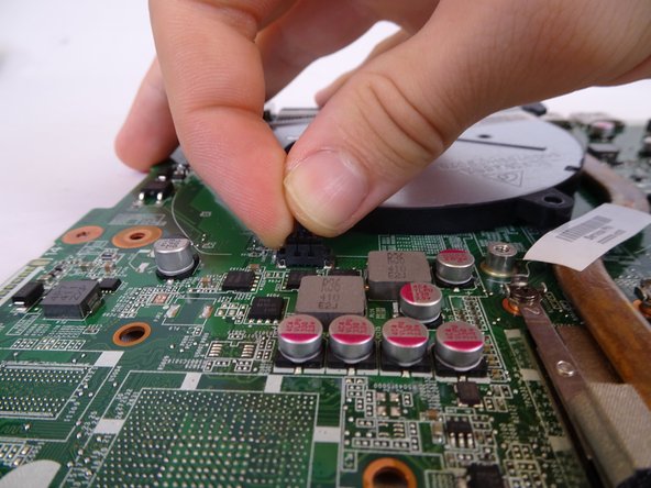

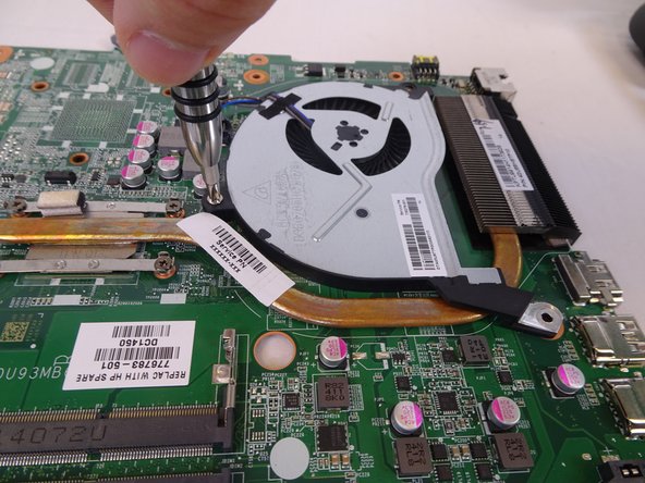

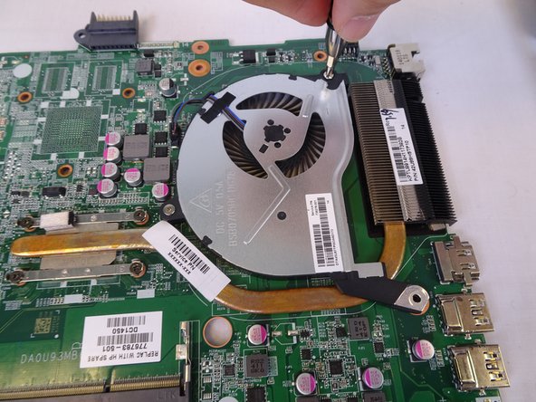

  24. HP 15-f009wm Cooling System Replacement, Cooling System: crwdns2935265:024crwdnd2935265:01crwdnd2935265:03crwdne2935265:0 HP 15-f009wm Cooling System Replacement, Cooling System: crwdns2935265:024crwdnd2935265:02crwdnd2935265:03crwdne2935265:0 HP 15-f009wm Cooling System Replacement, Cooling System: crwdns2935265:024crwdnd2935265:03crwdnd2935265:03crwdne2935265:0
    • Use the PH1 Screwdriver to remove the two screws (7 mm) which hold the fan in place.

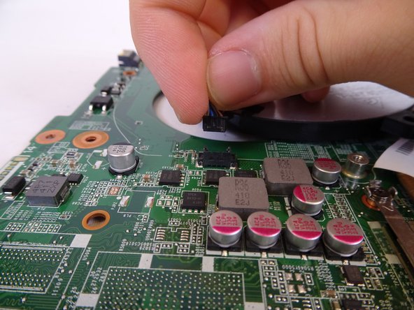

  25. HP 15-f009wm Cooling System Replacement: crwdns2935265:025crwdnd2935265:01crwdnd2935265:03crwdne2935265:0 HP 15-f009wm Cooling System Replacement: crwdns2935265:025crwdnd2935265:02crwdnd2935265:03crwdne2935265:0 HP 15-f009wm Cooling System Replacement: crwdns2935265:025crwdnd2935265:03crwdnd2935265:03crwdne2935265:0
    • The fan will now only be connected via its connection wire.
    • Unplug the connection wire.
