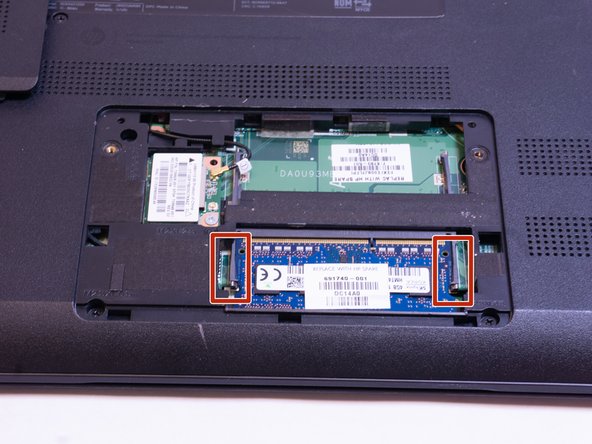

    • Flip laptop over to the back, so that the stickers are showing and the RAM panel is facing up.
  2. HP 15-f004dx RAM Replacement: crwdns2935265:02crwdnd2935265:01crwdnd2935265:01crwdne2935265:0
    • Use a Phillips #0 screwdriver to unscrew the two 2mm RAM shield screws from the bottom of the laptop.
  3. HP 15-f004dx RAM Replacement: crwdns2935265:03crwdnd2935265:01crwdnd2935265:03crwdne2935265:0 HP 15-f004dx RAM Replacement: crwdns2935265:03crwdnd2935265:02crwdnd2935265:03crwdne2935265:0 HP 15-f004dx RAM Replacement: crwdns2935265:03crwdnd2935265:03crwdnd2935265:03crwdne2935265:0
    • Remove the RAM shield.

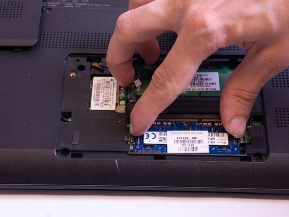

    • Small brackets secure the RAM. Push the brackets to the side to free the RAM.
  4. HP 15-f004dx RAM Replacement: crwdns2935265:04crwdnd2935265:01crwdnd2935265:02crwdne2935265:0 HP 15-f004dx RAM Replacement: crwdns2935265:04crwdnd2935265:02crwdnd2935265:02crwdne2935265:0

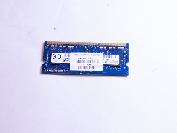

    • The RAM card should now pop up out of its slot. Remove the RAM.
