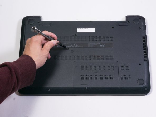

    • After testing the battery and discovering that it needs to be replaced, you will begin by placing the computer upside-down on a flat surface.
  2. HP 15-f004dx Optical Drive  Replacement: crwdns2935265:02crwdnd2935265:01crwdnd2935265:02crwdne2935265:0 HP 15-f004dx Optical Drive  Replacement: crwdns2935265:02crwdnd2935265:02crwdnd2935265:02crwdne2935265:0
    • Locate a switch in the upper left corner with a lock symbol next to it.
    • Slide the switch to the right until you see an unlocked symbol on the opposite side.
  3. HP 15-f004dx Optical Drive  Replacement: crwdns2935265:03crwdnd2935265:01crwdnd2935265:02crwdne2935265:0 HP 15-f004dx Optical Drive  Replacement: crwdns2935265:03crwdnd2935265:02crwdnd2935265:02crwdne2935265:0
    • There is another switch on the opposite side of the computer with a battery symbol next to it.
    • Slide this switch to the left and the battery should detach from the computer.
    • To completely remove the battery, simply pull the battery away from the computer.
  4. HP 15-f004dx Optical Drive  Replacement, Optical Drive: crwdns2935265:04crwdnd2935265:01crwdnd2935265:02crwdne2935265:0 HP 15-f004dx Optical Drive  Replacement, Optical Drive: crwdns2935265:04crwdnd2935265:02crwdnd2935265:02crwdne2935265:0
    • Use a J1 or PH1 screwdriver to remove the 6.5mm screw that secures the optical drive.
  5. HP 15-f004dx Optical Drive  Replacement: crwdns2935265:05crwdnd2935265:01crwdnd2935265:01crwdne2935265:0
    • Once the optical drive screw has been removed, use a plastic opening tool to loosen the optical drive.
    • If the battery port is facing away from you, the optical drive will be on the left hand side of the device.
  6. HP 15-f004dx Optical Drive  Replacement: crwdns2935265:06crwdnd2935265:01crwdnd2935265:01crwdne2935265:0
    • Gently remove the optical drive once it has been loosened.
