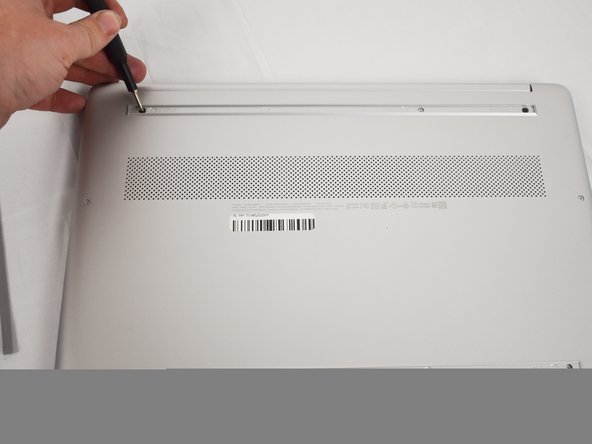

    • Turn the laptop upside down with the hinge facing you.
  2. HP 15-ef2025nr RAM Replacement: crwdns2935265:02crwdnd2935265:01crwdnd2935265:02crwdne2935265:0 HP 15-ef2025nr RAM Replacement: crwdns2935265:02crwdnd2935265:02crwdnd2935265:02crwdne2935265:0
    • Use an opening tool to remove the rubber strips by prying up a corner and gently pulling off the strip.
  3. HP 15-ef2025nr RAM Replacement: crwdns2935265:03crwdnd2935265:01crwdnd2935265:02crwdne2935265:0 HP 15-ef2025nr RAM Replacement: crwdns2935265:03crwdnd2935265:02crwdnd2935265:02crwdne2935265:0
    • Use a Phillips screwdriver to remove the eight 3 mm screws (including the 2 screws that were not under the rubber strips) securing the lower case.

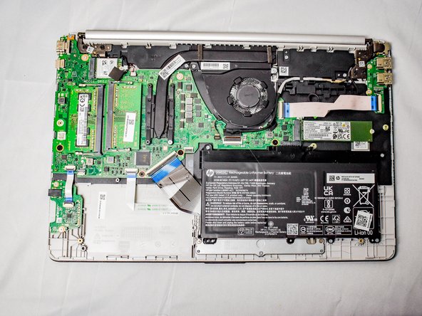

  4. HP 15-ef2025nr RAM Replacement: crwdns2935265:04crwdnd2935265:01crwdnd2935265:02crwdne2935265:0 HP 15-ef2025nr RAM Replacement: crwdns2935265:04crwdnd2935265:02crwdnd2935265:02crwdne2935265:0
    • Flip the laptop over and open the lid.
    • Insert an opening tool into the seam between the edge of the lower case and the chassis.
    • Gently pry around the entire perimeter until the lower case separates from the chassis.
    • Close the lid and flip the laptop back over.
    • Remove the lower case.

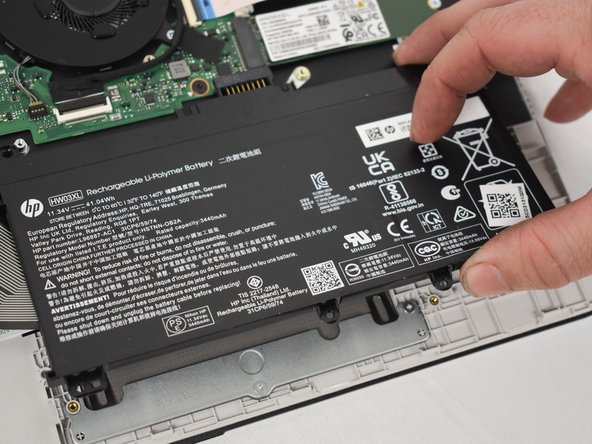

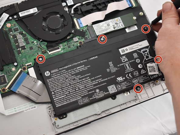

  5. HP 15-ef2025nr RAM Replacement: crwdns2935265:05crwdnd2935265:01crwdnd2935265:03crwdne2935265:0 HP 15-ef2025nr RAM Replacement: crwdns2935265:05crwdnd2935265:02crwdnd2935265:03crwdne2935265:0 HP 15-ef2025nr RAM Replacement: crwdns2935265:05crwdnd2935265:03crwdnd2935265:03crwdne2935265:0
    • Remove the five 2 mm Phillips screws holding the battery down.
    • Take care not to puncture, bend, or twist the battery. Lithium batteries can be very volatile. Follow all proper hazardous disposal laws where you live.
    • Gently lift the front edge of the battery up to disconnect the socket.
    • Lift the battery up and out.

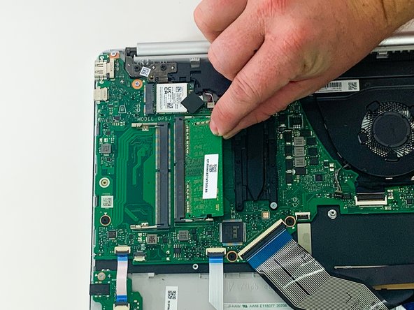

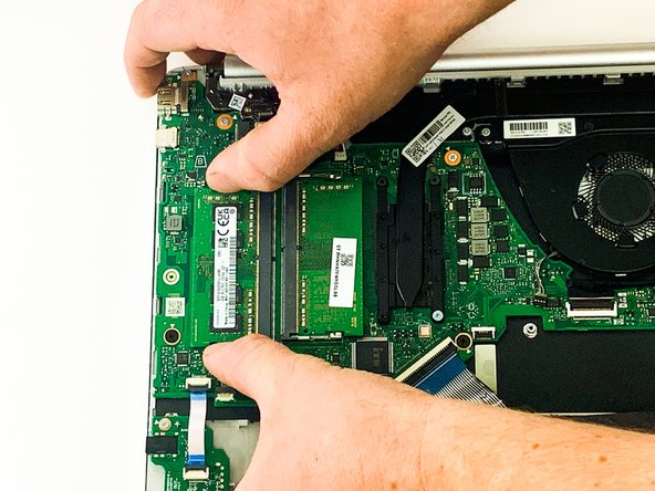

  6. HP 15-ef2025nr RAM Replacement, RAM: crwdns2935265:06crwdnd2935265:01crwdnd2935265:03crwdne2935265:0 HP 15-ef2025nr RAM Replacement, RAM: crwdns2935265:06crwdnd2935265:02crwdnd2935265:03crwdne2935265:0 HP 15-ef2025nr RAM Replacement, RAM: crwdns2935265:06crwdnd2935265:03crwdnd2935265:03crwdne2935265:0
    • Gently pry apart the two silver retention arms simultaneously.
    • The RAM module will pop up at a 45 degree angle.
    • Pull the RAM module directly out its socket.
