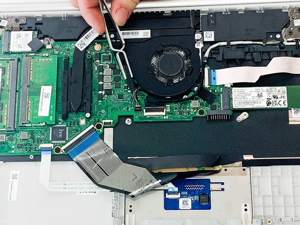

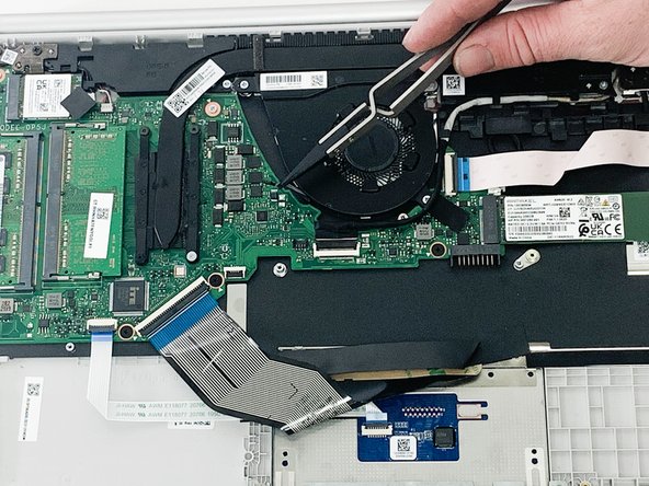

  6. HP 15-ef2025nr Fan Replacement, Fan: crwdns2935265:06crwdnd2935265:01crwdnd2935265:03crwdne2935265:0 HP 15-ef2025nr Fan Replacement, Fan: crwdns2935265:06crwdnd2935265:02crwdnd2935265:03crwdne2935265:0 HP 15-ef2025nr Fan Replacement, Fan: crwdns2935265:06crwdnd2935265:03crwdnd2935265:03crwdne2935265:0
    • Use tweezers to pull the fan connector directly out of its motherboard socket.
    • Do not pull on the wires; they are very delicate.

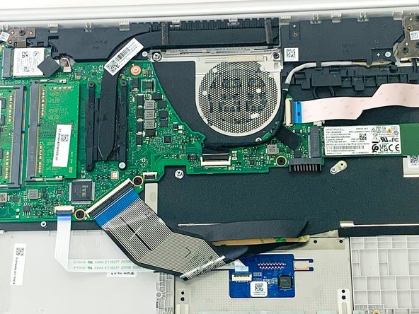

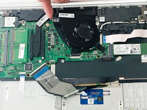

  7. HP 15-ef2025nr Fan Replacement: crwdns2935265:07crwdnd2935265:01crwdnd2935265:03crwdne2935265:0 HP 15-ef2025nr Fan Replacement: crwdns2935265:07crwdnd2935265:02crwdnd2935265:03crwdne2935265:0 HP 15-ef2025nr Fan Replacement: crwdns2935265:07crwdnd2935265:03crwdnd2935265:03crwdne2935265:0
    • Remove the three 2 mm Phillips screws at the top corners and four o'clock position on the fan.
    • Remove the fan.
