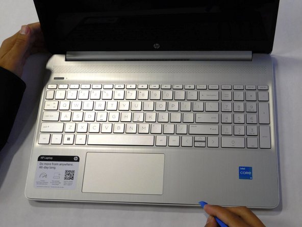

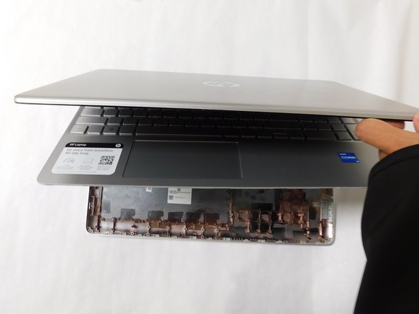

    • Flip the laptop over and open the lid.
    • Separate the bottom panel from the main body by using the iFixit opening tool.
    • Ensure that the bottom panel is completely separated along the edges.
  4. HP 15-dy2702dx Keyboard Replacement: crwdns2935265:04crwdnd2935265:01crwdnd2935265:02crwdne2935265:0 HP 15-dy2702dx Keyboard Replacement: crwdns2935265:04crwdnd2935265:02crwdnd2935265:02crwdne2935265:0
    • If you can lift the laptop like shown in the first picture, the bottom panel is nearly separated.
    • Close the laptop to allow the back edges to fully separate

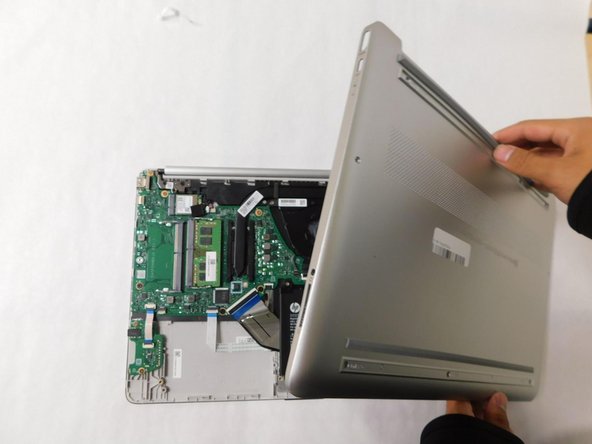

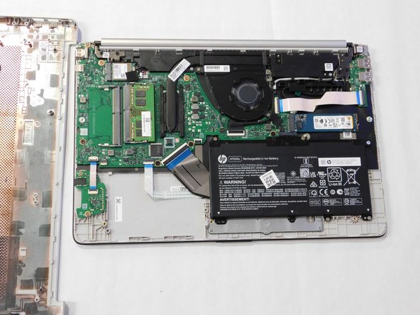

  5. HP 15-dy2702dx Keyboard Replacement: crwdns2935265:05crwdnd2935265:01crwdnd2935265:03crwdne2935265:0 HP 15-dy2702dx Keyboard Replacement: crwdns2935265:05crwdnd2935265:02crwdnd2935265:03crwdne2935265:0 HP 15-dy2702dx Keyboard Replacement: crwdns2935265:05crwdnd2935265:03crwdnd2935265:03crwdne2935265:0
    • Flip the laptop over and carefully remove the lower case.

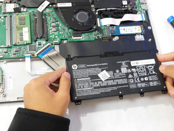

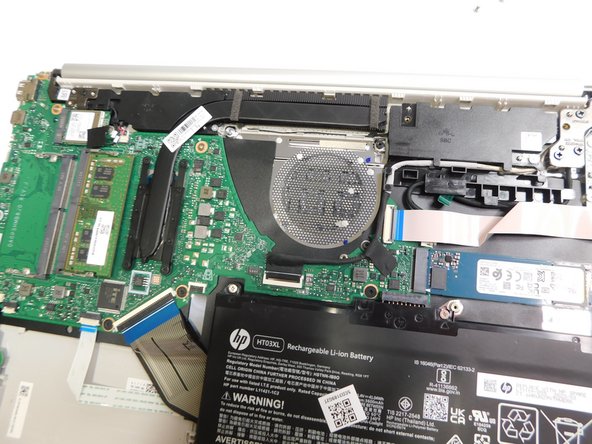

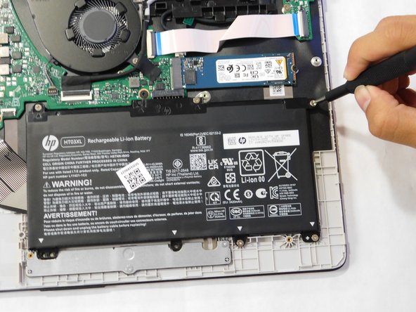

  6. HP 15-dy2702dx Keyboard Replacement, Battery: crwdns2935265:06crwdnd2935265:01crwdnd2935265:02crwdne2935265:0 HP 15-dy2702dx Keyboard Replacement, Battery: crwdns2935265:06crwdnd2935265:02crwdnd2935265:02crwdne2935265:0
    • Remove the five M2x6 screws that secure the battery with a Phillips #1 screwdriver.
  7. HP 15-dy2702dx Keyboard Replacement: crwdns2935265:07crwdnd2935265:01crwdnd2935265:03crwdne2935265:0 HP 15-dy2702dx Keyboard Replacement: crwdns2935265:07crwdnd2935265:02crwdnd2935265:03crwdne2935265:0 HP 15-dy2702dx Keyboard Replacement: crwdns2935265:07crwdnd2935265:03crwdnd2935265:03crwdne2935265:0
    • Grab the sides of the battery and gently pull the battery until it disconnects from the connector on motherboard.
    • Lift the battery up and out.

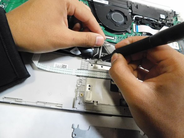

  8. HP 15-dy2702dx Keyboard Replacement, Trackpad: crwdns2935265:08crwdnd2935265:01crwdnd2935265:01crwdne2935265:0
    • Find the trackpad.
  9. HP 15-dy2702dx Keyboard Replacement: crwdns2935265:09crwdnd2935265:01crwdnd2935265:03crwdne2935265:0 HP 15-dy2702dx Keyboard Replacement: crwdns2935265:09crwdnd2935265:02crwdnd2935265:03crwdne2935265:0 HP 15-dy2702dx Keyboard Replacement: crwdns2935265:09crwdnd2935265:03crwdnd2935265:03crwdne2935265:0

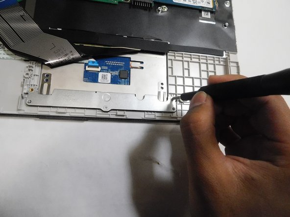

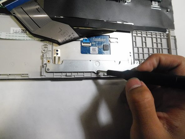

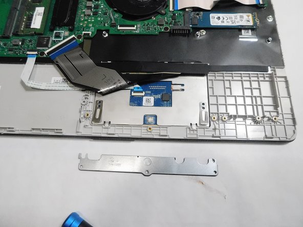

    • Unscrew the two M2x6 Phillips #1 screws securing the trackpad.
  10. HP 15-dy2702dx Keyboard Replacement: crwdns2935265:010crwdnd2935265:01crwdnd2935265:02crwdne2935265:0 HP 15-dy2702dx Keyboard Replacement: crwdns2935265:010crwdnd2935265:02crwdnd2935265:02crwdne2935265:0

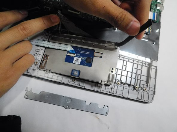

    • Remove the metal bracket.
  11. HP 15-dy2702dx Keyboard Replacement: crwdns2935265:011crwdnd2935265:01crwdnd2935265:03crwdne2935265:0 HP 15-dy2702dx Keyboard Replacement: crwdns2935265:011crwdnd2935265:02crwdnd2935265:03crwdne2935265:0 HP 15-dy2702dx Keyboard Replacement: crwdns2935265:011crwdnd2935265:03crwdnd2935265:03crwdne2935265:0
    • Lift the black ribbon covering the screws.
    • Unscrew the top three M2x3 Phillips #0 screws.
  12. HP 15-dy2702dx Keyboard Replacement: crwdns2935265:012crwdnd2935265:01crwdnd2935265:03crwdne2935265:0 HP 15-dy2702dx Keyboard Replacement: crwdns2935265:012crwdnd2935265:02crwdnd2935265:03crwdne2935265:0 HP 15-dy2702dx Keyboard Replacement: crwdns2935265:012crwdnd2935265:03crwdnd2935265:03crwdne2935265:0
    • Flip up the locking flap holding the trackpad ribbon in place.
    • Pull the ribbon straight out of its socket.

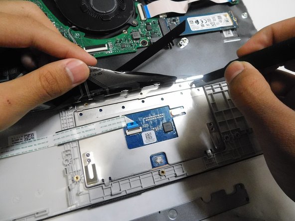

  13. HP 15-dy2702dx Keyboard Replacement: crwdns2935265:013crwdnd2935265:01crwdnd2935265:02crwdne2935265:0 HP 15-dy2702dx Keyboard Replacement: crwdns2935265:013crwdnd2935265:02crwdnd2935265:02crwdne2935265:0

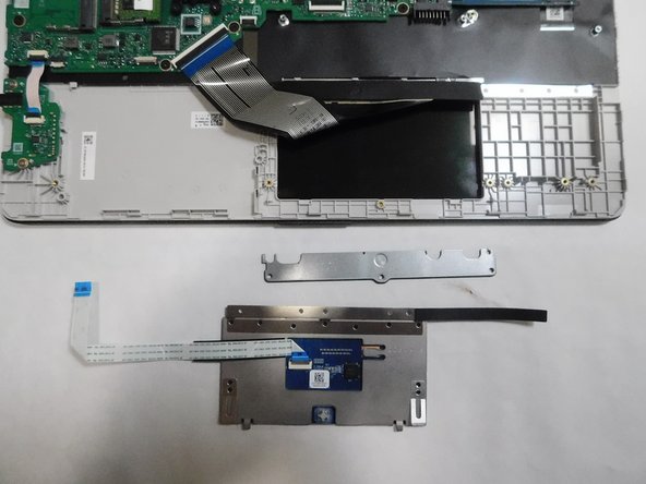

    • Peel back the sticky black strip holding the trackpad in place.
  14. HP 15-dy2702dx Keyboard Replacement: crwdns2935265:014crwdnd2935265:01crwdnd2935265:02crwdne2935265:0 HP 15-dy2702dx Keyboard Replacement: crwdns2935265:014crwdnd2935265:02crwdnd2935265:02crwdne2935265:0
    • Remove the trackpad from the laptop.

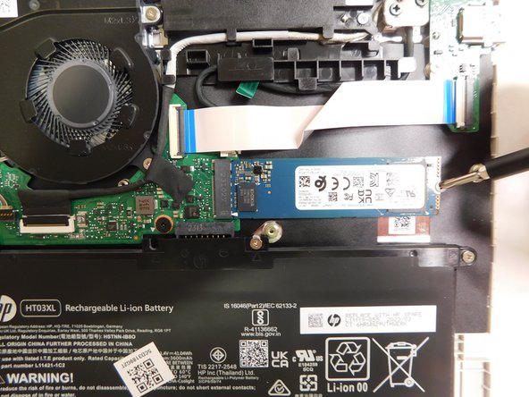

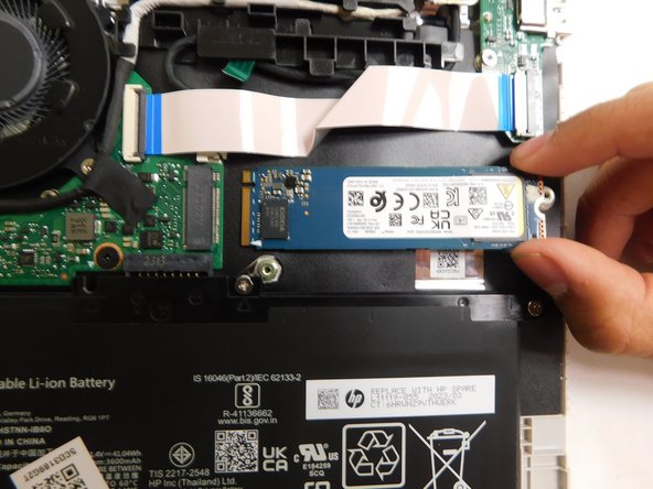

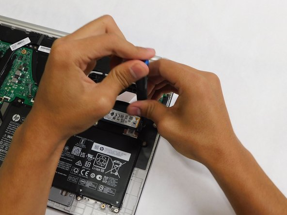

  15. HP 15-dy2702dx Keyboard Replacement, SSD: crwdns2935265:015crwdnd2935265:01crwdnd2935265:03crwdne2935265:0 HP 15-dy2702dx Keyboard Replacement, SSD: crwdns2935265:015crwdnd2935265:02crwdnd2935265:03crwdne2935265:0 HP 15-dy2702dx Keyboard Replacement, SSD: crwdns2935265:015crwdnd2935265:03crwdnd2935265:03crwdne2935265:0
    • Locate the storage drive.
    • Unscrew the single screw holding the drive in place.
    • The screw is a M2x3 mm Phillips #1 head screw.

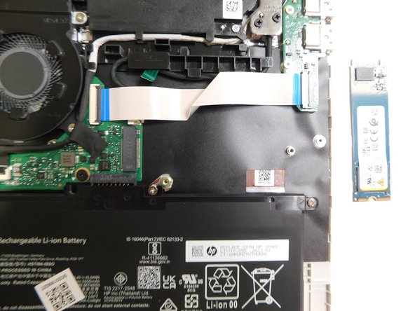

  16. HP 15-dy2702dx Keyboard Replacement: crwdns2935265:016crwdnd2935265:01crwdnd2935265:03crwdne2935265:0 HP 15-dy2702dx Keyboard Replacement: crwdns2935265:016crwdnd2935265:02crwdnd2935265:03crwdne2935265:0 HP 15-dy2702dx Keyboard Replacement: crwdns2935265:016crwdnd2935265:03crwdnd2935265:03crwdne2935265:0
    • Grab the drive by its side and gently pull it out.

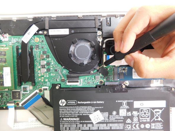

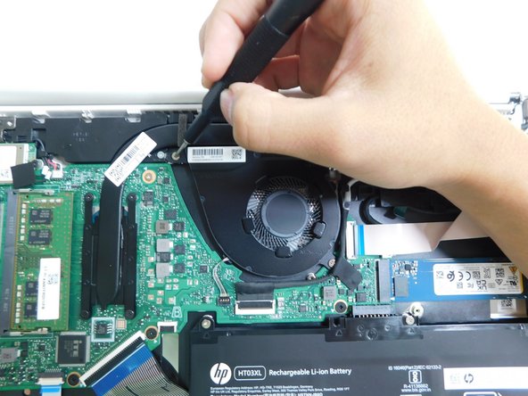

  17. HP 15-dy2702dx Keyboard Replacement, Fan: crwdns2935265:017crwdnd2935265:01crwdnd2935265:03crwdne2935265:0 HP 15-dy2702dx Keyboard Replacement, Fan: crwdns2935265:017crwdnd2935265:02crwdnd2935265:03crwdne2935265:0 HP 15-dy2702dx Keyboard Replacement, Fan: crwdns2935265:017crwdnd2935265:03crwdnd2935265:03crwdne2935265:0
    • Use a Phillips #1 screwdriver to unscrew the three screws that secure the fan.
    • These screws sizes are M2x6.
  18. HP 15-dy2702dx Keyboard Replacement: crwdns2935265:018crwdnd2935265:01crwdnd2935265:01crwdne2935265:0
    • Grip the cord that connects the fan to the motherboard and gently pull out to disconnect the cable from the connector.
    • Alternatively, we recommend using a tool to push the connector out of its socket to avoid damaging the wires.
  19. HP 15-dy2702dx Keyboard Replacement: crwdns2935265:019crwdnd2935265:01crwdnd2935265:02crwdne2935265:0 HP 15-dy2702dx Keyboard Replacement: crwdns2935265:019crwdnd2935265:02crwdnd2935265:02crwdne2935265:0
    • Gently lift the fan to remove it from the case.

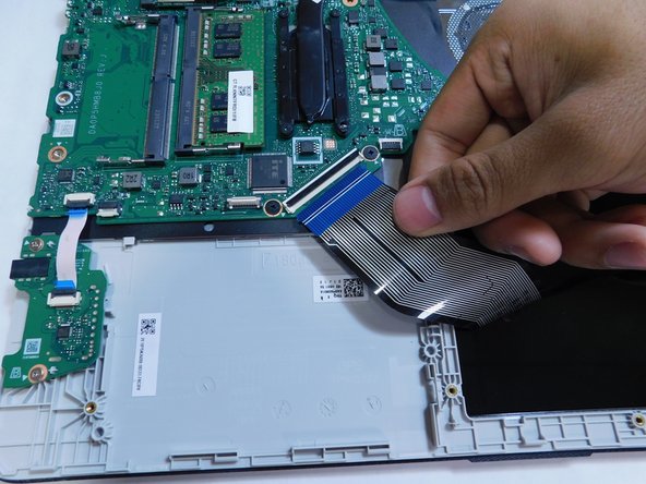

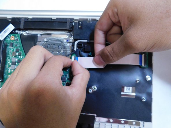

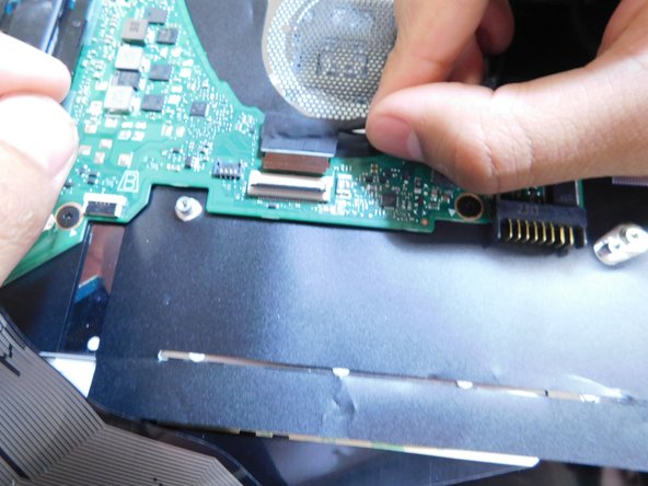

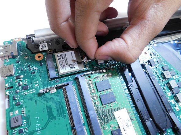

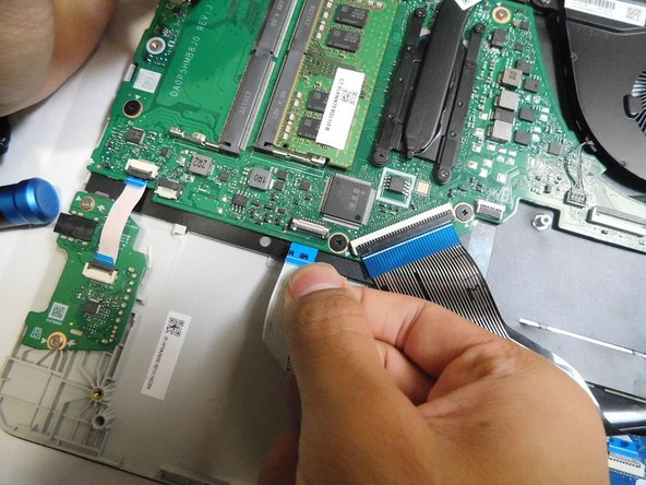

  20. HP 15-dy2702dx Keyboard Replacement, Keyboard Assembly: crwdns2935265:020crwdnd2935265:01crwdnd2935265:03crwdne2935265:0 HP 15-dy2702dx Keyboard Replacement, Keyboard Assembly: crwdns2935265:020crwdnd2935265:02crwdnd2935265:03crwdne2935265:0 HP 15-dy2702dx Keyboard Replacement, Keyboard Assembly: crwdns2935265:020crwdnd2935265:03crwdnd2935265:03crwdne2935265:0
    • Disconnect all the ribbon cables from the motherboard.
    • Ensure to flip up the locking flaps before attempting to pull the ribbon out.
  21. HP 15-dy2702dx Keyboard Replacement: crwdns2935265:021crwdnd2935265:01crwdnd2935265:02crwdne2935265:0 HP 15-dy2702dx Keyboard Replacement: crwdns2935265:021crwdnd2935265:02crwdnd2935265:02crwdne2935265:0
    • Continue disconnecting the ribbon cables.
  22. HP 15-dy2702dx Keyboard Replacement: crwdns2935265:022crwdnd2935265:01crwdnd2935265:02crwdne2935265:0 HP 15-dy2702dx Keyboard Replacement: crwdns2935265:022crwdnd2935265:02crwdnd2935265:02crwdne2935265:0
    • Continue disconnecting the remaining ribbons.
  23. HP 15-dy2702dx Keyboard Replacement: crwdns2935265:023crwdnd2935265:01crwdnd2935265:02crwdne2935265:0 HP 15-dy2702dx Keyboard Replacement: crwdns2935265:023crwdnd2935265:02crwdnd2935265:02crwdne2935265:0
    • Disconnect the connector.

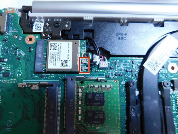

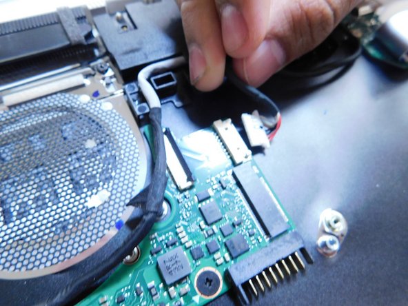

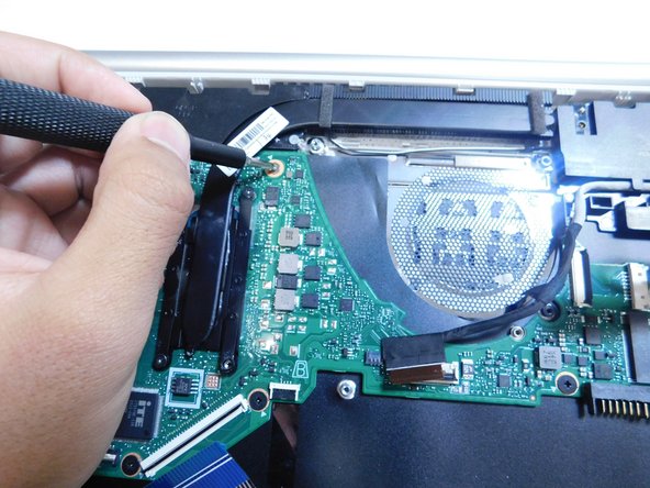

  24. HP 15-dy2702dx Keyboard Replacement: crwdns2935265:024crwdnd2935265:01crwdnd2935265:03crwdne2935265:0 HP 15-dy2702dx Keyboard Replacement: crwdns2935265:024crwdnd2935265:02crwdnd2935265:03crwdne2935265:0 HP 15-dy2702dx Keyboard Replacement: crwdns2935265:024crwdnd2935265:03crwdnd2935265:03crwdne2935265:0

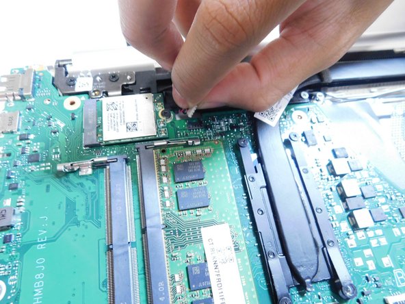

    • Peel off the black sticker covering the silver connectors near the top of the motherboard.
    • Remove the two silver colored round connector from the motherboard by pulling them up.
    • The connector should have a tag on them with number 1 and 2 on them.

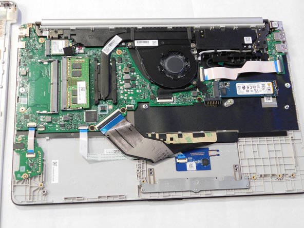

  25. HP 15-dy2702dx Keyboard Replacement: crwdns2935265:025crwdnd2935265:01crwdnd2935265:02crwdne2935265:0 HP 15-dy2702dx Keyboard Replacement: crwdns2935265:025crwdnd2935265:02crwdnd2935265:02crwdne2935265:0

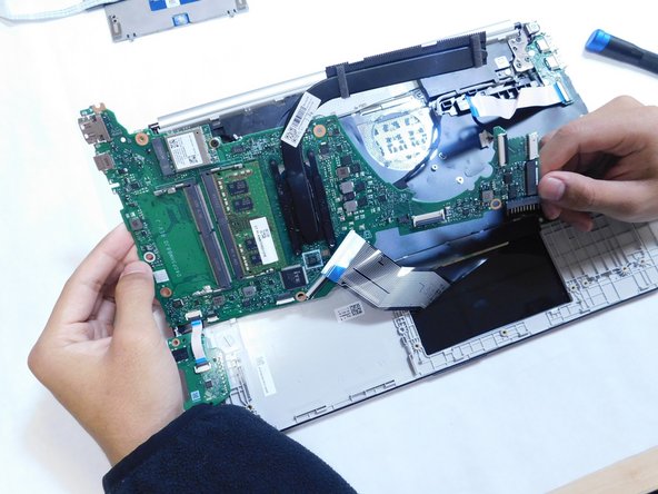

    • Pull up on the last connector on the motherboard next to the connectors removed in the previous step.

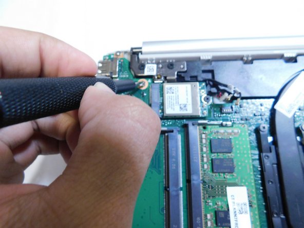

  26. HP 15-dy2702dx Keyboard Replacement: crwdns2935265:026crwdnd2935265:01crwdnd2935265:03crwdne2935265:0 HP 15-dy2702dx Keyboard Replacement: crwdns2935265:026crwdnd2935265:02crwdnd2935265:03crwdne2935265:0 HP 15-dy2702dx Keyboard Replacement: crwdns2935265:026crwdnd2935265:03crwdnd2935265:03crwdne2935265:0
    • Unscrew all M2x3 Phillips #1 screws holding the motherboard in place.
  27. HP 15-dy2702dx Keyboard Replacement: crwdns2935265:027crwdnd2935265:01crwdnd2935265:02crwdne2935265:0 HP 15-dy2702dx Keyboard Replacement: crwdns2935265:027crwdnd2935265:02crwdnd2935265:02crwdne2935265:0
    • Remove the motherboard from the case.

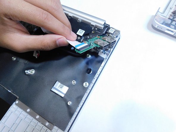

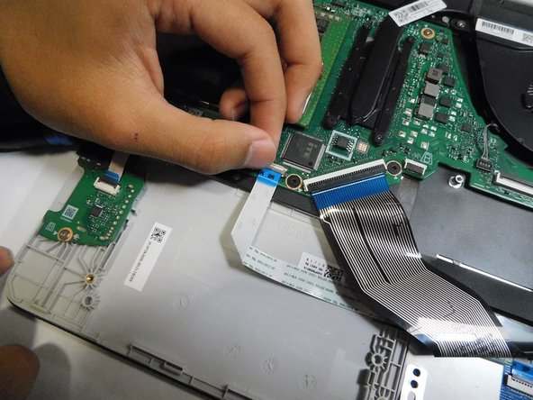

  28. HP 15-dy2702dx Keyboard Replacement: crwdns2935265:028crwdnd2935265:01crwdnd2935265:02crwdne2935265:0 HP 15-dy2702dx Keyboard Replacement: crwdns2935265:028crwdnd2935265:02crwdnd2935265:02crwdne2935265:0
    • Unscrew the two M2x3 Phillips #1 screws.
    • Remove the I/O board from the case.

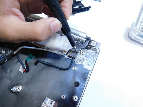

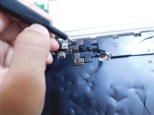

  29. HP 15-dy2702dx Keyboard Replacement: crwdns2935265:029crwdnd2935265:01crwdnd2935265:03crwdne2935265:0 HP 15-dy2702dx Keyboard Replacement: crwdns2935265:029crwdnd2935265:02crwdnd2935265:03crwdne2935265:0 HP 15-dy2702dx Keyboard Replacement: crwdns2935265:029crwdnd2935265:03crwdnd2935265:03crwdne2935265:0
    • Unscrew the three M2x6 Phillips #1 screws from the left metal hinge.
    • Lift the hinge.
  30. HP 15-dy2702dx Keyboard Replacement: crwdns2935265:030crwdnd2935265:01crwdnd2935265:02crwdne2935265:0 HP 15-dy2702dx Keyboard Replacement: crwdns2935265:030crwdnd2935265:02crwdnd2935265:02crwdne2935265:0
    • Unscrew the two Phillips #1 screws.
    • One is on the left side near where the fan was removed.
    • The other is near the right laptop metal hinge.

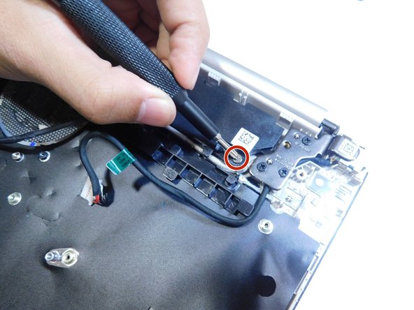

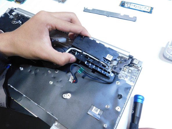

  31. HP 15-dy2702dx Keyboard Replacement: crwdns2935265:031crwdnd2935265:01crwdnd2935265:02crwdne2935265:0 HP 15-dy2702dx Keyboard Replacement: crwdns2935265:031crwdnd2935265:02crwdnd2935265:02crwdne2935265:0

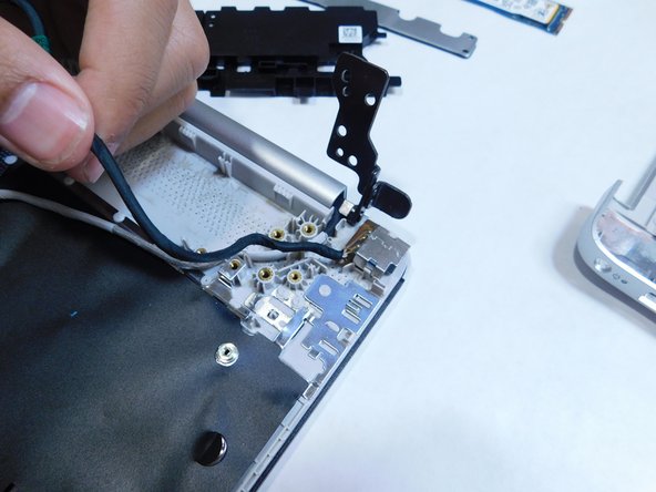

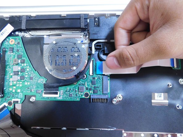

    • Remove the black boxes from the case.
    • Disconnect the power cable (white cable with a black flag at the end).
    • The black boxes is still connected to the case through a black wire, do not attempt to remove the wire.

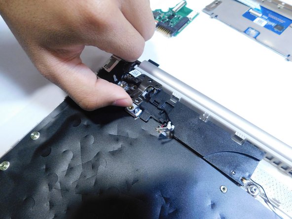

  32. HP 15-dy2702dx Keyboard Replacement: crwdns2935265:032crwdnd2935265:01crwdnd2935265:03crwdne2935265:0 HP 15-dy2702dx Keyboard Replacement: crwdns2935265:032crwdnd2935265:02crwdnd2935265:03crwdne2935265:0 HP 15-dy2702dx Keyboard Replacement: crwdns2935265:032crwdnd2935265:03crwdnd2935265:03crwdne2935265:0
    • Unscrew the three Philips head #1 screws on the right-side metal hinge.
    • Lift the hinge.
  33. HP 15-dy2702dx Keyboard Replacement: crwdns2935265:033crwdnd2935265:01crwdnd2935265:01crwdne2935265:0
    • Remove the DC in jack from the case by pulling it straight up.

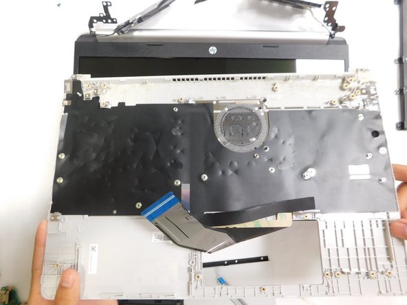

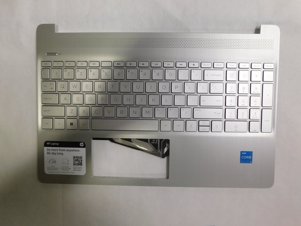

  34. HP 15-dy2702dx Keyboard Replacement: crwdns2935265:034crwdnd2935265:01crwdnd2935265:03crwdne2935265:0 HP 15-dy2702dx Keyboard Replacement: crwdns2935265:034crwdnd2935265:02crwdnd2935265:03crwdne2935265:0 HP 15-dy2702dx Keyboard Replacement: crwdns2935265:034crwdnd2935265:03crwdnd2935265:03crwdne2935265:0
    • Remove the keyboard from the laptop.
    • The keyboard is a type where it is directly integrated into the frame so you will need to replace the whole frame.
