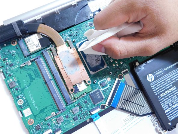

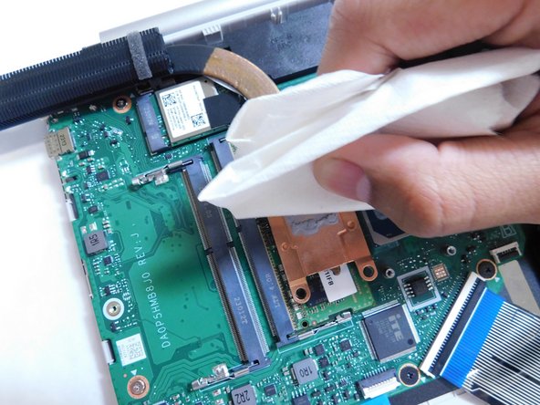

  6. HP 15-dy2702dx Heat Sink Replacement, Heat Sink: crwdns2935265:06crwdnd2935265:01crwdnd2935265:01crwdne2935265:0
    • Locate the heatsink.
  7. HP 15-dy2702dx Heat Sink Replacement: crwdns2935265:07crwdnd2935265:01crwdnd2935265:03crwdne2935265:0 HP 15-dy2702dx Heat Sink Replacement: crwdns2935265:07crwdnd2935265:02crwdnd2935265:03crwdne2935265:0 HP 15-dy2702dx Heat Sink Replacement: crwdns2935265:07crwdnd2935265:03crwdnd2935265:03crwdne2935265:0

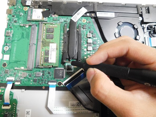

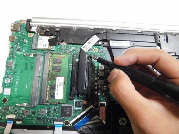

    • Remove the 4 M2x6 screws using a Phillips #0 screwdriver.
  8. HP 15-dy2702dx Heat Sink Replacement: crwdns2935265:08crwdnd2935265:01crwdnd2935265:02crwdne2935265:0 HP 15-dy2702dx Heat Sink Replacement: crwdns2935265:08crwdnd2935265:02crwdnd2935265:02crwdne2935265:0

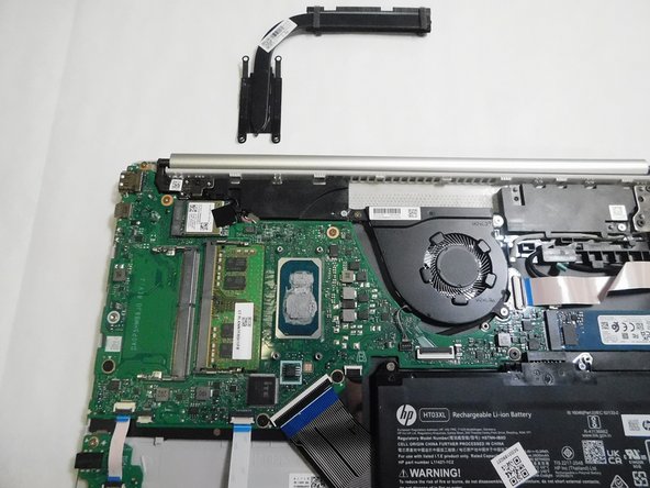

    • Gently lift and remove the heatsink.
