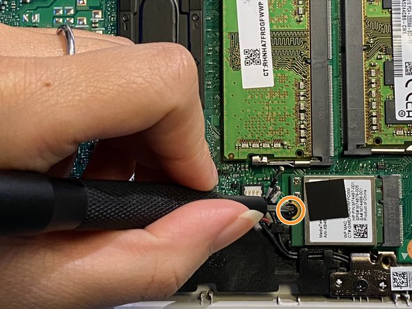

  4. HP 15-dy2024nr Wi-Fi Card Replacement, Wi-Fi Card: crwdns2935265:04crwdnd2935265:01crwdnd2935265:02crwdne2935265:0 HP 15-dy2024nr Wi-Fi Card Replacement, Wi-Fi Card: crwdns2935265:04crwdnd2935265:02crwdnd2935265:02crwdne2935265:0
    • You'll find the Wi-Fi card in the top left corner of the laptop.
    • Use a Phillips #1 screwdriver to remove a single 2 mm screw from the Wi-Fi card.
  5. HP 15-dy2024nr Wi-Fi Card Replacement: crwdns2935265:05crwdnd2935265:01crwdnd2935265:01crwdne2935265:0
    • Remove the Wi-Fi card from the black cartridge by grabbing each side and pulling with slight force.
