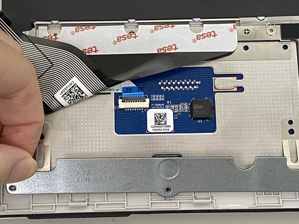

  6. HP 15-dy2024nr Trackpad Replacement, Trackpad: crwdns2935265:06crwdnd2935265:01crwdnd2935265:02crwdne2935265:0 HP 15-dy2024nr Trackpad Replacement, Trackpad: crwdns2935265:06crwdnd2935265:02crwdnd2935265:02crwdne2935265:0
    • Remove two 3.0 mm screws using a Phillips #1 screwdriver.
    • Lift the metal bracket away from the laptop and remove it with your hands.
  7. HP 15-dy2024nr Trackpad Replacement: crwdns2935265:07crwdnd2935265:01crwdnd2935265:01crwdne2935265:0
    • Remove three 2.0 mm screws using a Phillips #0 screwdriver.
  8. HP 15-dy2024nr Trackpad Replacement: crwdns2935265:08crwdnd2935265:01crwdnd2935265:01crwdne2935265:0
    • Lift the track pad away from the laptop and remove with your hands.
