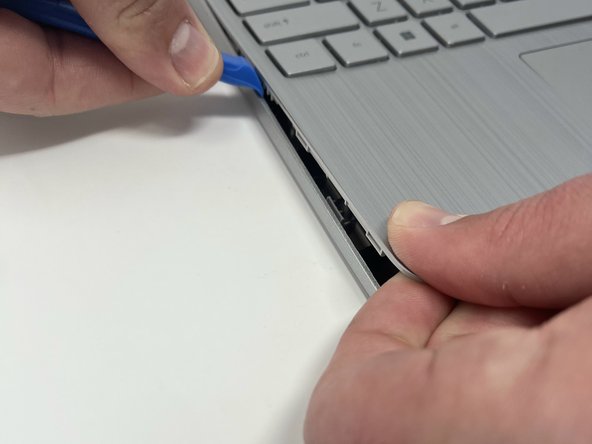

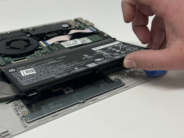

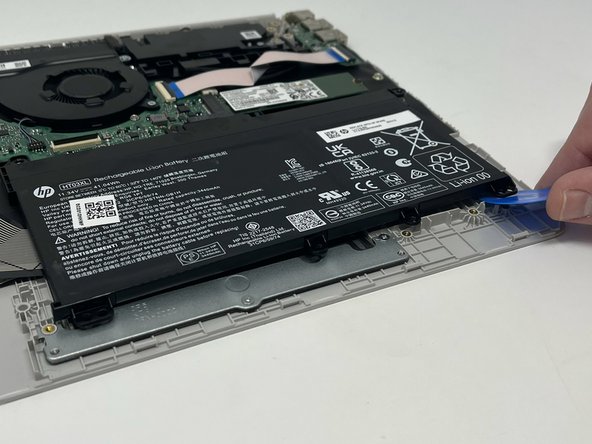

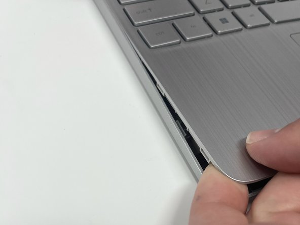

    • Insert an iFixit opening tool into the seam between the keyboard area and bottom cover.
    • Using another iFixit opening tool, slide along the seam to unhook the clips.
    • There are clips all the way around the seam. You may hear a popping sound as the clips come loose. This step may require some force to separate the back cover from the laptop.
    • When the front of the laptop is open, you can use your finger to hold a corner open then slide an iFixit opening tool along the seam toward the back corner.
    • After the clips have been released, flip the laptop over and lift the cover.

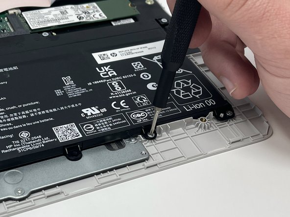

  4. HP 15-dy2024nr SSD Replacement, Battery: crwdns2935265:04crwdnd2935265:01crwdnd2935265:03crwdne2935265:0 HP 15-dy2024nr SSD Replacement, Battery: crwdns2935265:04crwdnd2935265:02crwdnd2935265:03crwdne2935265:0 HP 15-dy2024nr SSD Replacement, Battery: crwdns2935265:04crwdnd2935265:03crwdnd2935265:03crwdne2935265:0
    • Remove five 2.0mm x 3.0mm screws using a Phillips #00 screwdriver.
    • Use the iFixit opening picks to lift the battery away from the laptop.
  5. HP 15-dy2024nr SSD Replacement: crwdns2935265:05crwdnd2935265:01crwdnd2935265:03crwdne2935265:0 HP 15-dy2024nr SSD Replacement: crwdns2935265:05crwdnd2935265:02crwdnd2935265:03crwdne2935265:0 HP 15-dy2024nr SSD Replacement: crwdns2935265:05crwdnd2935265:03crwdnd2935265:03crwdne2935265:0
    • Be aware that the battery is plugged into the motherboard.
    • Unplug the battery from the motherboard.
    • Lift the battery away from the laptop and remove.

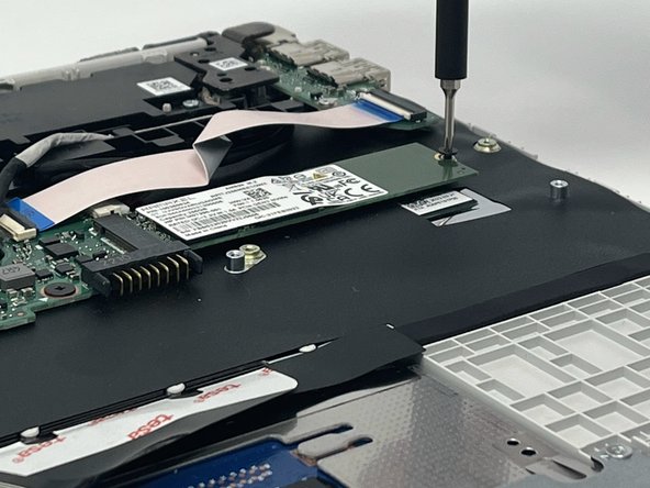

  6. HP 15-dy2024nr SSD Replacement, SSD: crwdns2935265:06crwdnd2935265:01crwdnd2935265:02crwdne2935265:0 HP 15-dy2024nr SSD Replacement, SSD: crwdns2935265:06crwdnd2935265:02crwdnd2935265:02crwdne2935265:0
    • Remove the single 2 mm screw from the hard drive using a Phillips #00 screwdriver.
  7. HP 15-dy2024nr SSD Replacement: crwdns2935265:07crwdnd2935265:01crwdnd2935265:02crwdne2935265:0 HP 15-dy2024nr SSD Replacement: crwdns2935265:07crwdnd2935265:02crwdnd2935265:02crwdne2935265:0
    • Pull the SSD away from the connector, while gently lifting it out using your hands.
