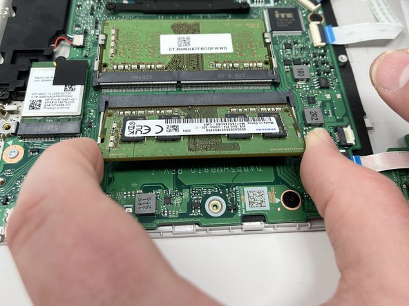

  6. HP 15-dy2024nr RAM Replacement, RAM: crwdns2935265:06crwdnd2935265:01crwdnd2935265:03crwdne2935265:0 HP 15-dy2024nr RAM Replacement, RAM: crwdns2935265:06crwdnd2935265:02crwdnd2935265:03crwdne2935265:0 HP 15-dy2024nr RAM Replacement, RAM: crwdns2935265:06crwdnd2935265:03crwdnd2935265:03crwdne2935265:0
    • Pull the clips on either side of the RAM in opposite directions until the RAM pops up at a 45 degree angle.
    • Pull the RAM out and replace it.
    • If your RAM just needs to be re-seated, unplug it and plug it back in. Be sure that it is plugged in straight.
