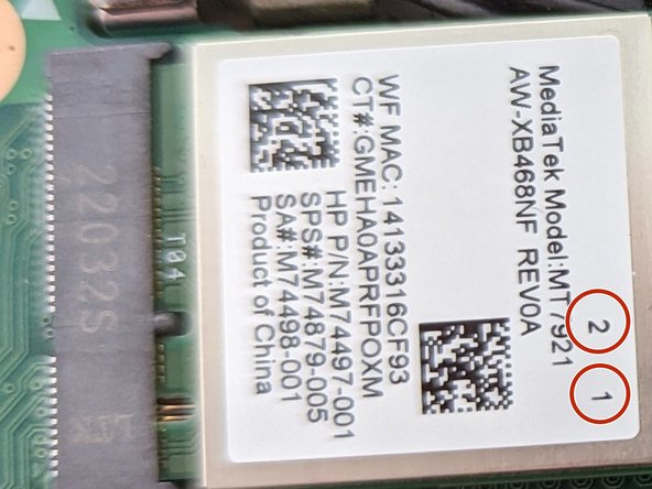

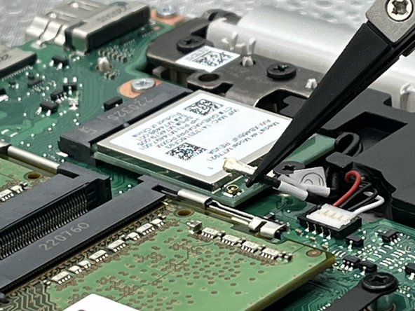

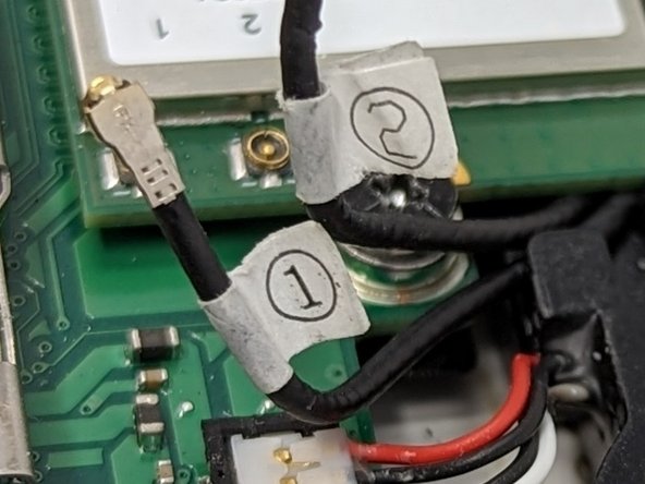

  9. HP 15-dy2024nr Motherboard Replacement: crwdns2935265:09crwdnd2935265:01crwdnd2935265:03crwdne2935265:0 HP 15-dy2024nr Motherboard Replacement: crwdns2935265:09crwdnd2935265:02crwdnd2935265:03crwdne2935265:0 HP 15-dy2024nr Motherboard Replacement: crwdns2935265:09crwdnd2935265:03crwdnd2935265:03crwdne2935265:0

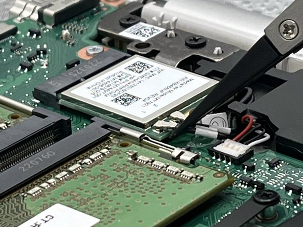

    • Locate the WLAN module near the left display hinge.
    • Use the blade end of the spudger to remove the black square sticker covering the WLAN cables.
    • Note the number labels of each antenna cable and the numbers on the WLAN module antenna connectors. This detail will be important later during the reassembly of the laptop.
  10. HP 15-dy2024nr Motherboard Replacement: crwdns2935265:010crwdnd2935265:01crwdnd2935265:03crwdne2935265:0 HP 15-dy2024nr Motherboard Replacement: crwdns2935265:010crwdnd2935265:02crwdnd2935265:03crwdne2935265:0 HP 15-dy2024nr Motherboard Replacement: crwdns2935265:010crwdnd2935265:03crwdnd2935265:03crwdne2935265:0
    • Remove the two WLAN antennas from the WLAN module using the nylon reverse tweezers.
    • Only grasp the antenna cables from the connector ends; do not pull on the cable.
    • The solder points for these connectors on the WLAN module are fragile and can easily break.
    • These antennas are clipped into the WLAN module using a similar mechanism to a denim snap button. Pulling the connector off at a slight angle will be more effective than pulling it straight up.

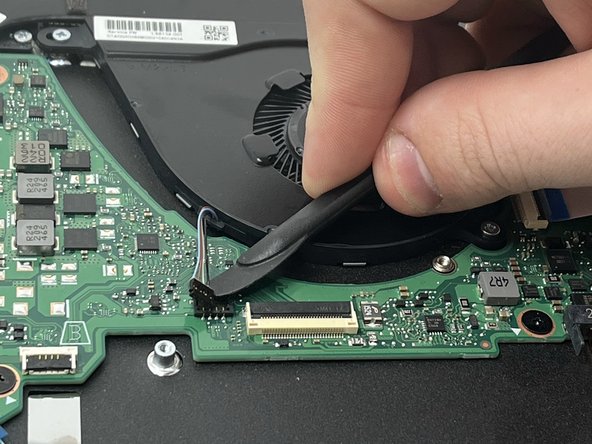

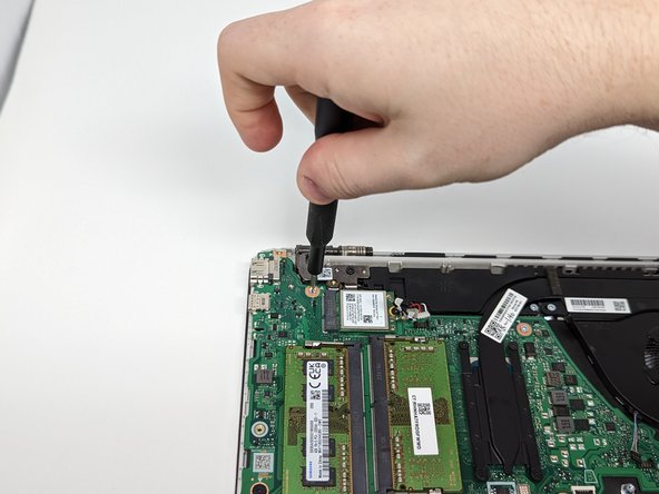

  11. HP 15-dy2024nr Motherboard Replacement: crwdns2935265:011crwdnd2935265:01crwdnd2935265:02crwdne2935265:0 HP 15-dy2024nr Motherboard Replacement: crwdns2935265:011crwdnd2935265:02crwdnd2935265:02crwdne2935265:0
    • Use the nylon tipped reverse tweezers to lift the speaker cables up.
    • Do not use the tweezers to pull the cable out.
    • User the blade end of the spudger to pry the speaker connector up from between the connector and the motherboard.

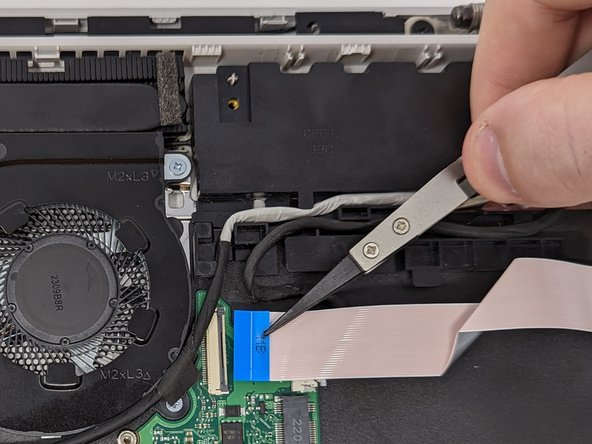

  12. HP 15-dy2024nr Motherboard Replacement: crwdns2935265:012crwdnd2935265:01crwdnd2935265:02crwdne2935265:0 HP 15-dy2024nr Motherboard Replacement: crwdns2935265:012crwdnd2935265:02crwdnd2935265:02crwdne2935265:0
    • Use the blade end of the spudger to lift the black retaining clip.
    • Use the nylon tipped reverse tweezers to grip the blue tab on the ribbon cable and pull it gently out of the socket.
    • After the cable is out of the socket, move the cable out of the way to get to the power connector underneath.
    • Be careful not to fold or bend the ribbon cable too severely.

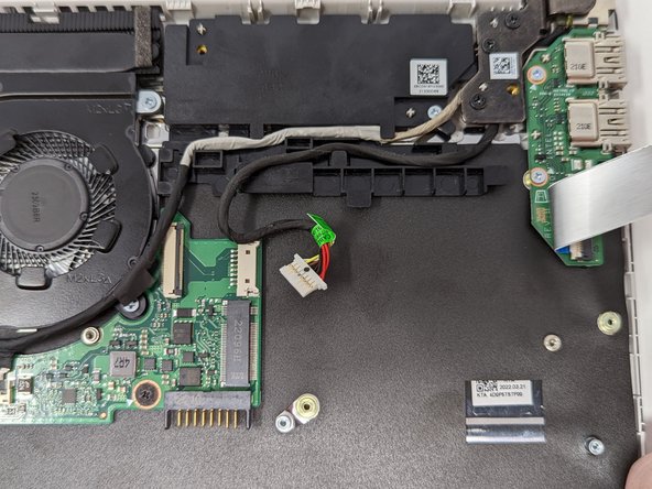

  13. HP 15-dy2024nr Motherboard Replacement: crwdns2935265:013crwdnd2935265:01crwdnd2935265:02crwdne2935265:0 HP 15-dy2024nr Motherboard Replacement: crwdns2935265:013crwdnd2935265:02crwdnd2935265:02crwdne2935265:0
    • Grasp the power cable firmly and lightly tug on the cable. You may need to grab the connector end and wiggle it out of the socket.
    • Be sure to grasp all of the cables bundled together or the connector end itself; do not tug on one wire at a time.

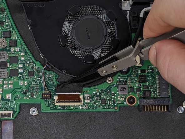

  14. HP 15-dy2024nr Motherboard Replacement: crwdns2935265:014crwdnd2935265:01crwdnd2935265:03crwdne2935265:0 HP 15-dy2024nr Motherboard Replacement: crwdns2935265:014crwdnd2935265:02crwdnd2935265:03crwdne2935265:0 HP 15-dy2024nr Motherboard Replacement: crwdns2935265:014crwdnd2935265:03crwdnd2935265:03crwdne2935265:0
    • Ue the nylon tipped reverse tweezers to grip the black ribbon cable and pull it gently out of the socket.
    • Avoid folding or bending the ribbon cable too severely.

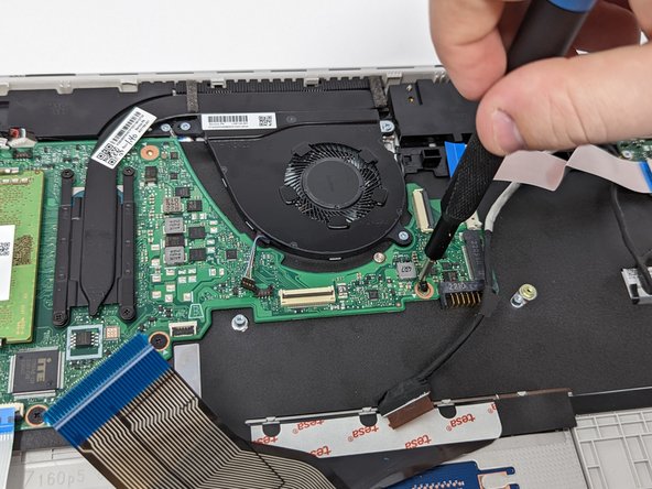

  15. HP 15-dy2024nr Motherboard Replacement: crwdns2935265:015crwdnd2935265:01crwdnd2935265:03crwdne2935265:0 HP 15-dy2024nr Motherboard Replacement: crwdns2935265:015crwdnd2935265:02crwdnd2935265:03crwdne2935265:0 HP 15-dy2024nr Motherboard Replacement: crwdns2935265:015crwdnd2935265:03crwdnd2935265:03crwdne2935265:0
    Halberd Spudger
    $2.99

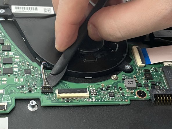

    • Use the nylon tipped reverse tweezers to lift the cables up from off the motherboard.
    • Do not use the tweezers to pull the cables off the motherboard.
    • User the knife end of the Halberd spudger to wedge between the black plastic connector and the motherboard. Lightly twist the spudger blade up. The connector should pop off.

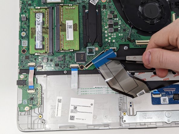

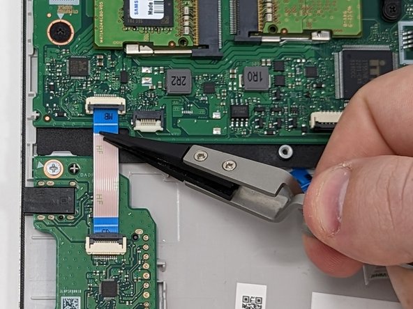

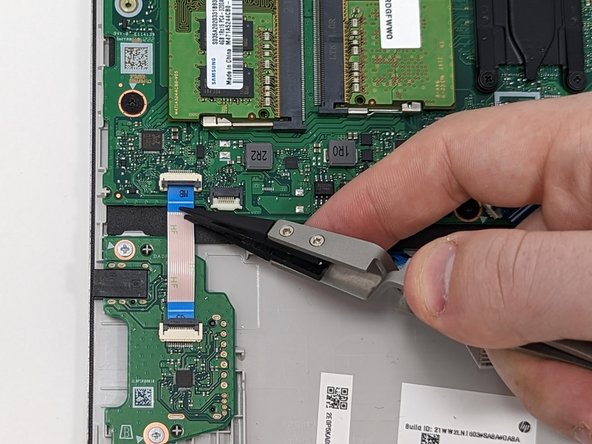

  16. HP 15-dy2024nr Motherboard Replacement: crwdns2935265:016crwdnd2935265:01crwdnd2935265:03crwdne2935265:0 HP 15-dy2024nr Motherboard Replacement: crwdns2935265:016crwdnd2935265:02crwdnd2935265:03crwdne2935265:0 HP 15-dy2024nr Motherboard Replacement: crwdns2935265:016crwdnd2935265:03crwdnd2935265:03crwdne2935265:0
    • Use the nylon-tipped reverse tweezers to grip the blue tab on the ribbon cable and pull it gently out of the socket.

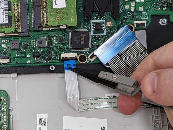

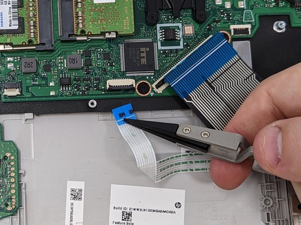

  17. HP 15-dy2024nr Motherboard Replacement: crwdns2935265:017crwdnd2935265:01crwdnd2935265:03crwdne2935265:0 HP 15-dy2024nr Motherboard Replacement: crwdns2935265:017crwdnd2935265:02crwdnd2935265:03crwdne2935265:0 HP 15-dy2024nr Motherboard Replacement: crwdns2935265:017crwdnd2935265:03crwdnd2935265:03crwdne2935265:0

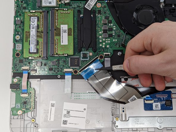

  18. HP 15-dy2024nr Motherboard Replacement: crwdns2935265:018crwdnd2935265:01crwdnd2935265:03crwdne2935265:0 HP 15-dy2024nr Motherboard Replacement: crwdns2935265:018crwdnd2935265:02crwdnd2935265:03crwdne2935265:0 HP 15-dy2024nr Motherboard Replacement: crwdns2935265:018crwdnd2935265:03crwdnd2935265:03crwdne2935265:0

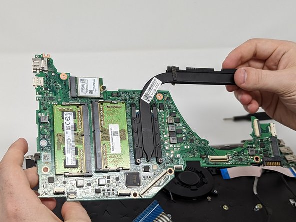

  20. HP 15-dy2024nr Motherboard Replacement: crwdns2935265:020crwdnd2935265:01crwdnd2935265:02crwdne2935265:0 HP 15-dy2024nr Motherboard Replacement: crwdns2935265:020crwdnd2935265:02crwdnd2935265:02crwdne2935265:0
    • Grasp the motherboard by the edges. Lift the motherboard out of the laptop.
    • Be sure not to let any cables get caught on the motherboard as you lift if out of the laptop.
    • The cooling pipe and heatsink will come off with the motherboard. It will slide out from the back of the laptop by the hinge.
