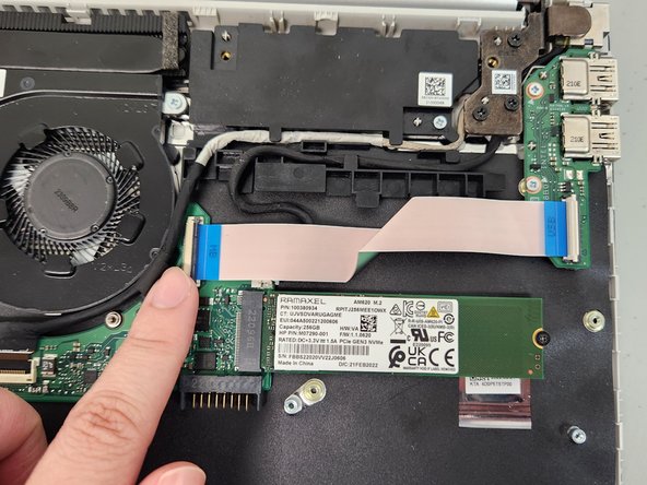

  4. HP 15-dy2024nr I/O Board Replacement, I/O Board: crwdns2935265:04crwdnd2935265:01crwdnd2935265:03crwdne2935265:0 HP 15-dy2024nr I/O Board Replacement, I/O Board: crwdns2935265:04crwdnd2935265:02crwdnd2935265:03crwdne2935265:0 HP 15-dy2024nr I/O Board Replacement, I/O Board: crwdns2935265:04crwdnd2935265:03crwdnd2935265:03crwdne2935265:0
    • Flip up the black plastic tab holding the USB power connector to the motherboard using your hands.
    • Pull the USB cable away from the motherboard.

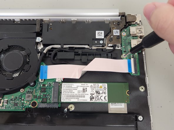

  5. HP 15-dy2024nr I/O Board Replacement: crwdns2935265:05crwdnd2935265:01crwdnd2935265:02crwdne2935265:0 HP 15-dy2024nr I/O Board Replacement: crwdns2935265:05crwdnd2935265:02crwdnd2935265:02crwdne2935265:0
    • Remove the two 2.0 mm screws using a Phillips #1 screwdriver.

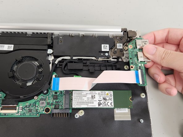

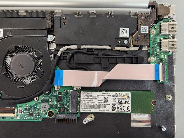

  6. HP 15-dy2024nr I/O Board Replacement: crwdns2935265:06crwdnd2935265:01crwdnd2935265:02crwdne2935265:0 HP 15-dy2024nr I/O Board Replacement: crwdns2935265:06crwdnd2935265:02crwdnd2935265:02crwdne2935265:0
    • Lift the I/O board up then away from the laptop.
