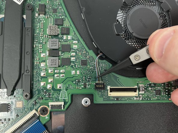

    • If your fan needs to be cleaned, do that now. If it is not working properly, continue with these steps to remove the broken fan.
    • Use the nylon tipped reverse tweezers to lift the cables up from off the motherboard before attempting to disconnect the connector from the motherboard.
    • Do not use the tweezers to pull the cables off the motherboard.
  7. HP 15-dy2024nr Fan Assembly Replacement: crwdns2935265:07crwdnd2935265:01crwdnd2935265:02crwdne2935265:0 HP 15-dy2024nr Fan Assembly Replacement: crwdns2935265:07crwdnd2935265:02crwdnd2935265:02crwdne2935265:0

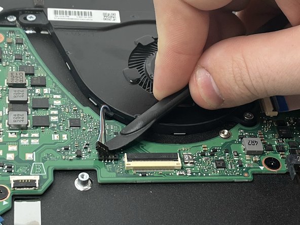

    Halberd Spudger
    $2.99
    • Wedge the Halberd spudger between the black plastic connector and the motherboard.
    • Lightly twist the spudger blade up. The connector should pop off.

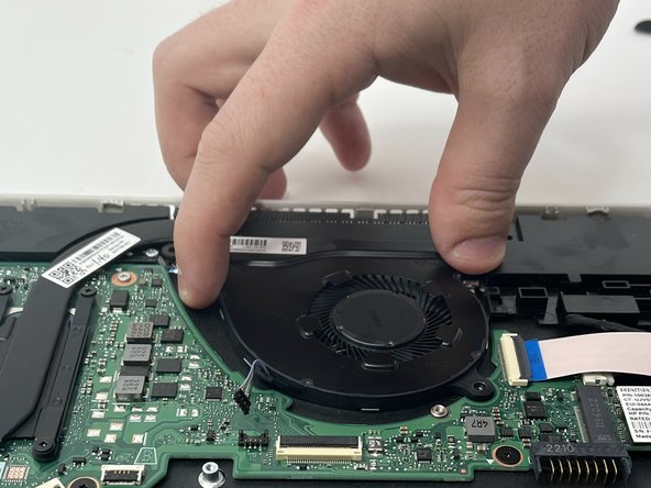

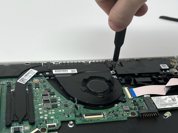

    • Remove the three chrome-plated 2.0mm x 3.0mm screws holding the fan assembly in place using a Phillips #0 screwdriver.
    • Lift the fan assembly out of the laptop.
