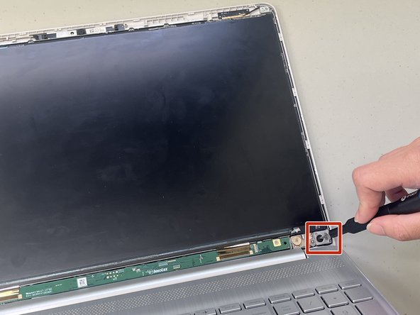

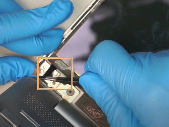

    • Remove the 1.8 mm screws from the top and bottom corners of the screen using a Phillips #1 screwdriver.
    • Use a pair of tweezers to pull out the adhesive tape from the bottom left and right corners of the screen.

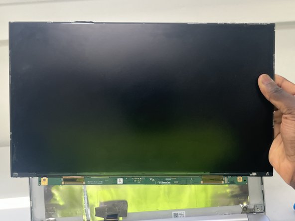

    • Remove the LCD and gently place it on the keyboard with both hands.
  4. HP 15-dy2024nr Display Assembly Replacement: crwdns2935265:04crwdnd2935265:01crwdnd2935265:03crwdne2935265:0 HP 15-dy2024nr Display Assembly Replacement: crwdns2935265:04crwdnd2935265:02crwdnd2935265:03crwdne2935265:0 HP 15-dy2024nr Display Assembly Replacement: crwdns2935265:04crwdnd2935265:03crwdnd2935265:03crwdne2935265:0

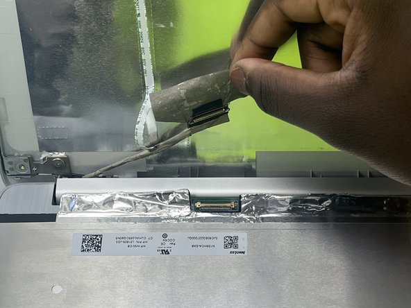

    • Gently peel off the tape securing the video connector.
    • Disconnect the video cable.
    • Remove the old screen.
