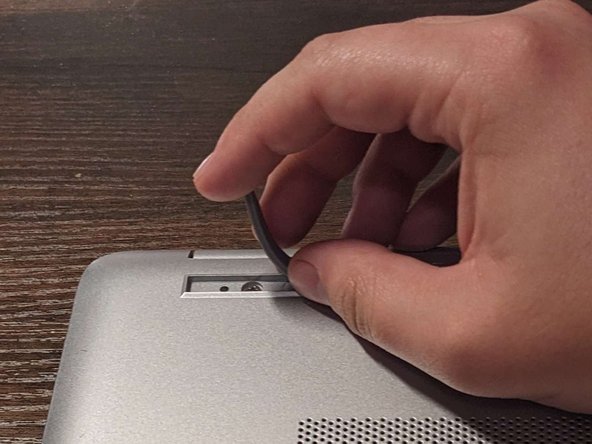

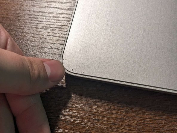

    • Close the screen and flip the laptop over so the backside is facing up.
    • Using a Phillips screwdriver, remove the left and right corner screws.

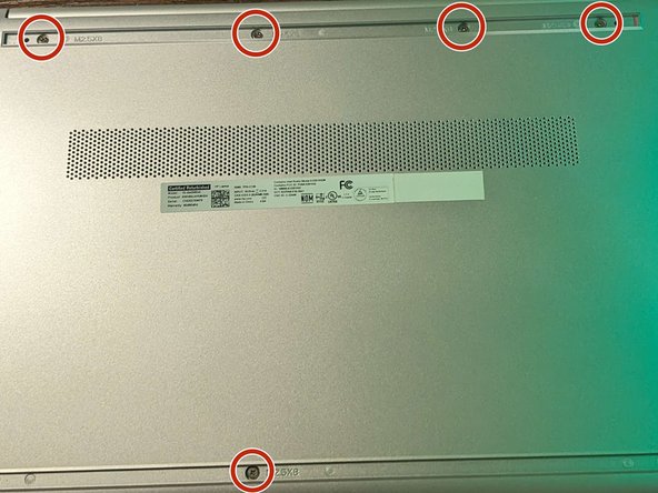

    • Use a spudger or your fingers to remove the protective padding from the top and bottom of the base and expose the screws.
    • With a Phillips screwdriver, remove the five screws from the base.

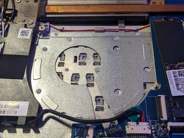

    • Open the screen.
    • Use a spudger to pry the palm rest assembly from the laptop.
    • Work the spudger around the perimeter to release the clips that secure the palm rest assembly.
    • Remove the palm rest assembly carefully as there are ribbon cables attached on the other side.

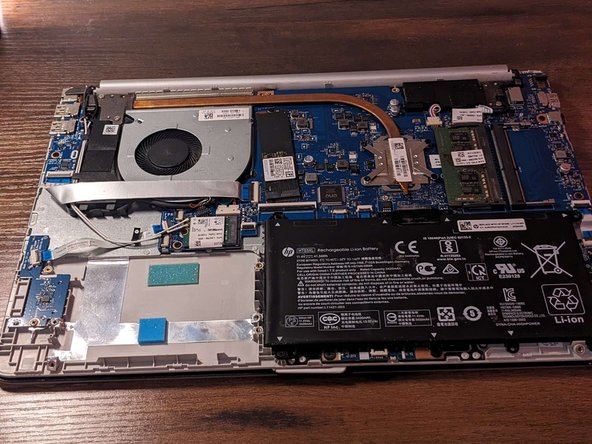

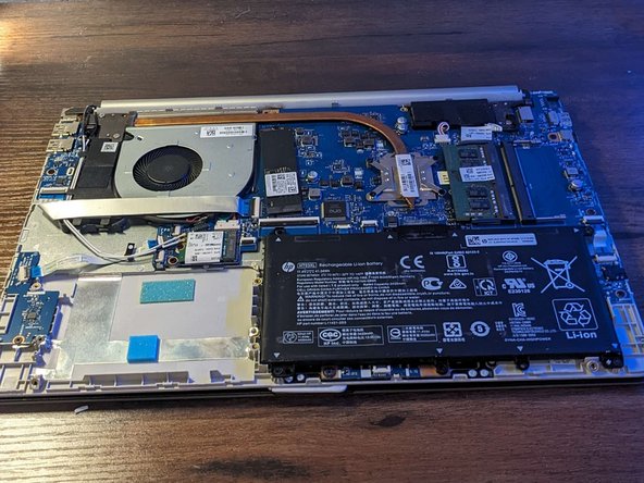

  5. HP 15-dw2065st Fan Replacement: crwdns2935265:05crwdnd2935265:01crwdnd2935265:02crwdne2935265:0 HP 15-dw2065st Fan Replacement: crwdns2935265:05crwdnd2935265:02crwdnd2935265:02crwdne2935265:0
    • With a Phillips screwdriver, remove the four screws securing the battery.
    • Remove the battery from the connector.

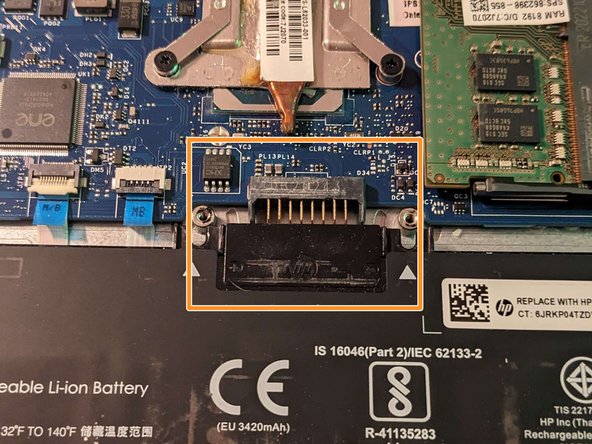

  6. HP 15-dw2065st Fan Replacement: crwdns2935265:06crwdnd2935265:01crwdnd2935265:01crwdne2935265:0
    • Use a spudger to lift the black locking flap.
    • Remove the ribbon cable.

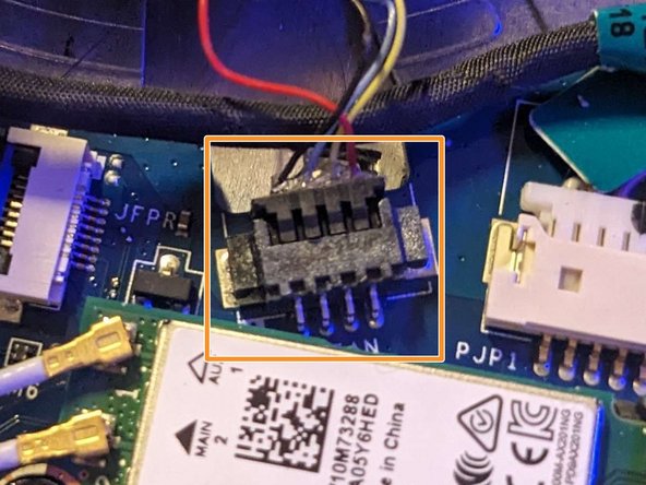

  7. HP 15-dw2065st Fan Replacement: crwdns2935265:07crwdnd2935265:01crwdnd2935265:03crwdne2935265:0 HP 15-dw2065st Fan Replacement: crwdns2935265:07crwdnd2935265:02crwdnd2935265:03crwdne2935265:0 HP 15-dw2065st Fan Replacement: crwdns2935265:07crwdnd2935265:03crwdnd2935265:03crwdne2935265:0
    • Remove the black screw from the fan.
    • Pull the cable away from the connector in the same direction that the individual wires are running
    • Pull evenly on the full width of the cable so that no individual wires are overly strained.
    • Remove the fan.
