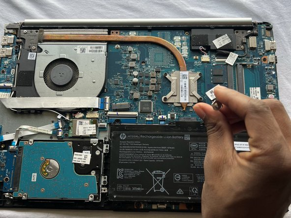

    • Remove the three screws around the battery using a Phillips #00 screwdriver.
  4. HP 15-dw0xxx Battery Replacement: crwdns2935265:04crwdnd2935265:01crwdnd2935265:01crwdne2935265:0
    • Slowly use your two hands to take the current battery out.
