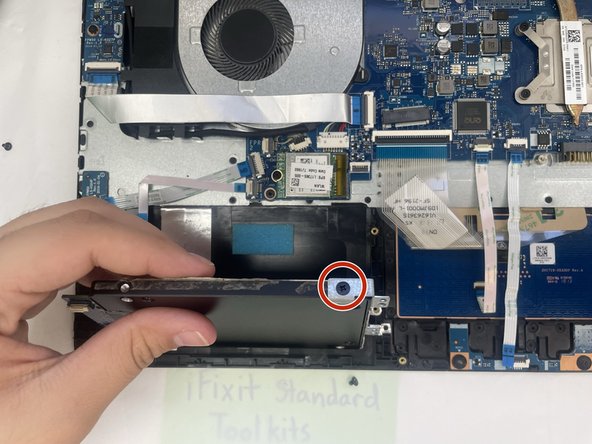

  6. HP 15-dw0037wm Hard Drive Replacement: crwdns2935265:06crwdnd2935265:01crwdnd2935265:02crwdne2935265:0 HP 15-dw0037wm Hard Drive Replacement: crwdns2935265:06crwdnd2935265:02crwdnd2935265:02crwdne2935265:0
    • Lift up the hard drive.
    • Remove the single 4 mm screw that secures the metal bracket to the hard drive.
    • The one screw for this one is thicker than the others, 3 mm compared to 2 mm.

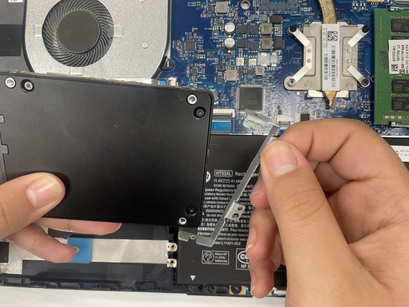

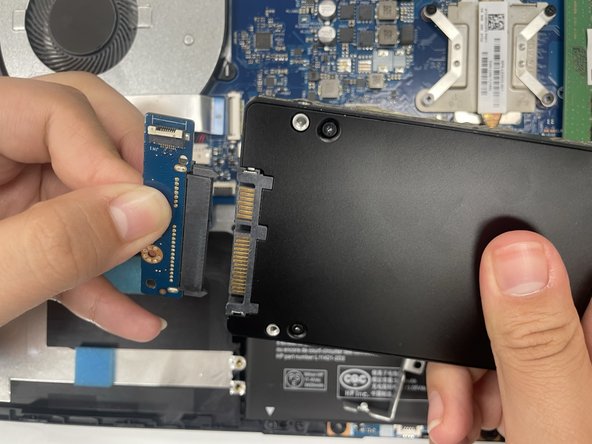

  7. HP 15-dw0037wm Hard Drive Replacement: crwdns2935265:07crwdnd2935265:01crwdnd2935265:03crwdne2935265:0 HP 15-dw0037wm Hard Drive Replacement: crwdns2935265:07crwdnd2935265:02crwdnd2935265:03crwdne2935265:0 HP 15-dw0037wm Hard Drive Replacement: crwdns2935265:07crwdnd2935265:03crwdnd2935265:03crwdne2935265:0
    • Pull the metal bracket down slightly and pull to the side.
    • Gently grab the board and pull it to the side.
    • Don't pull down to remove the chip as it can badly damage the port.
