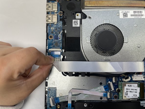

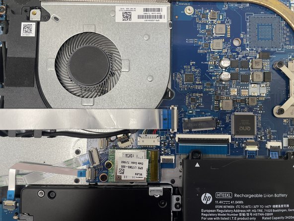

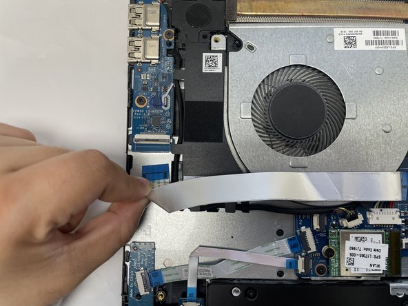

  6. HP 15-dw0037wm Fan Replacement, Fan: crwdns2935265:06crwdnd2935265:01crwdnd2935265:03crwdne2935265:0 HP 15-dw0037wm Fan Replacement, Fan: crwdns2935265:06crwdnd2935265:02crwdnd2935265:03crwdne2935265:0 HP 15-dw0037wm Fan Replacement, Fan: crwdns2935265:06crwdnd2935265:03crwdnd2935265:03crwdne2935265:0
    • Use your fingernail or a spudger to gently lift the black ZIF locking flap that secures the ribbon cable.
    • Repeat the previous bullet on the other end of the ribbon cable.

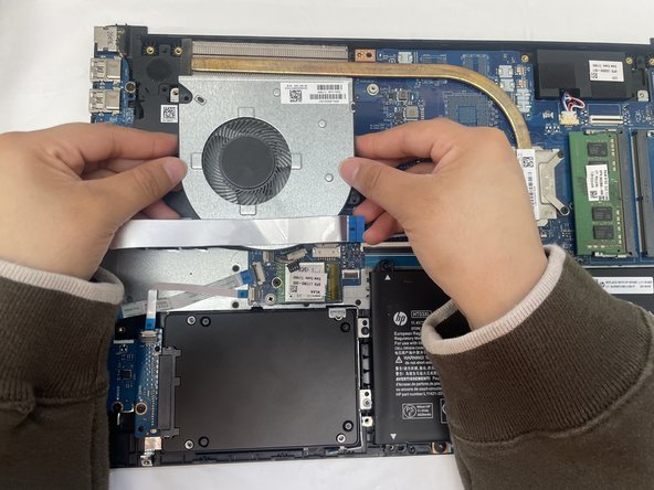

  7. HP 15-dw0037wm Fan Replacement: crwdns2935265:07crwdnd2935265:01crwdnd2935265:02crwdne2935265:0 HP 15-dw0037wm Fan Replacement: crwdns2935265:07crwdnd2935265:02crwdnd2935265:02crwdne2935265:0
    • Slide the ribbon cable out from the socket gently.
    • Repeat on the other end of the ribbon cable.

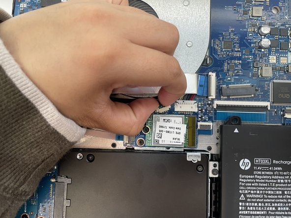

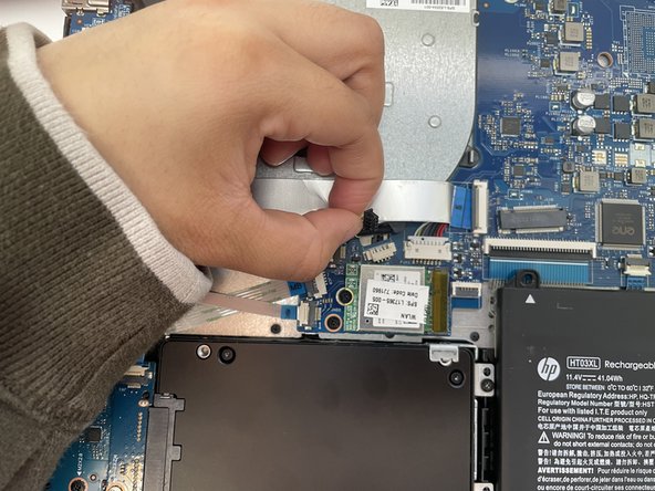

  8. HP 15-dw0037wm Fan Replacement: crwdns2935265:08crwdnd2935265:01crwdnd2935265:03crwdne2935265:0 HP 15-dw0037wm Fan Replacement: crwdns2935265:08crwdnd2935265:02crwdnd2935265:03crwdne2935265:0 HP 15-dw0037wm Fan Replacement: crwdns2935265:08crwdnd2935265:03crwdnd2935265:03crwdne2935265:0
    • Gently using your fingernails to push the fan connector out of its motherboard socket.

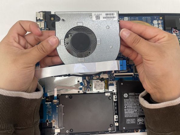

  10. HP 15-dw0037wm Fan Replacement: crwdns2935265:010crwdnd2935265:01crwdnd2935265:03crwdne2935265:0 HP 15-dw0037wm Fan Replacement: crwdns2935265:010crwdnd2935265:02crwdnd2935265:03crwdne2935265:0 HP 15-dw0037wm Fan Replacement: crwdns2935265:010crwdnd2935265:03crwdnd2935265:03crwdne2935265:0
    • Grip and lift the fan up and out of the chassis.
