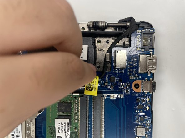

  4. HP 15-dw0037wm Display Assembly Replacement, Display Assembly: crwdns2935265:04crwdnd2935265:01crwdnd2935265:03crwdne2935265:0 HP 15-dw0037wm Display Assembly Replacement, Display Assembly: crwdns2935265:04crwdnd2935265:02crwdnd2935265:03crwdne2935265:0 HP 15-dw0037wm Display Assembly Replacement, Display Assembly: crwdns2935265:04crwdnd2935265:03crwdnd2935265:03crwdne2935265:0
    • Detach the coaxial connector by grabbing it securely from the gold colored metal section and gently lifting upwards.
    • Don't tug on it from the white end or towards the side. It is likely to get damaged.

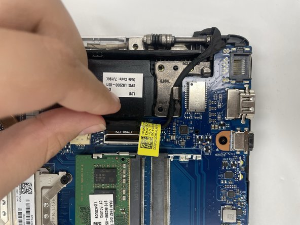

  6. HP 15-dw0037wm Display Assembly Replacement: crwdns2935265:06crwdnd2935265:01crwdnd2935265:03crwdne2935265:0 HP 15-dw0037wm Display Assembly Replacement: crwdns2935265:06crwdnd2935265:02crwdnd2935265:03crwdne2935265:0 HP 15-dw0037wm Display Assembly Replacement: crwdns2935265:06crwdnd2935265:03crwdnd2935265:03crwdne2935265:0
    • Flip up the black locking flap on the ZIF connector.
    • Disconnect the display cable.
