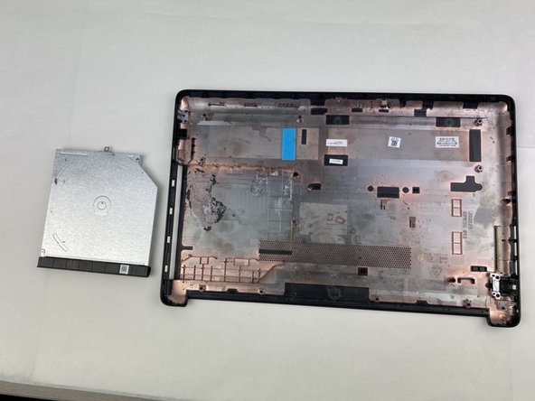

    • Make sure the disc drive is clear of any discs.
    • Remove the rubber stays from the bottom of the device.
    • Using a Phillips #0 screwdriver, remove the eleven screws on the back cover.
  2. HP 15-db0015dx Optical Drive Replacement: crwdns2935265:02crwdnd2935265:01crwdnd2935265:03crwdne2935265:0 HP 15-db0015dx Optical Drive Replacement: crwdns2935265:02crwdnd2935265:02crwdnd2935265:03crwdne2935265:0 HP 15-db0015dx Optical Drive Replacement: crwdns2935265:02crwdnd2935265:03crwdnd2935265:03crwdne2935265:0
    • Use a spudger to pry open the back cover.
    • The disk drive must be disconnected by pulling it to the left before removing the back panel.
  3. HP 15-db0015dx Optical Drive Replacement: crwdns2935265:03crwdnd2935265:01crwdnd2935265:03crwdne2935265:0 HP 15-db0015dx Optical Drive Replacement: crwdns2935265:03crwdnd2935265:02crwdnd2935265:03crwdne2935265:0 HP 15-db0015dx Optical Drive Replacement: crwdns2935265:03crwdnd2935265:03crwdnd2935265:03crwdne2935265:0
    • Slide the disk drive to the left and remove.
